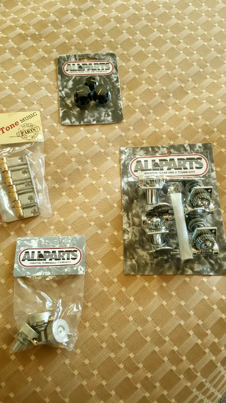

    Real Parts parcel has arrived. I like the tuners...love the knobs...the bridge is a little different.
    Come on PBG....make my day.

    what are the tuners Ozz are they a mini elephant ear ? bit hard to see
    Always exciting to get bits! Been going a little silly myself on that front - and there is still more to buy.
    With the decal, I normally put mine on after the first coat. I do a sand of the area its going on in fine grit - 1500/2000, apply the decal and let it get really dry. Then build up clear over the top so you can sand back and remove the decal 'edge'.

    Woks....full size elephant ear tuners from Real Parts...$48 for a set of four.
