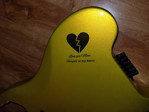

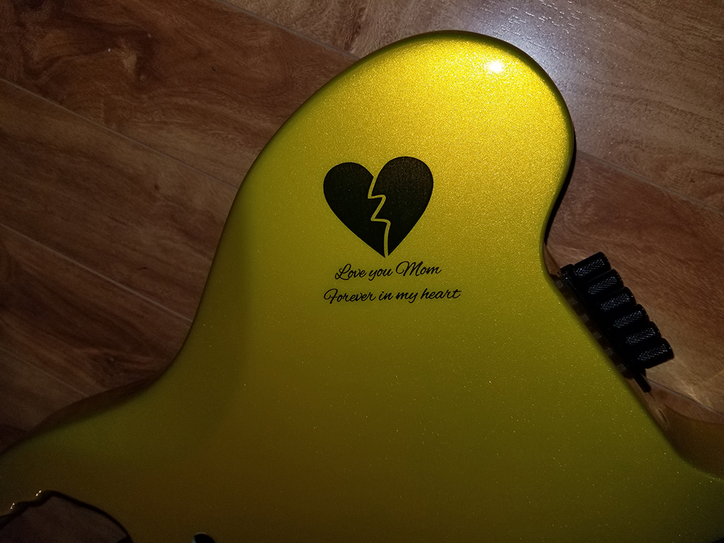

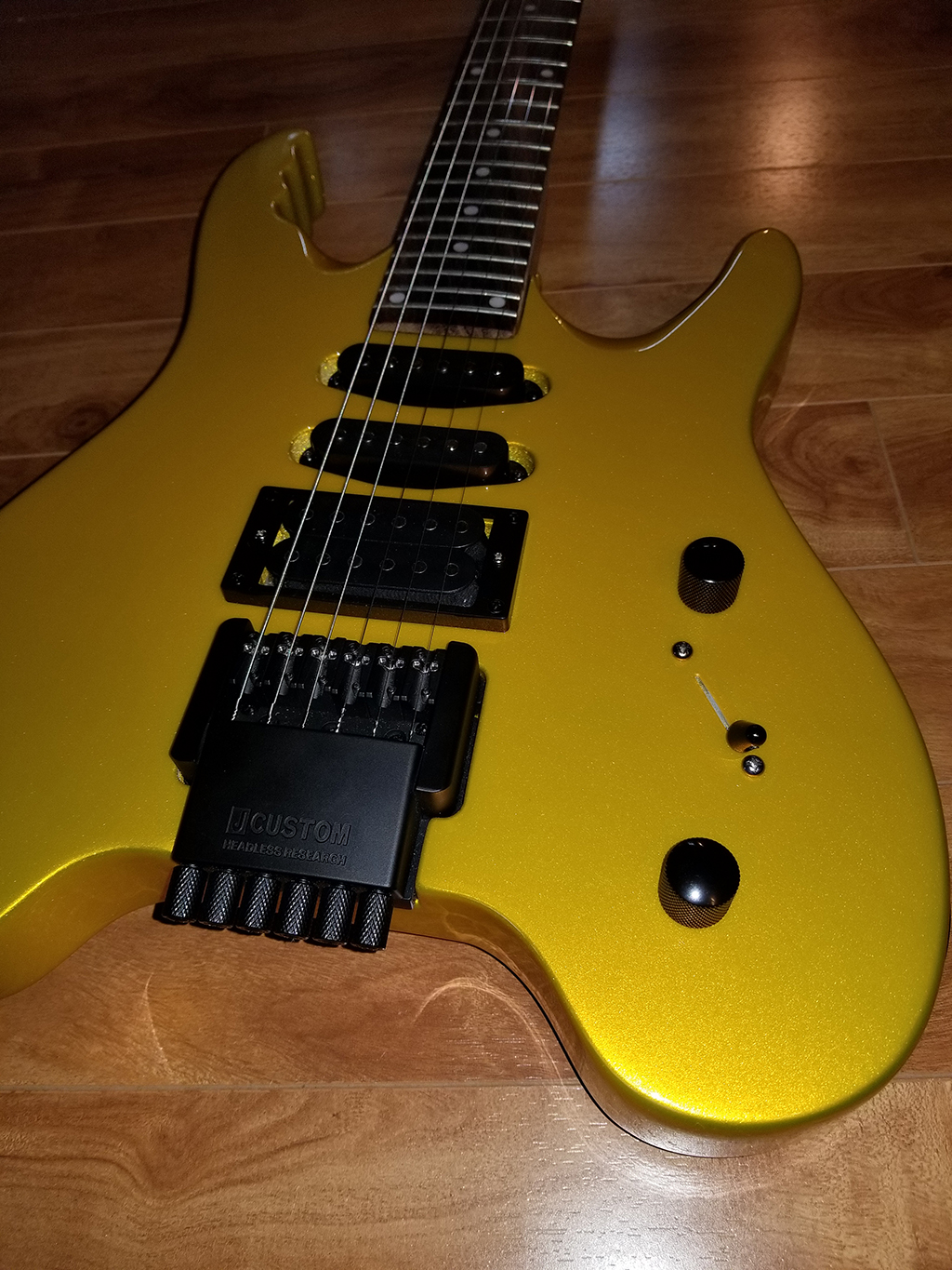

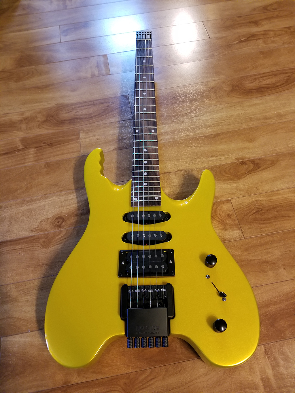

    My Pagan/Spanish Gold SH-1 build. All wired and playing great. Hardware upgraded with JCustom bridge and headpiece. Love this guitar. Body painted by Orangepaint Factory in Fredericton NB, Canada. I finished the neck with Walnut stain and Tru-oil and wax. Also a special detail on the back in memory of my Mom who passed away in 2014. Please accept for my entry for the September Guitar of the Month.

    Looks great. Nice tribute to your mom.
    In theory you're breaking the competition rules by not including a separate picture of the headstock - but I'm sure that in this case that rule can be waived!
    Haha .. nice. I am sans headstock lol
    Looks great and also forgiven for no truss rod cover.

    Looking great! Your mom would have been proud on you
    Beautiful sentiment on the back and a stunning paint finish. Great job Klegacy.

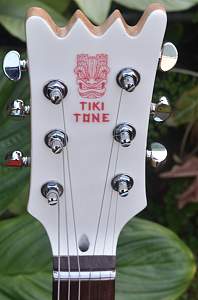

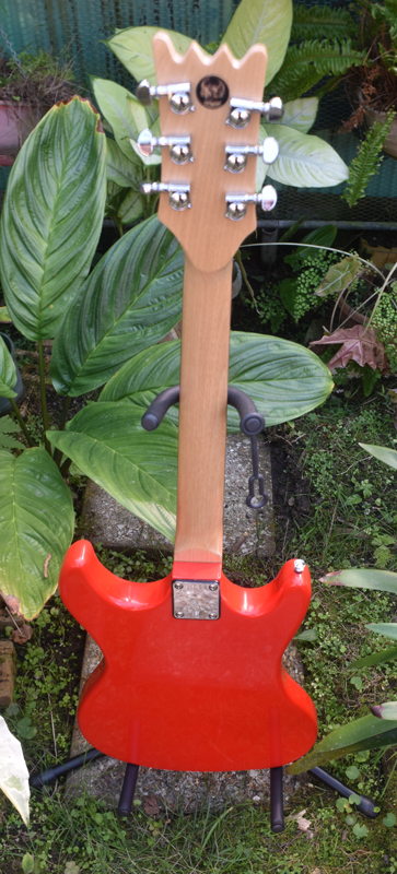

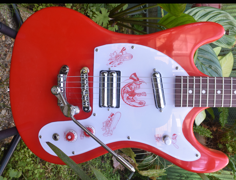

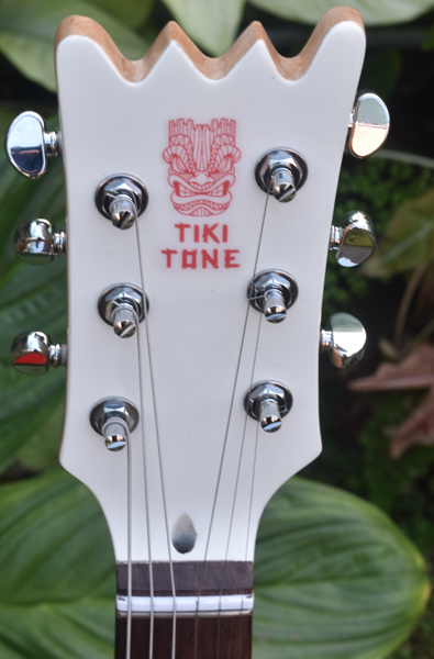

    I'll throw my MKA-2 in the ring.
    I guess some of you guys have worked out I like weird stuff so the Mossy had been calling my name for a while.
    Mods are : Custom clear pickguard from Pabs to which I applied a clear print out of some 60's style surf monsters and tiki's. Then put a layer of white vinyl behind that. ( all done from the back). I also asked Pabs to switch the pick up positions so I had a humbucker at the bridge and a single coil at the neck. I figured I needed oddish pick ups and ordered a set of lip sticks from Guitar Fetish. The humbucker splits on the volume pot push pull. I wanted matching knobs keeping in the whole 60's look so I ordered some from ebay , red centers with white rims but the red was no where near a match so I had to carefully sand it off and repaint with the same paint I used on the body. ( Auto acrylic).
    I also wanted a trem ( surf guitars must have a trem, it's in the rules!), I'd spotted the Dusenburg le trem a while back and thought it suited the slightly odd style of the build and ordered one , also ordered a Realtone roller bridge. I'm very impressed with the Le Trem.
    Tuners are Mini Grovers and she is currently strung with Hellwire 9's.

    lovely paint and tribute to your mum Klegacy on the SH-1 looks great.
    Another cool Dedman entry. Love the mods.

    Lovely tribute klegacy
    Dedman - I dont think you built this one - the quality is there but no way you built a red guitar..... very cool mate
