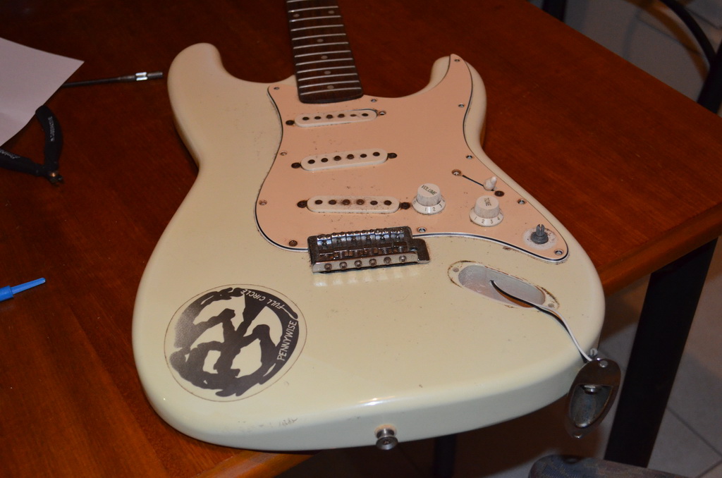

    I have a '97 Squire Strat that was given to my son in 2011 by his guitar teacher. It was a total wreck at the time, it had been sitting in his garage (in the sun by the look of the yellowing) and had become inhabited by families of little spiders in just about every nook and cranny on the thing. Not to mention the rust. Here's a photo:

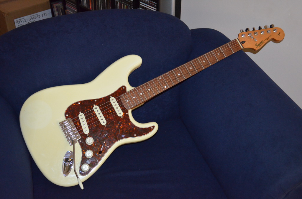

    I spent a couple of hundred on all new hardware (nothing could be saved), pickguard, pots (originals were infested with spiders) and selector switch. The neck and bridge pickups were open circuit even though the coil wires were still intact on the solder joints. I'd recently replaced a set of pickups in a Squire Strat for a mate, so I still had those ones, which, luck would have it, the neck and bridge were still good, but the middle was cactus. So I had a set of three that I put in and my son played it for a few years. Here's a pic of how it turned out (check out the circle from the Pennywise sticker). It cleaned up pretty nicely in the end and my son loved it.

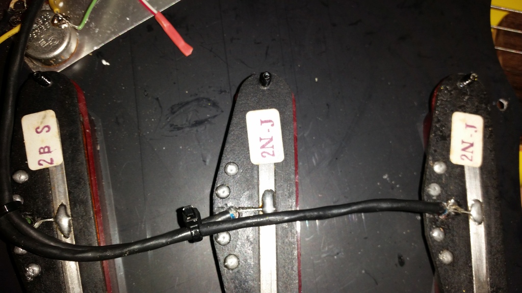

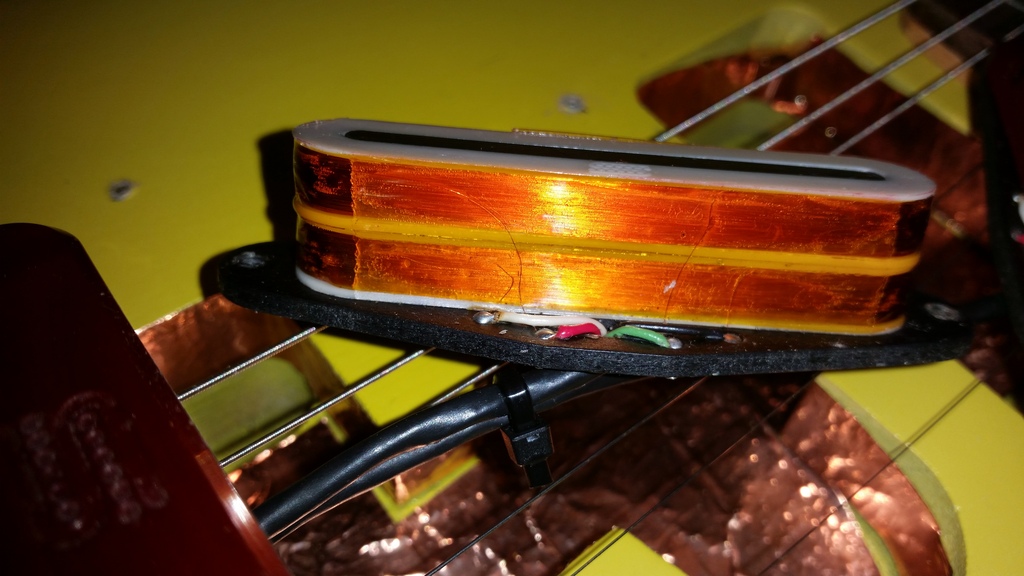

    @FP I'll get some detailed pics for you tomorrow when I pull the Strat down, they are stacked humbuckers the same size as SC Strat pickups

    Here ya go FP, I have swapped the pickups back to the standard kit ones I need some Hank B tones that the SDs simply don't give me.
    They are 4 wire though so no doubt there are a multitude of coil split options available, one pic with the cover slipped off.
