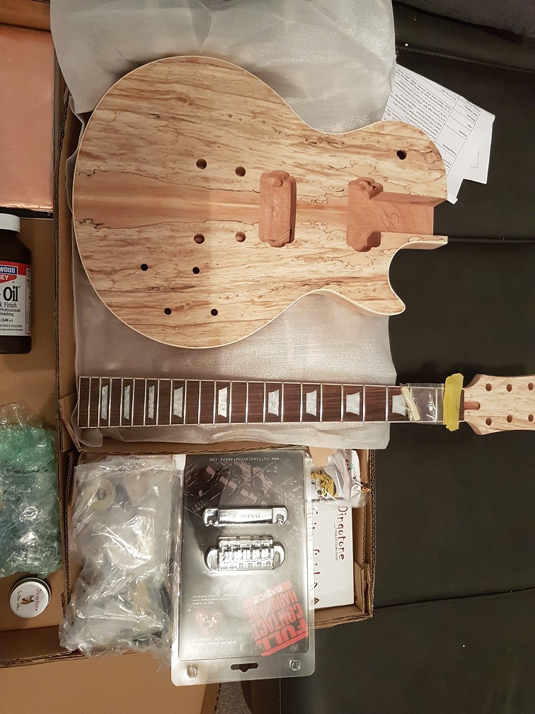

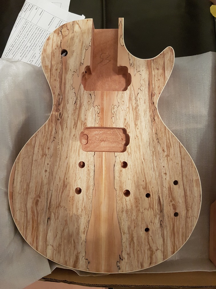

    Well its arrived, resisting the temptation to try and do anything right away will wait till the weekend when I have some time. At first glance, looks good, no obvious glue marks or other issues.

    Nice Grain! I love the stripe down the middle! This one looks like it should be another pearler!
