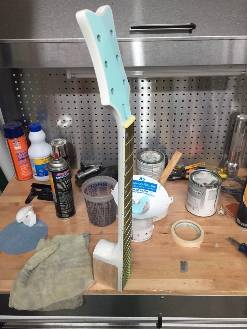

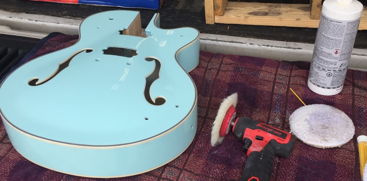

    PS- Here are a few pics of my build so far.
    Crash
