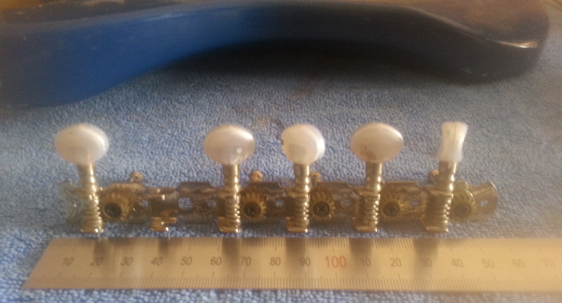

    Hi Waz,
    Had a bit of trouble trying to take the photo but here it is:
    Here's a google pic too: https://www.google.com.au/search?q=K...tKcUht6U-fLHM:
    I was thinking of sanding it back but I won't now. Just do up the hardware, eg. The volume pot needs to be replaced or possibly rewire the whole thing and it probably won't crackle as much. The wiring is quite frayed. As it is well it works.
    Thanks for the offer on them....this is in a straight line for the tuning pegs on a flat piece of metal(hope that makes sense). Thank you for the offer, PM me if you like.
    Alkay.
    Hi Alkay, that looks like an acoustic guitar type setup?
    I know it will leave screw holes on the back of headstock but the best thing would be to chuck that piece and refit with some individual 6 inline tuners.
    Yes, once that type of tuner peg is broken, it's really not worth trying to mend it (unless it is from some high value vintage Martin or similar). You may get another 6-in-line strip like that, but you'd need to make sure the centres of the tuning pegs line up exactly. Small individual tuners for Strat and Teles will fit, but get the more modern styles that are individually fixed in place (as opposed to vintage slot-headed Kluson types).
    From the ruler, the spacing between centres looks to be around 25mm, so they may even be using an imperial 1" spacing. I measured my Strat with traditional Kluson tuners at 23mm between centres, so I'd avoid the Kluson types as the hole spacing will mean the tuners will be too far apart to use the common single fixing screw (I know this because I bought an eBay Tele neck with wider hole centres than vintage spec and I had to fix/bodge the Kluson-style tuners I bought for it with some very fat headed short screws - looks awful but they're on the back so are rarely seen).

    Hey Waz,
    I installed the tuning keys you sent and it looks really nice. Thank you so much. I followed your advice and it worked out quite well. The keys are well seated after drilling bigger holes in the headstock. I had to go up to approximately 11 mm diameter but looks good. Very shiny those tuning keys.
