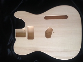

    Firstly a big thankyou to Adam for finding me a TL-1 body only, I wanted to do some experimenting with fabric so this was perfect.
    The body arrived this morning and the sanding guy or girl at the factory did an awesome job, might have been the first one of the day, cause this body is pretty schmick.
    Clean routs no tearouts and nicely sanded even on the cutout yay!
    See the attached photos for more details including the fabric which is a 100% cotton quilting fabric in an awesome sugar skulls print. I will probably spray the back and sides black. The white pickguard came with the body (thanks Adam) which I will use as a template for cutting the black pickguard. I want to leave as much body showing as possible.
    Neck and hardware, will depend on how much of a success or failure this turns out to be

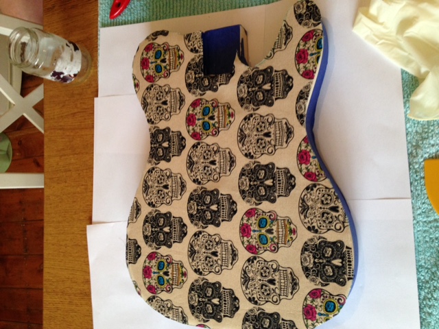

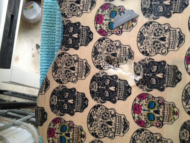

    The process of sticking fabric to a guitar body
    I'm watching with interest Euroa! Can you give us some detail about your process? I'd really love to do something like this myself.
    Hi Gav this ones for you, the process so far:
    1 Sand body to 240 grit to leave a key for the resin
    2 Tape edges and neck pocket to help with any drips
    3 Cut out fabric with a 5mm overhang (I used quilting cotton as it has a little more weight to it)
    4 Place tissue into cavities so fabric doesn't collapse into them
    5 Iron fabric to remove any creases
    6 Place fabric on guitar and mix fiberglass resin according to instructions
    7 Using a wide short bristle brush apply resin, smooth out with a wide spatula or scraper. Make sure you have a good . coverage and that there are no air bubbles. I applied a little resin to one side and then the other side first to help . . stick it down
    8 Leave to tack off for 4hrs
    9 Using a sharp blade trim edges and cut out cavities
    10 Allow to dry for 24 hrs then apply another coat of resin to make sure all the fabric is coated and help stick down the . edges around the cavities etc.
    I'm now up to the stage of routing the edges, so far its gone really smoothly with no air bubbles... be warned the resin stinks don't do it in the kitchen like I did, the Mrs wasn't too happy!
    Photos #1 Fabric laid out #2 Resin applied and cutting cavities out #3 Ready for routing edges sanding and topcoat (picture quality not the best but it is actually as dark as the first two photos)
