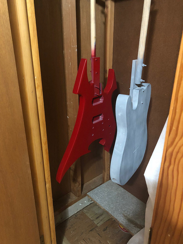

    Hey BJMtz- I'm starting out by painting it red-- Ford Motor Company Cardinal Red to be specific, made by Dupli-Color. But then I'm going to sticker bomb it with the most offensive stickers I can find and then seal it with a clear coat.
