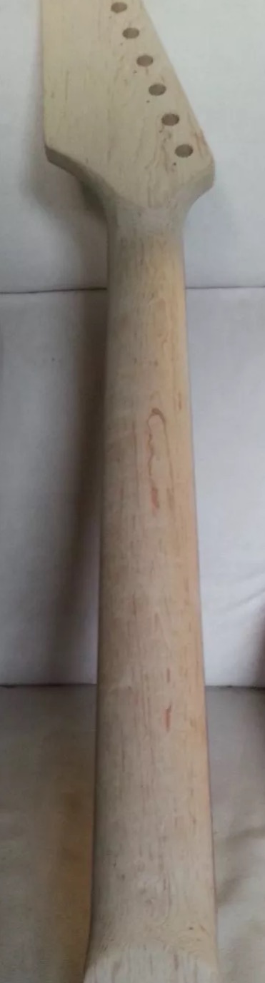

    Hey guys.
    First project related post since I signed up so sorry if it's abit full on.
    Just accidentally bought a neck off eBay... *handy tip. Don't let kids play on your phone after you've been looking on eBay lol*
    I picked up my phone and seen that I won the bid of a neck I was looking at on eBay and being only 20 bucks I thought stuff it, it's only 20 bucks. It came from a kit where the guy didn't require the neck. What's the worst that could happen? Maybe I'll learn a thing or two. I haven't received it yet so i am unable to comment on its quality just yet and I'm just planing a head
    So now I have to think about how I'm gonna Finnish this neck, how I'm gonna shape the headstock and how I'm going to level and dress the frets.
    I was thinking about spraying the neck in a vintage yellow/Amber nitro but not 100% certain on that, wouldn't mind seeing some examples of some other ways to go i.e stains, tru-oil etc
    As for the tools I'm planing to use or purchase for this job is probably a fret leveling tool from als and maybe a fret end file. What are people using to level the frets? I'm more than likely going to need buy a fret rocker which is no stress and could I just use my 1 foot aluminium strait edge with some sand paper stuck to it as a leveling tool?
    Also, what are people using or who are they using to make up their custom logos?
    Sorry for the 20 questions and thanks in advanced
    *will post some pics when I figure out how from my phone

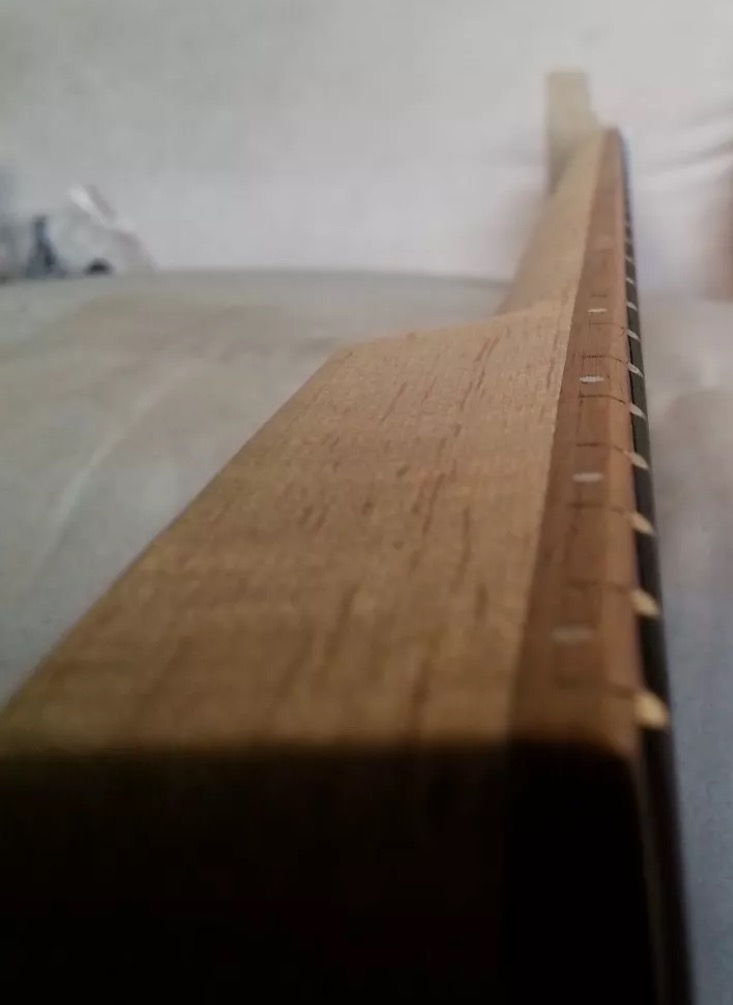

    Pics uploaded from my phone after they were cropped massively to be able to work
ID:	14277   Click image for larger version.
ID:	14278   Click image for larger version.
    Hi Dozey
    I've been using a 300mm long sharpening stone as a leveler, works OK but I'm sure the right tool would do it better. For logo's people tend to use decal paper in a printer mostly if doing it themselves. So far I've used auto acrylic and tru- oil, both have given good results.
    Test fit it to the body and make sure your tuners fit the holes before starting, nothing worse than scratching a finish trying to fit things.
    a spirit level makes a great leveling tool, perfectly flat edge, inexpensive, use double sided tape to attach some sandpaper and you are away
