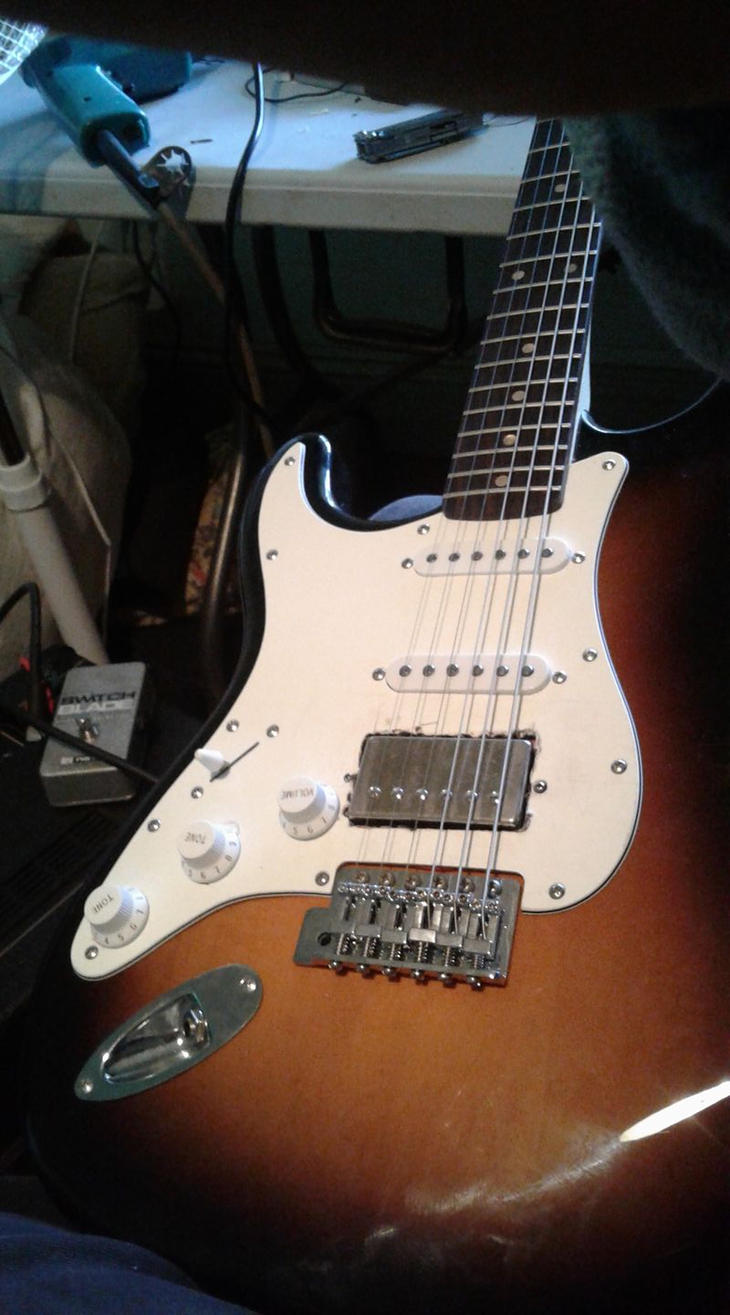

    Managed to wire it in properly (turns out I had the ground and hot wires for the input jack soldered wrong, hence the buzzing... DOH!) and get it working, along with replacing the original Affinity pups for some really nice Tonerider Surfaris (same as the Classic Vibe strats). I decided to put the neck pickup from my SG in the bridge of the strat instead of the bridge humbucker just... because I thought it would be cool. It works just fine, gives me that humbucker chunk I want. Only real fault I have is that the tone knob doesn't actually do anything to the humbucker tone-wise, but I can blend the mid single coil and the humbucker in together using the tone knob for a bit of fun. Happy little accident
    I also (not shown in below pic) had a crack at a 'relic' job (I figured why not, seeing as I'd melted away the hole for the pickup instead of getting a HSS pickguard... so why not add more grunge and gross to the look of the guitar). It's not going to look pro, but I don't honestly mind. I just want a guitar that is uniquely my own
    The guitar itself plays great, the Squier Affinity necks are really quite nice and smooth, even if they lack colour and character. I find lead playing is really fun and easy. The new pups make it sound much nicer, although I reckon (like anything really) I'll need to play around a bit before I can nail the tones I want out of the instrument.

    Glad you got it working. Using the neck pickup is a good idea as it will have a slightly lower output than the bridge pickup and so will match better in levels with the single coils.
    I'd be tempted to try fitting a pickup ring around the humbucker. A thin flat one would do it and it would make it a bit more individual whilst still hiding the rough edges of the hole. But looking at your picture, I'm not sure that there's enough space between the lower edge and the volume control knob to fit one.
    If it was me. I'd get annoyed with the hole after a while and have to get a new scratchplate.
