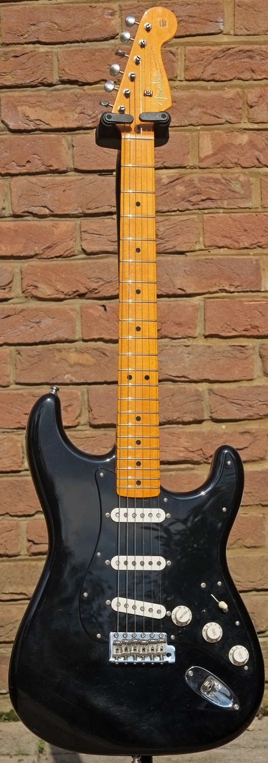

    Hi George and welcome.
    Here's my NOS CS DG Strat, so we've obviously got something in common!

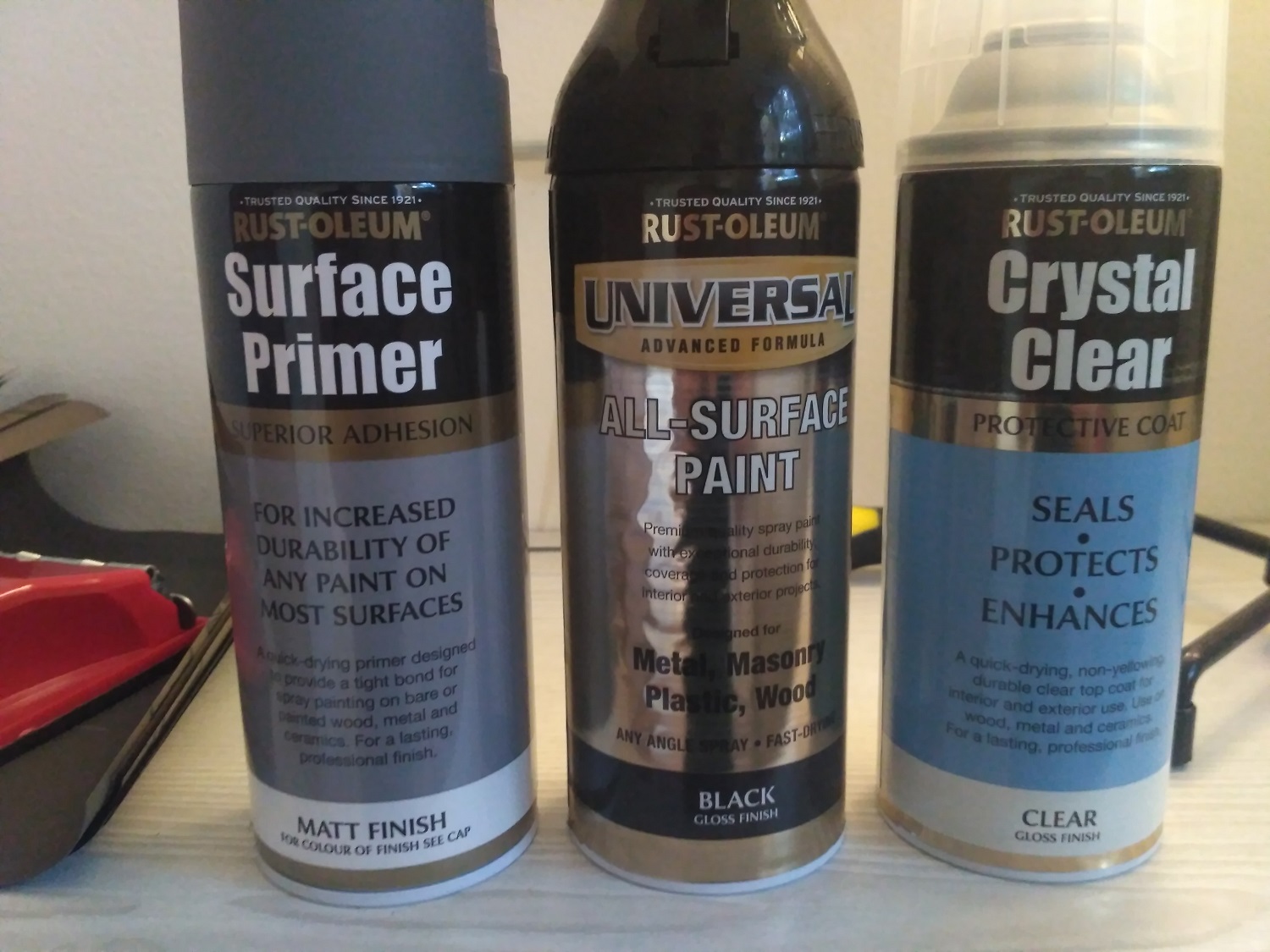

    So the products i'm going to use ate these:

    And if i understood weel from your instructions, i don't have to grain fill and possibly even seal the body.
    What products did you use on yours?
    I've was using nitrocellulose spray cans to start with, then bought a compressor and mini-spray gun and am now spraying nitrocellulose from tins (it's a lot cheaper).
    It's good you are using products from the same manufacturer. They look to be acrylic based finishes, which is fine. You just need to allow sufficient time for them to dry before sanding them down and polishing them. Acrylic dries from the top downwards, so the outer surface may seem hard, but it's often still soft underneath. Then when you come to sand, you can break through the hard layer and it all goes wrong. So you'll need patience and just be prepared to let things dry, At least you generally have the benefit of a warm climate without the high humidity that a lot of the Australians here get, which can slow drying times down a lot.

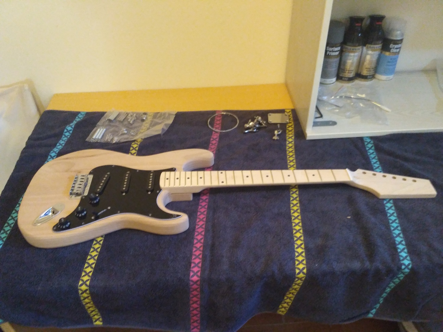

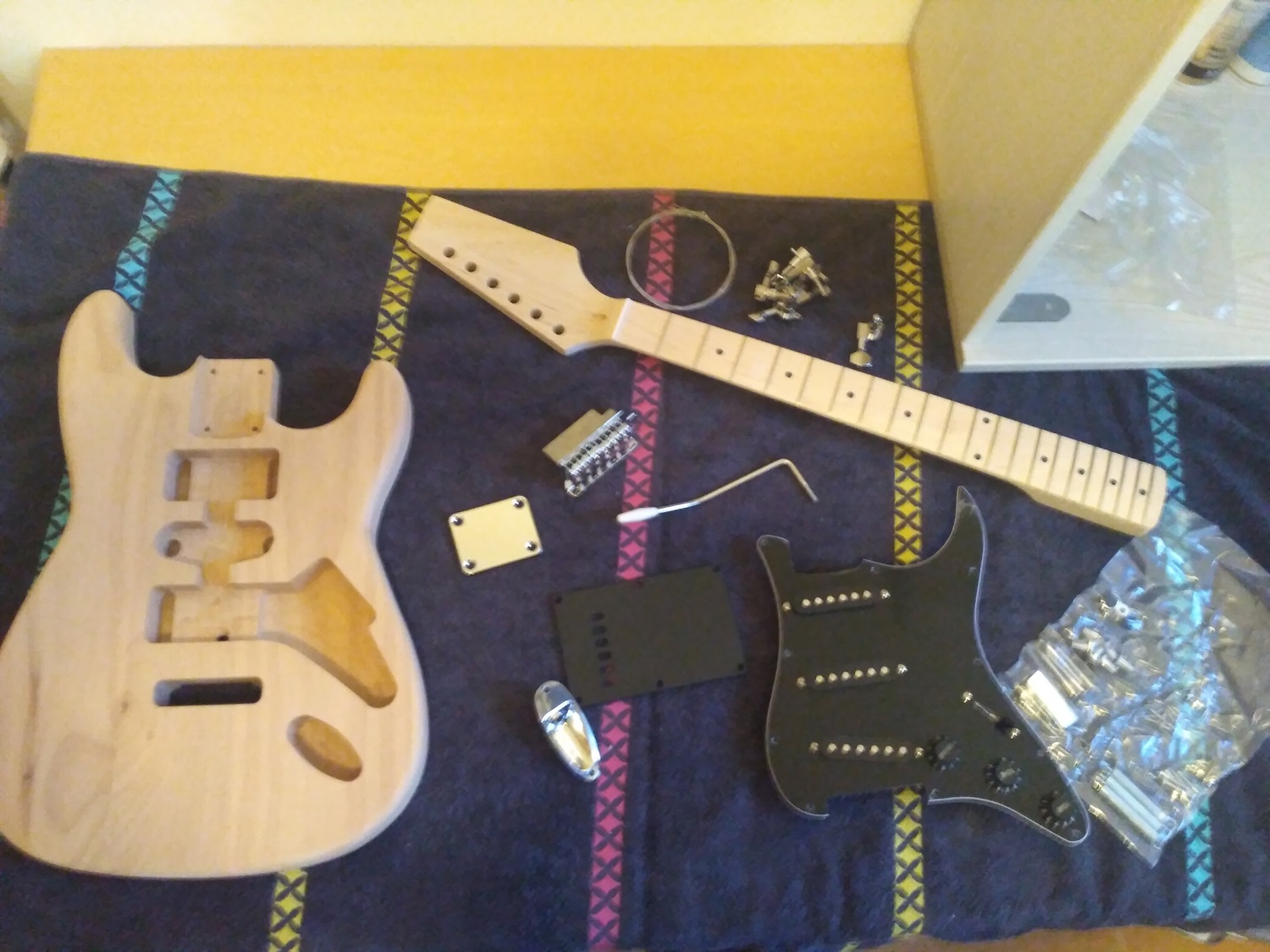

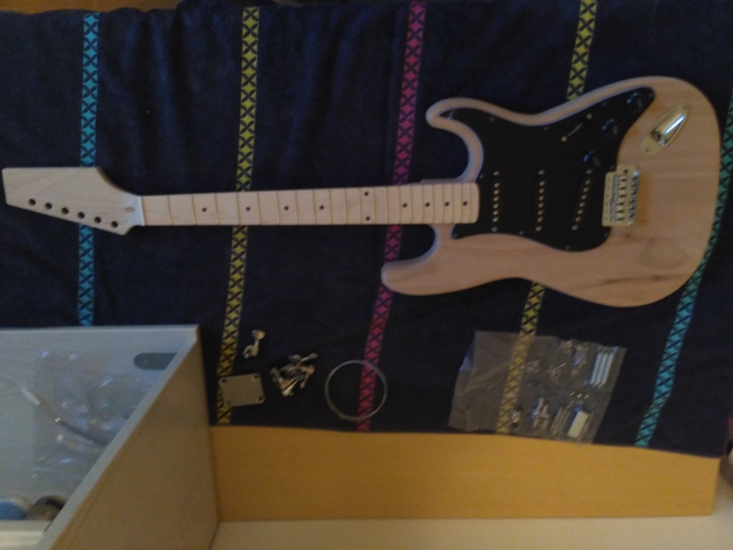

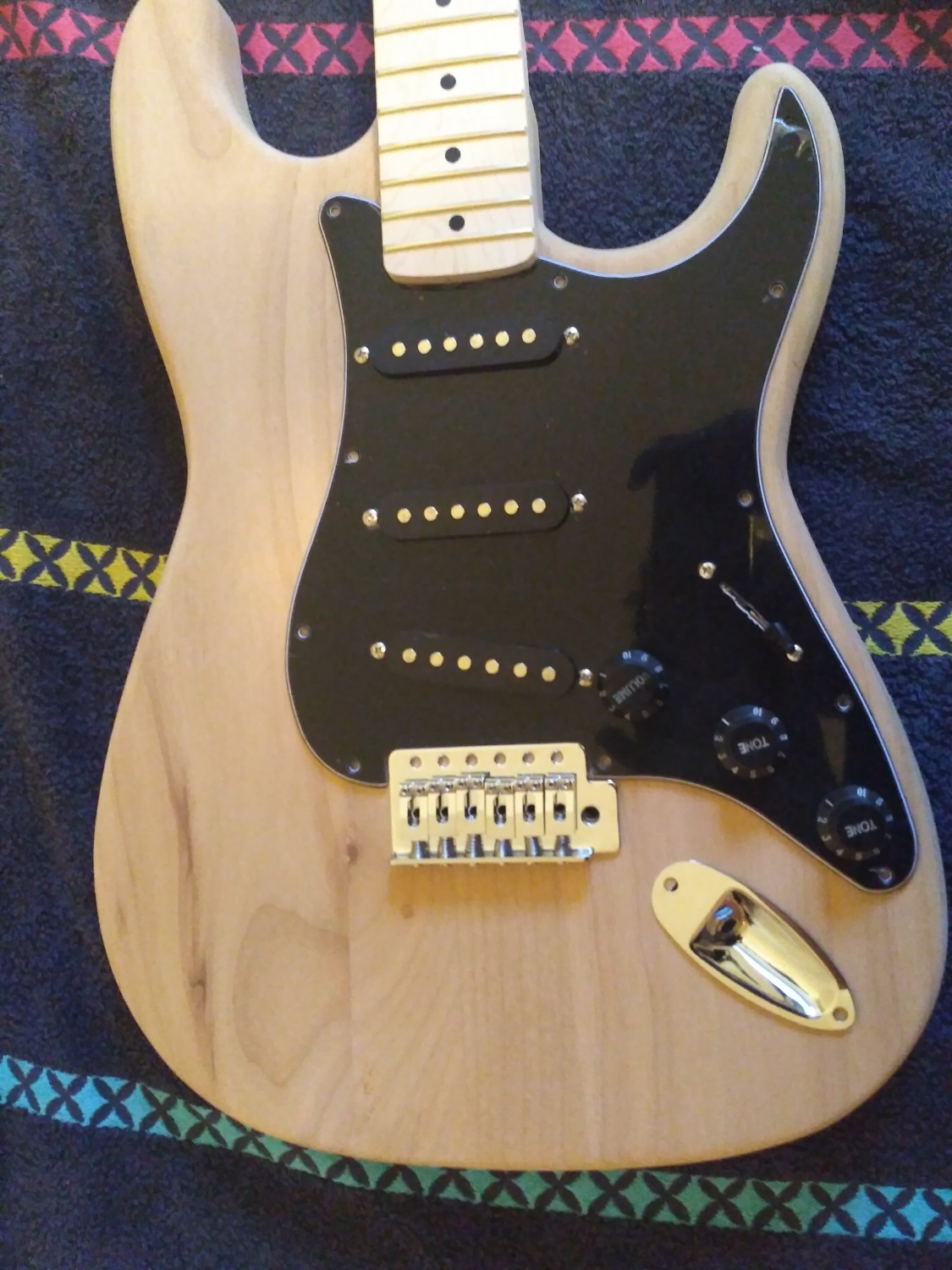

    I've just finished with the mock build and i realised i have some problems with my kit which i have to solve before i go on..

    And now the problems..

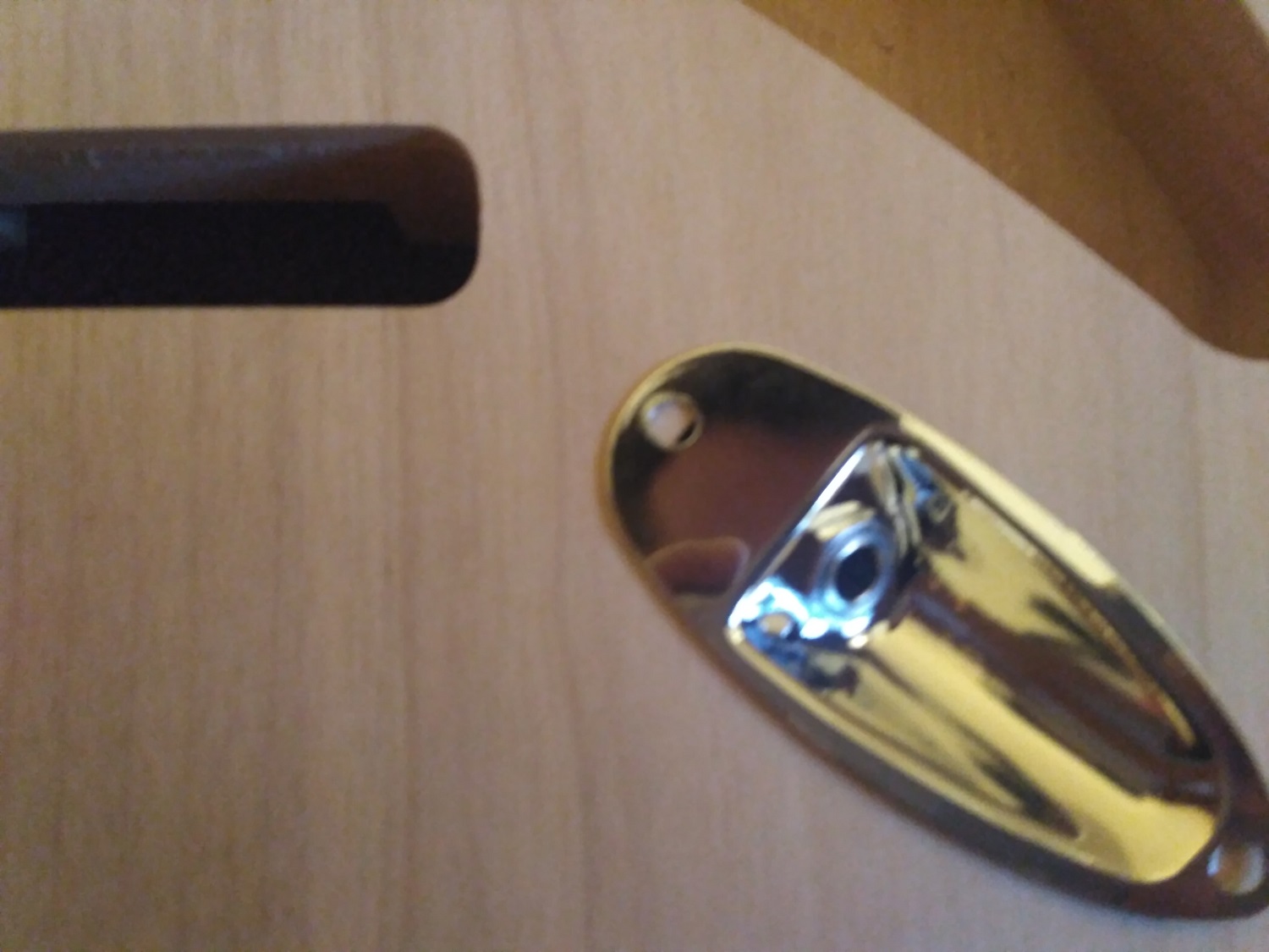

    First and as it seems more easily fixed the jackplate isn't fitting correctly to the body.

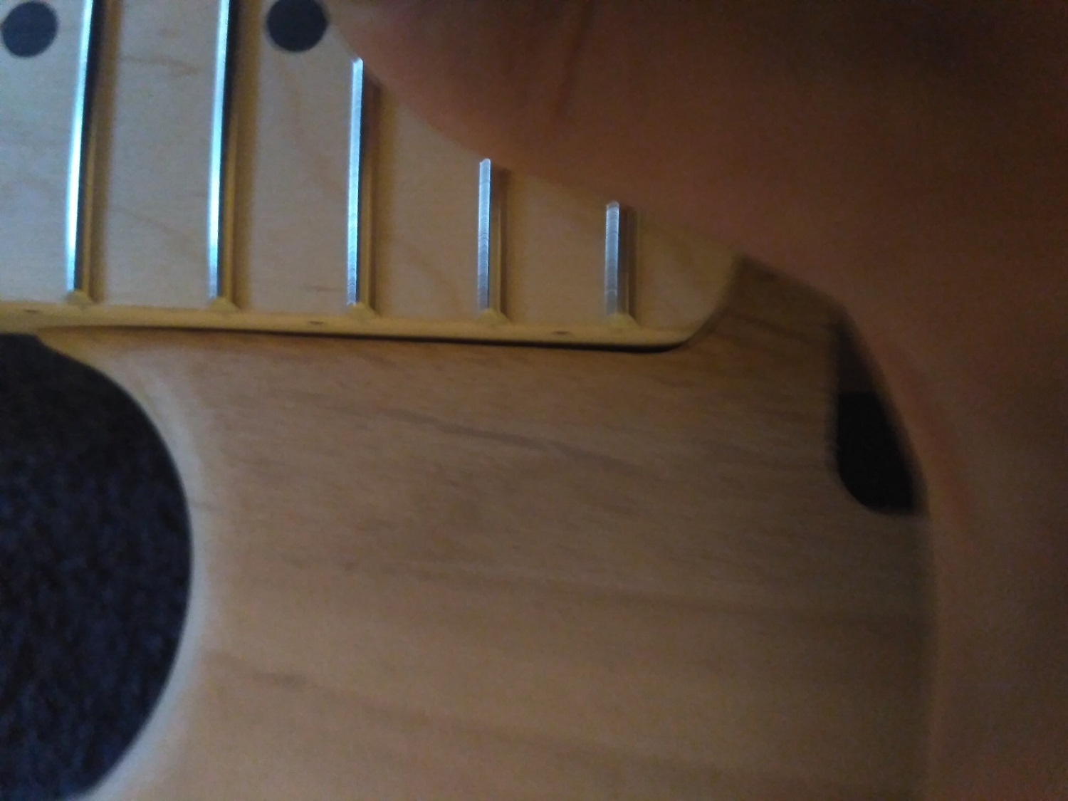

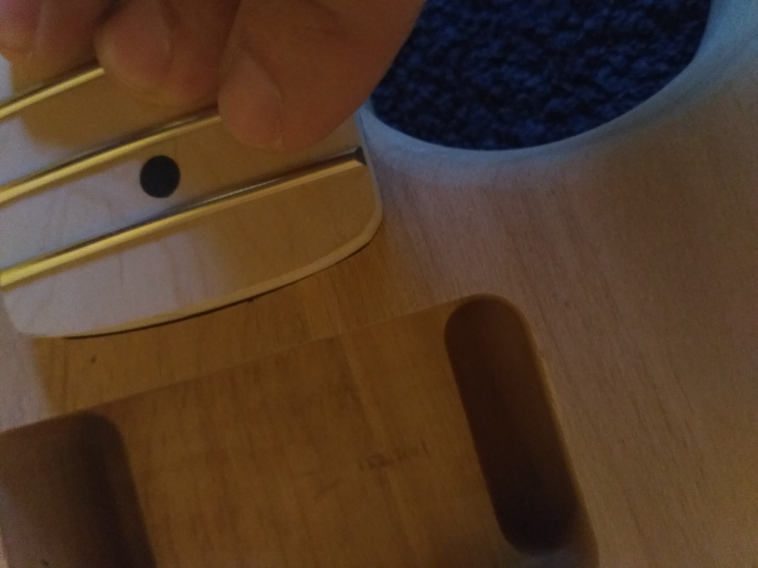

    And second and a little trickier is the neck pocket.. The neck can't be placed firmly and the pocket is a bit bigger than its should totaly..

    I think i should try to even things out a liitle bit before anyhting else to ensure the neck is properly fitting the pocket.

    Does the jack plate not fit in the socket? Sometimes it helps if you loosen the nut and twist the actual jack connections round on the plate as in some positions the tip connection can touch the body and keep it from fitting correctly. It's worth testing this with a jack plug installed as well, just so you get it so that it doesn't touch.
    If you take the jack socket part off completely, does the plate sit in the cavity correctly or does it still sit proud? At worst, you may have to use a file and enlarge the cavity slightly, probably easier to do this at the thinner end (away from the jack input).
    If you are going to lacquer the neck, then you will make the neck slightly thicker anyway, so it all depends on exactly how much of a gap there is. As there is a gap, (then although it's not normally done), you can always spray the sides of the neck pocket to add some thickness and reduce the gap. If it's sizeable, then people have got a bit of very thin maple veneer and stuck that on the edge of the pocket.
