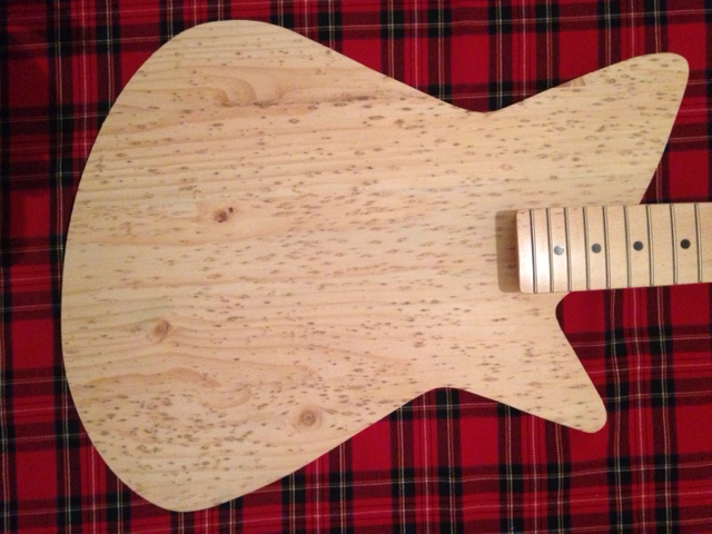

    Saw this timber before Christmas at work it was a length of 70x35 T2 Pine (framing timber) had really unusual birdseye figuring so had to grab it. Wouldn't normally make a guitar from radiata pine especially six pieces, however this is going to be a "Testing Guitar" it will have a slide out drawer that various pickups can be secured into to test. I have about 40 different pickup samples on the way so it should get a workout

    yeah, I saw a guitar made by Virgil Guitars on Youtube and his has the slide out drawer so thought might give it a try, at least then I can compare pickups a) in the same guitar and B) without removing strings

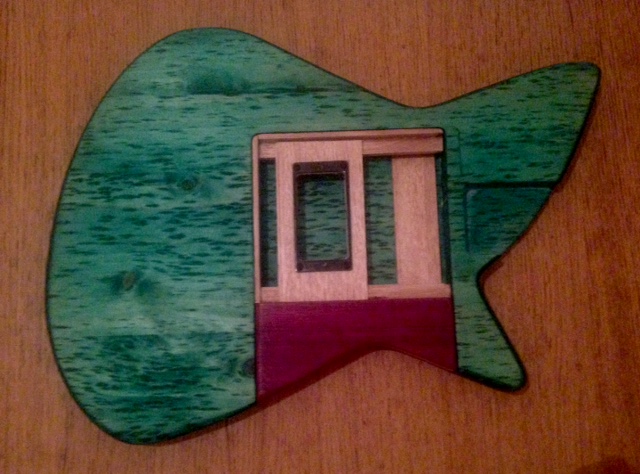

    The Green Machine with a touch of Purpleheart
    Well its nearly finished, the shape was something I was playing around with for a customer, sort of a 60s Japanese look.

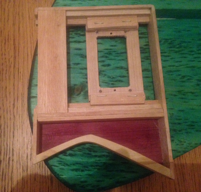

    The drawer took a lot of working out but it seems to function fine and two humbuckers can be placed in at a time. I am also making the slider for single pickups as well.
    All that's left to do is attach a neck and install a bridge, jack and a volume pot and 3way with alligator clip connections.

    I think that green staining you've done looks magnificent ..well done !! what kinda product you using?
