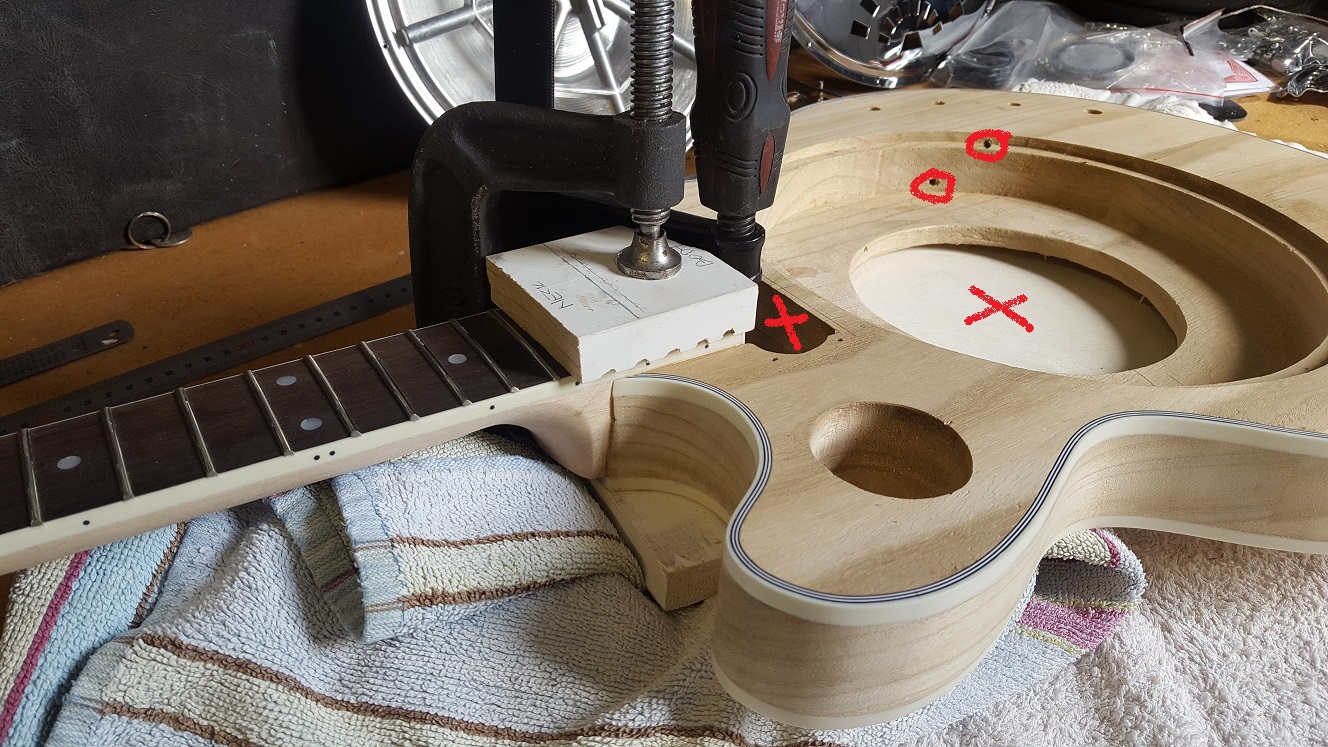

    Welcome and congratulations on taking a resonator on.

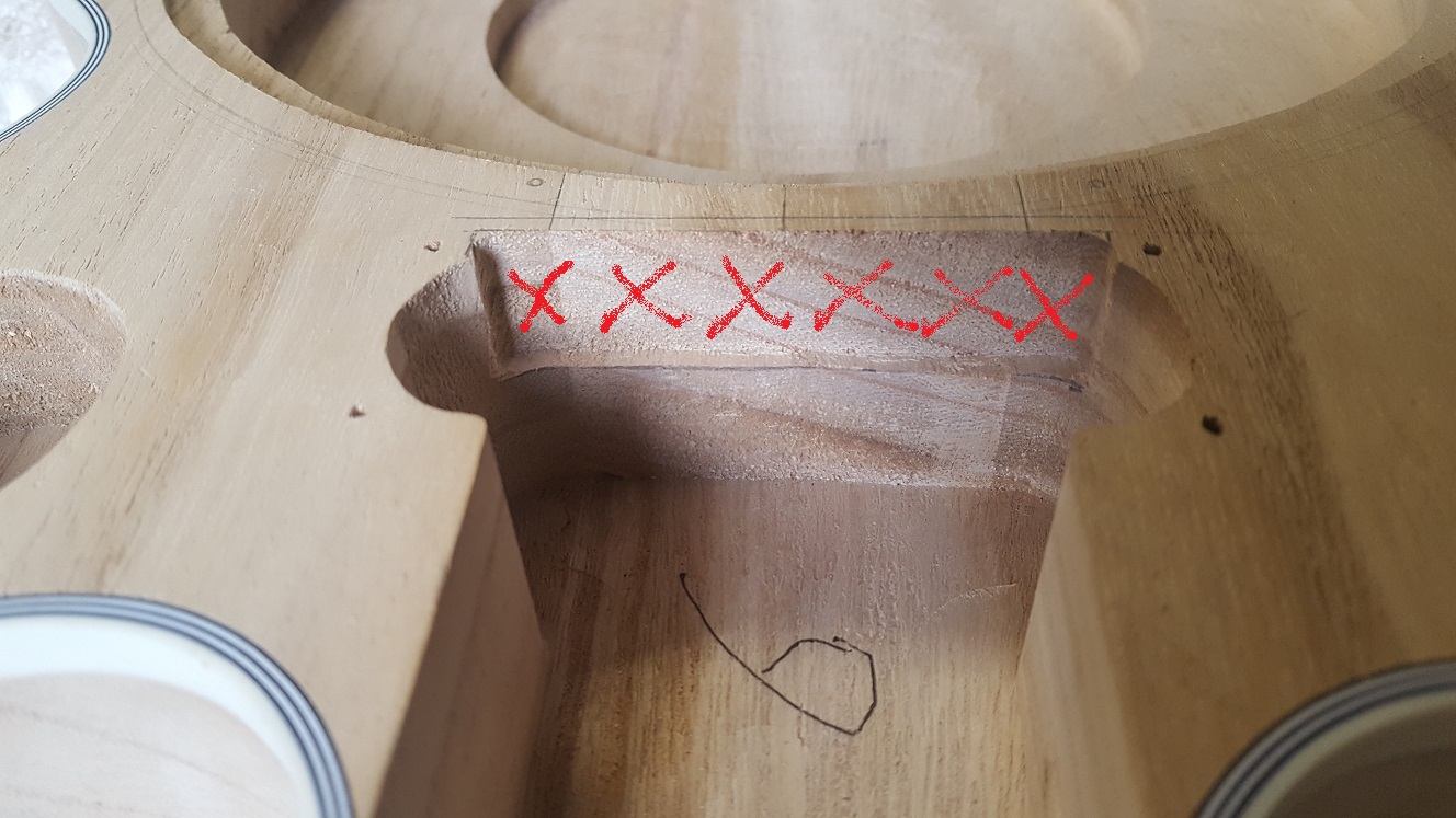

    A couple things to look out for are fitting the mini-humbucker under the neck, I had to remove timber. Also had to cut the bottom of body out to give clearance for the cone. Also drilling all holes for wiring was another thing not done that normally is expected. My cone hole was not central to the neck, had to mount bridge off centre. Silly little things that are easy to correct as long as you don't rush it.

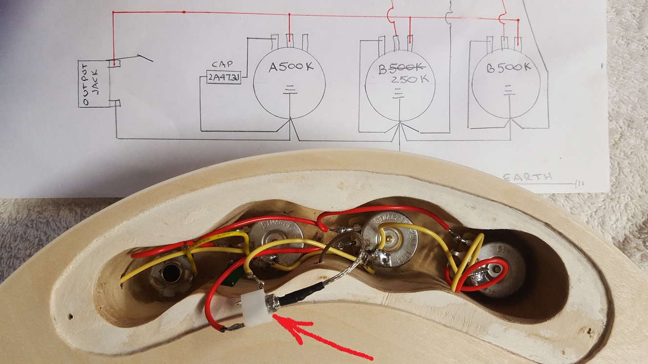

    Thanks, looks like there are similar things with this one too. The neck pickup will be tight but it looks like the cone etc will be ok. Quick look last night shows that the bridge looks like it is going to be a bit low and the piece of wood supplied is a bit ragged. How did you go with the piezo? Not sure where it goes and it has a connector but nothing to connect to. The kit seems basically ok but overall not really well thought out, maybe bits added as they went along. Timber front has lots of deep grain imperfections which will need lots of careful sanding out but filling if too deep and there goes a nice stain / clear finish. Stay tuned!. Cheers, Trev.

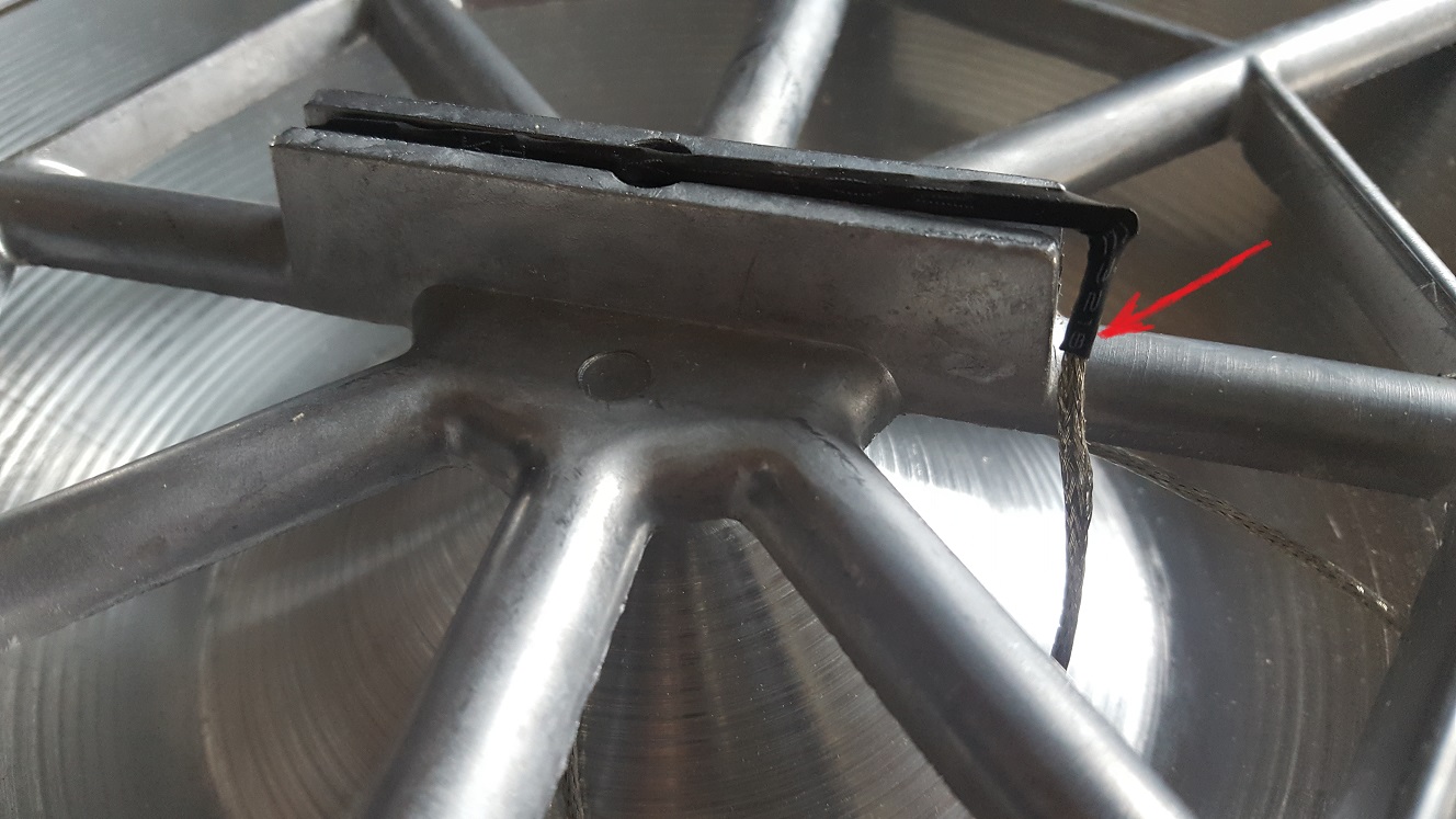

    Quote Originally Posted by Trev56 View Post
    I drilled a hole through the spider (red arrow) to allow the piezo to sit correctly. Purchased an inexpensive female jack to accept the supplied piezo connector and plugged it in within the pot cavity. Did the same for the humbucker but plugs together under the cone. I can now upgrade the piezo and humbucker without soldering. A friend planned this wiring and it works well. I upgraded my pots and made new all new wire.
    EDIT. The piezo sits under the bridge, string pressure onto the wooden bridge transfers vibration into the piezo. Hope this helps.

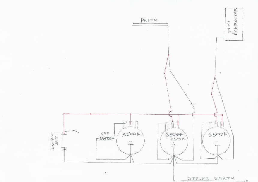

    Piezo connection.

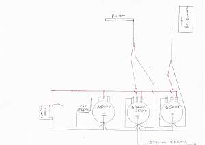

    Ahah she said! Thanks heaps, makes a whole lot of sense now. I was thinking along those lines but (silly me probably) thought that it might be a bit more clear in the kit! Since starting the thread I found a few references to line pre-amps being used with these pickups and guess that is the idea of the plug. I like your solution, very neat and well thought out. Thanks also for the wiring diagram. Found a few suggestions where either two vol pots used or one vol and and a blend pot. Decisions decisions! Cheers, Trev.
