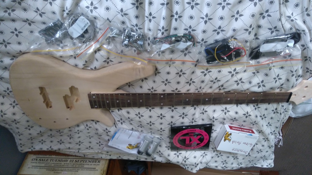

    So i did a mock up build. looks good. only one issue. the fingerboard sits a couple mm above the body. how should i go about fixing this?

    There's nothing to fix, that's actually how it's supposed to sit (to give sufficient clearance for the height of the bridge). The important thing is how the neck sits relative to the bridge/saddle height, and therefore how the string height (action) will be.
    If you clamp the neck in place and then sit the bridge on the body and run a string/fishing line from a nut slot to to the corresponding bridge saddle it should give you an idea if the neck is sitting correctly. Are you using the stock bridge?

    Thanks heaps WeirdBits. I'm probably going to use the stock brigde. just tested and compared to my brother's G&L bass and it looked fairly similar. I'm going to start sanding tonight and hopefully get the first stain coat of bushfire sunrise on tomorrow.

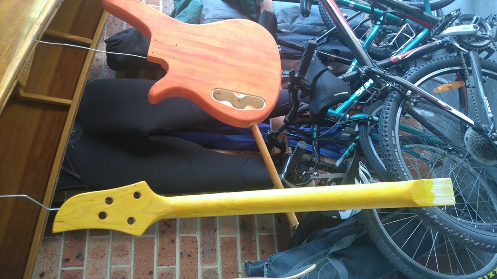

    So Today i sanded and put the first stain coats of mission beach and Bushfire sunrise. The mission beach was more yellow than i anticipated but i thinks it'll still be good.

    You could always add a small bit of Bushfire sunrise into then next coat of mission beach to make it slightly darker and less yellow. Best to play around with samples on scrap timber but reckon about no less than 5:1 and no higher than 10:1 where the higher number is mission beach.
    With the Fret board level they always look to be sitting a bit high but when you consider that bass bridge saddle at their lowest point sit about 15mm above the deck hopefully that provides some perspective to how it should end up.
