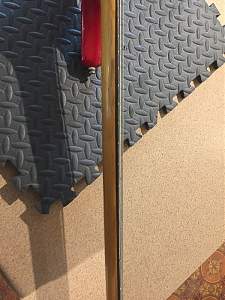

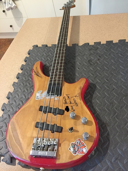

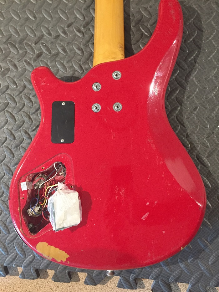

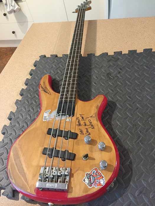

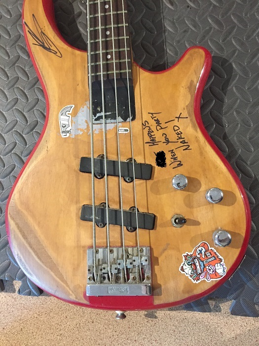

    When I was leaving, he gave me this Washburn B-10 for free. Told me he couldn't fix it and when he was tightening the truss rod, once, he heard a snap. So I took it home to gave a look.
    I don't know what happens when you party naked (I have deleted the expletive), but I know that the snap he is talkin' bout was the end of the truss rod breaking...can't be adjusted now. and there's a pretty significant bow in the neck. Aside from that its missing the control cavity plate (easy fix) and i am not worried about the electrics.
    I don't know if its a good bass or not, so I don't know if i should sink any money in to fix it.
    The question is....what should I do with it?

    I guess the fretboard has to come off for a truss rod replacement but an easier alternative would be to get a PBG neck that has the same size or slightly wider heel and mod it to fit.
    That's a great get by the way, can't go wrong at the price
    The model number indicates it's a low-end bass, though it's supposed to have an ebony neck and active pickups. Made from 1986-91.
    The unique neck-end shape precludes getting a low-cost replacement neck for it.
    So you either use it as practice neck for removing the fingerboard and replacing the truss rod, or you strip most of the parts and fit them to a kit Jazz bass (omitting the pickup selector switch) - with the proviso that the B-10 may have a narrower string spacing than a PBG JB, so you might not want to use the nice solid looking bridge. I'd measure and compare it against a standard PBG kit bridge spacing. Someone here should be able to give you the PBG string spacing.
    As for the sound, there's nothing stopping you plugging it in and seeing what it sounds like, regardless of the action. You either like the sound, or you don't.
    Hi mate, interesting little project you have got here?
    I would at least take the neck off to see if there is any way to get at the truss rod from the heel end of things. If not that has just upped the degree of difficulty plenty.
    YB4 neck might be closest PBG one that could fit. Maybe there is a Washburn one on eBay somewhere out there in the world?

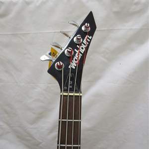

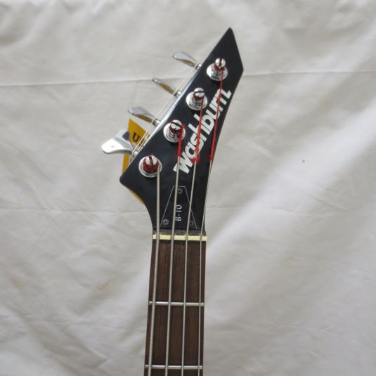

    The truss rod is adjusted from the headstock end, so there won't be any chance of heel access (generic photo, not actual guitar).
Name:	B10 headstock.jpg
