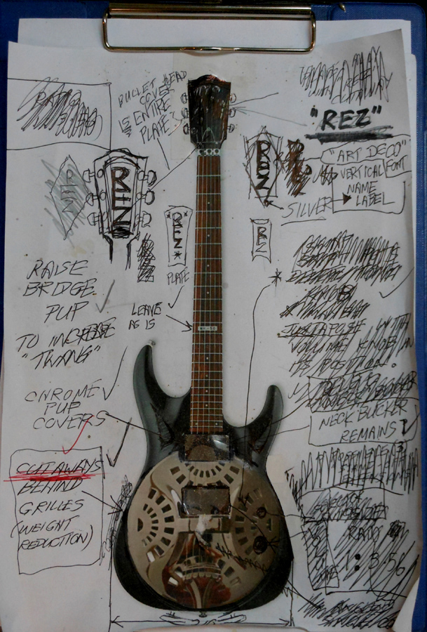

    Pic1: Before the mutilation started.
    Pic2: The "plan" ha ha.

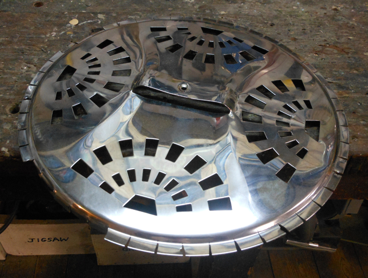

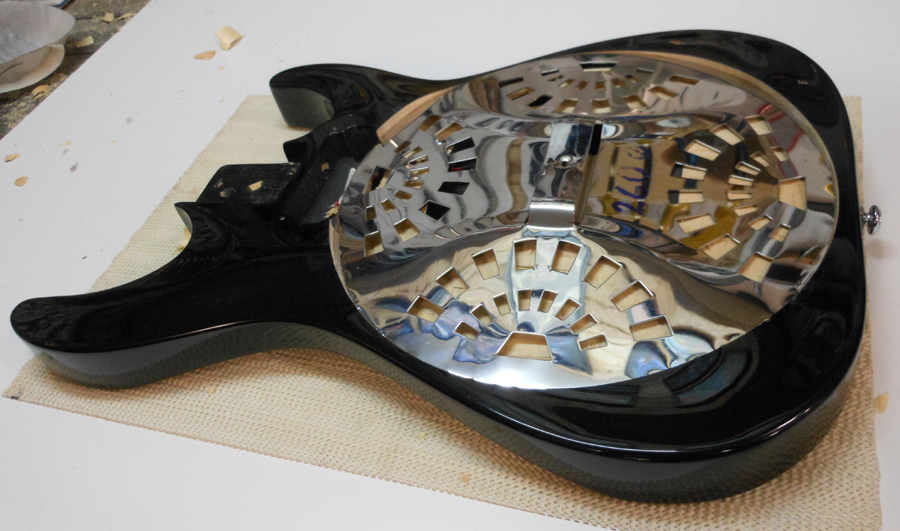

    Pic3: Oh sh-t, the plate's too big?

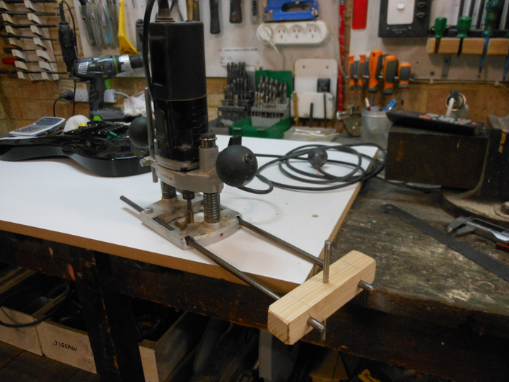

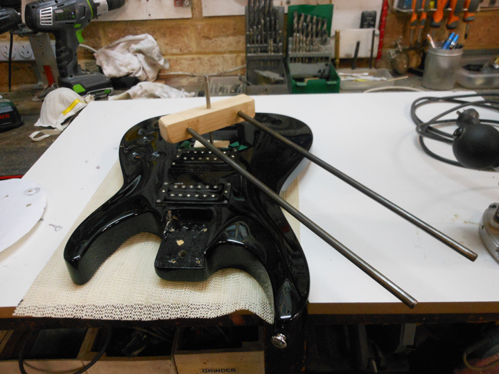

    How to reduce the diameter of a reso plate (everyone needs to know this?) and a jig for cutting a perfect (I hoped!) circular rout.

    More:

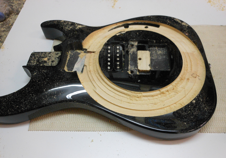

    The rout ( prior to chiselling for a convex result)
    Reduced plate first fit.
    The beginning of the end of the original 'stock

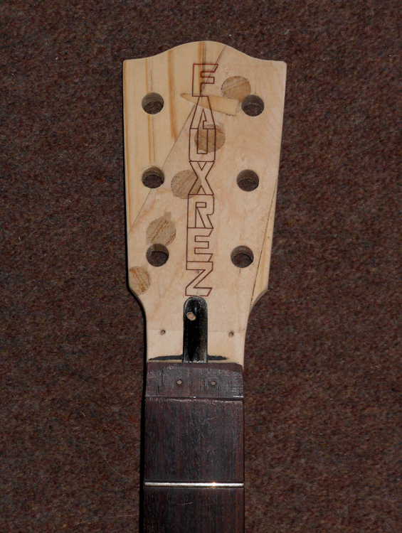

    Where the 'stock work is at now . . .

    Quote Originally Posted by maxaxe View Post
    I had to look at this several times before it sunk in!! I thought you would be adding a different neck, not adding wings and reshaping the existing headstock! That's brilliant!!

    great to have you back building Max, you always come up with the coolest ideas. Can't wait to see this build playing. Keep up the good work mate !
    You got the circles looking like fresh donuts top job with the routing jig. Also you do the best headstock remodels !
