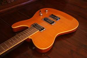

    I could have got a Fender Tele FMT HH in Hawaii in April for less it was never going to follow me home I really hated it
