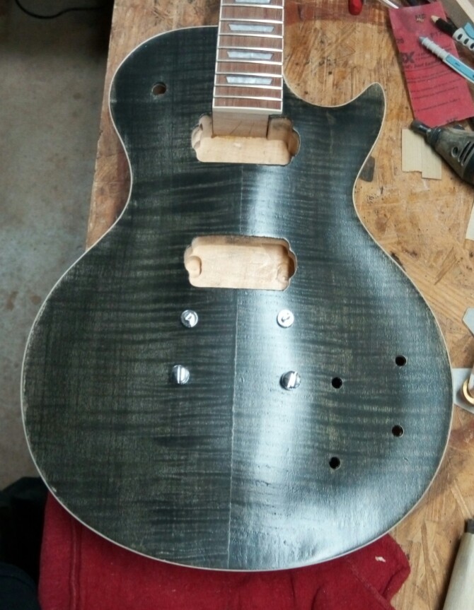

    Greetings from the USA. Here's my 1st Pit Bull kit in progress.
    I've built kits before, as well as scratch builds and "parts guitars". I am always keeping an eye out for quality kits at reasonable prices, and so far I'm not disappointed with this one.

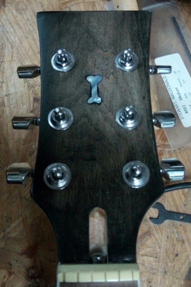

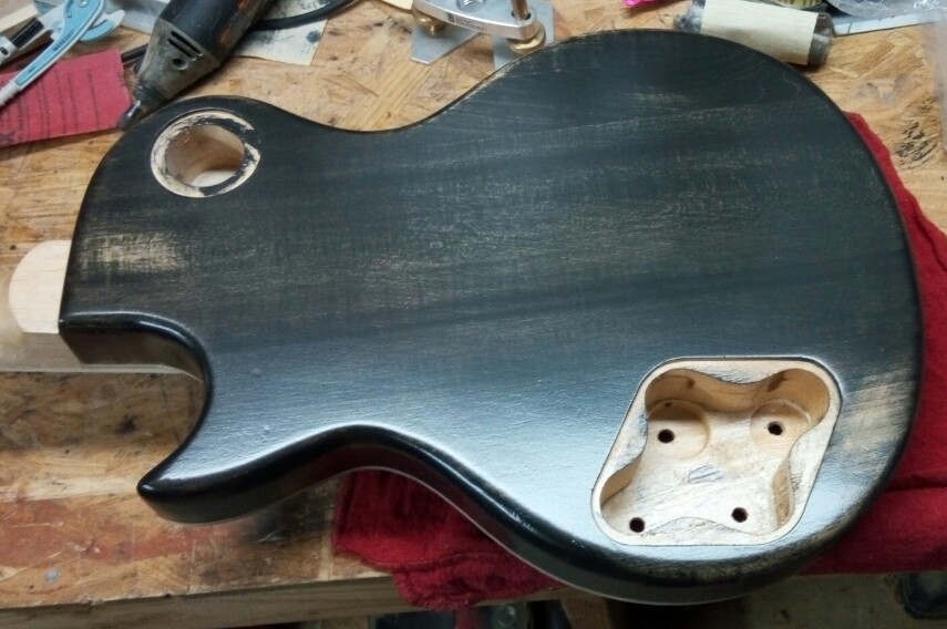

    I've gone for a weathered/distressed look here (a frequent theme of mine). The color is Varathane Ebony stain. To get the look I was after I applied the stain, let it set 5 minutes or so, then wiped it down with mineral spirits to remove the excess, revealing some great contrast on the top, and a worn look on the back, sides, and headstock. Dog bone inlay on the headstock is mother of pearl. After gluing the neck the whole guitar was sprayed with 9 coats of rattle can nitro cellulose lacquer, satin finish.

    That's nice Captcrank, really like that see through effect you've pulled in with the stain. Great Job!
    Looking good man. The flame has popped very nicely indeed!
    Welcome CaptCrank
    Wow, really cool guitar - welcome
    give the dog a bone CaptCrank nice work
    mmmmm dark goodness!
    Thanks everyone. I'll post pics of the finished guitar once completed... Soon... Maybe.
    A little more detail about the build to this point:
    When I first test fit the neck there was some significant lateral movement. Hoarder that I am, I found some very thin cutoffs of poplar from my last scratch build. After trimming to fit the treble side of the neck tenon I glued them up and left clamped overnight. Then, little by little I was able to sand these shims back until I got a nice fit.
    The most time consuming part was, of course, spraying the lacquer. Per the label recommendation, each coat was sprayed at least 30 minutes apart. I soaked the cans in hot water (120-130° F) before spraying and between coats to keep it from spattering in my cold garage. Before entering the garage to spray I donned an appropriate respirator because I like breathing. Vent fan in the window and the cat flap opened to provide a draft, the odor never entered the house. So it was respirator, go spray, return can to hot water, set timer, play GTA V until timer was up, repeat. That was Saturday in a nutshell.
    That said, I've got appx 10 hours in this so far. From experience I estimate 3-5 more hours to wire it and dial in the setup. Probably Saturday...
