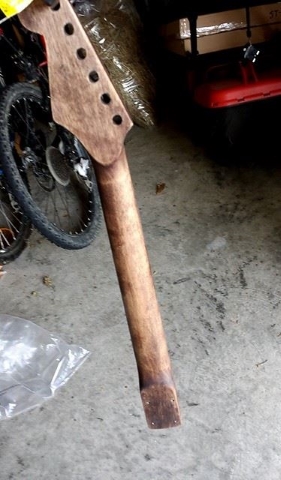

    Preparing the headstock took by far the longest and was the most painful process sanding wise. I chose to go for Fender's modern strat headstock profile. This was jigsawed out of the wood, and then sanded with 100, 180 and 240 grit sandpaper before reaching an acceptable stage.
    The body and neck were sanded with 100, 180 and 240 grit sandpaper. I used an electric sander for the 100 and 180 grit passes of the body as I had spent about 3 hours sanding the neck and headstock that day.

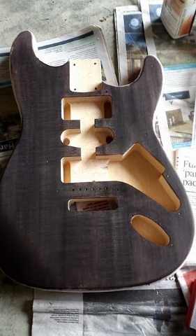

    The first coat of dye was applied the following day. I used two coats Briwax's brown mahogany spirit based dye for the neck and body, sanding with 240 grit between coats. Here is the front of the body after the first coat.

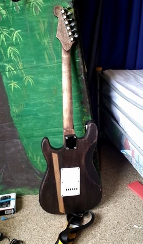

    I felt that having the entire body dyed dark was going to be a little uninteresting, and I added an accent line of bare wood to the back (you'll see it in the finished pics)

    The next morning, both body and neck were sanded with 240 and 600 grit sandpaper to make them smooth and remove any sticky spots. This also gave the distressed effect that's visible in the final pics.

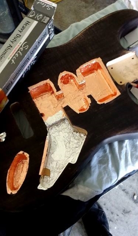

    After the buzzing horror that is my P-bass-ish (I got radio through it once, not my preferred station though), I wanted to ensure that my new guitar would not have the same issue, so I bought DingoBass' shielding kit and went to work creating a Faraday cage. Unfortunately I ran out of copper tape, and couldn't be bothered to wait for the extra tape promised if it was not enough, so aluminium foil and a glue stick finished the cavity shielding. Picture is of the mostly finished shielding. I also added a layer of aluminium foil to the back of the pickguard that makes contact with the overlapping edges of the cavities (I'm not sure if this is necessary but I'd rather over-do it than under-do it).
    From here it was easy sailing, putting screws in the right places, stabbing myself with a screwdriver while trying to get the trem springs in place before realizing I could loosen the screws and using a soldering iron that refused to heat the tip, and only did the sides.

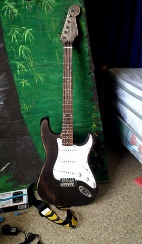

    Now that it's all together, I think it looks great!
    Plays like butter, other than the one fret that's high, but it is only an issue across the first three strings (E, A and D) and the last three play fine, any ideas as to why that is are appreciated.

    Nice job Greg, especially on your budget.
    Setting up the trem is a bit of an art in itself, getting the right height for each string and intonation. that could add to your buzzing woes.
    one of the cool things about this kit, is that its easy to pull apart and modify etc. I always to the frets on mine and the only special tool I have is a notched straight edge to check the straightness of the neck. Thats the first step.
    Once the neck is straight, I use a set of stanley knife blades (different sizes) as fret rockers to check the heights of the frets, I mark high with black and blue with low. Then I level the frets with my fret levelling beam (which I made with a straight aluminium bar, double sided tape and good 240 grit sandpaper). Then I crown the frets using masking tapes, my small files, 240 grit and some steel wool.
    Heres a video a fellow posted on Youtube about fret levelling. https://www.youtube.com/watch?v=PDy7cF255dY
    Good Luck
    Tasty, very much like that distressed feel you've pulled off there. Great work man!
