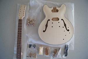

    The ES-12G kit arrived in great condition, thanks Aust Post, and thanks to all at Pit Bull.
    Three start up questions ...
    1, To check neck pocket machining, with outer strings running from nut to bridge it looks like I'll have to fully insert the two serrated pegs that locate bridge. Is this correct and is it OK to fit and remove these bridge fixing pegs, or are they a one time only fit?
    2, I've used a building strength glue called AV515 with amazing results. Any comments on this product (or recommendations) to glue the neck?
    3, This guitar is for my wife and therefore her call on finish. She wants a simple "satin oil" finish the same as on her Seagull Merlin and my oiled ash Strat. Any recommendations on the product choice?
    She wants this guitar to be a work tool, not a case queen so I'm thinking of following Paul C in his Rc-4 build thread and glue the neck before any other work. Any comments on this appreciated.
    Hi Corksniffer, good questions. Kit looks great. The bridge bushes will be hard to remove if you drive them all the way in. Just push them in by hand should give you a good indication of the neck/string alignment.
    To glue the neck use Titebond should be available from your local hardware or the big blue shed sell it
    https://www.masters.com.au/product/9...ood-glue-473ml
    Up to you if you glue the neck early in the build you need somewhere to hang the whole guitar to cure and will be more awkward to work on. Generally you will get a better finish on the neck/body join.
    There are wipe on satin poly products, some forumites have had good results from linseed oil. I haven't used either so can't really comment.
    Good luck with the build !
    If you are going to glue the neck soon check the string action will be ok, allowing the bridge will be prouder than when finished

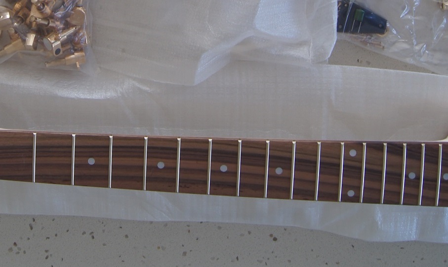

    Sweet! Another ES kit to watch. I like the grain pattern in on the fret board.
    Yeah, I like it too
