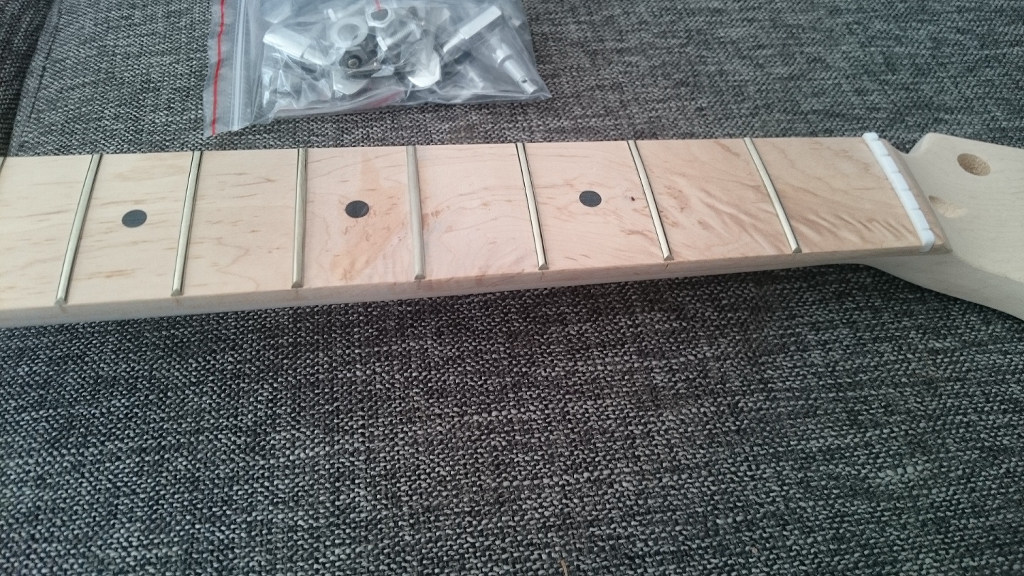

    Got to mock up build stage at last. The neck would seem to be a good fit to the neck pocket - when treated wit TO should be a nice tight fit. Nice straight neck too with a fun grain on the fretboard.

    I am seriously impressed with the grain on that maple fretboard Arzi....nice score.
