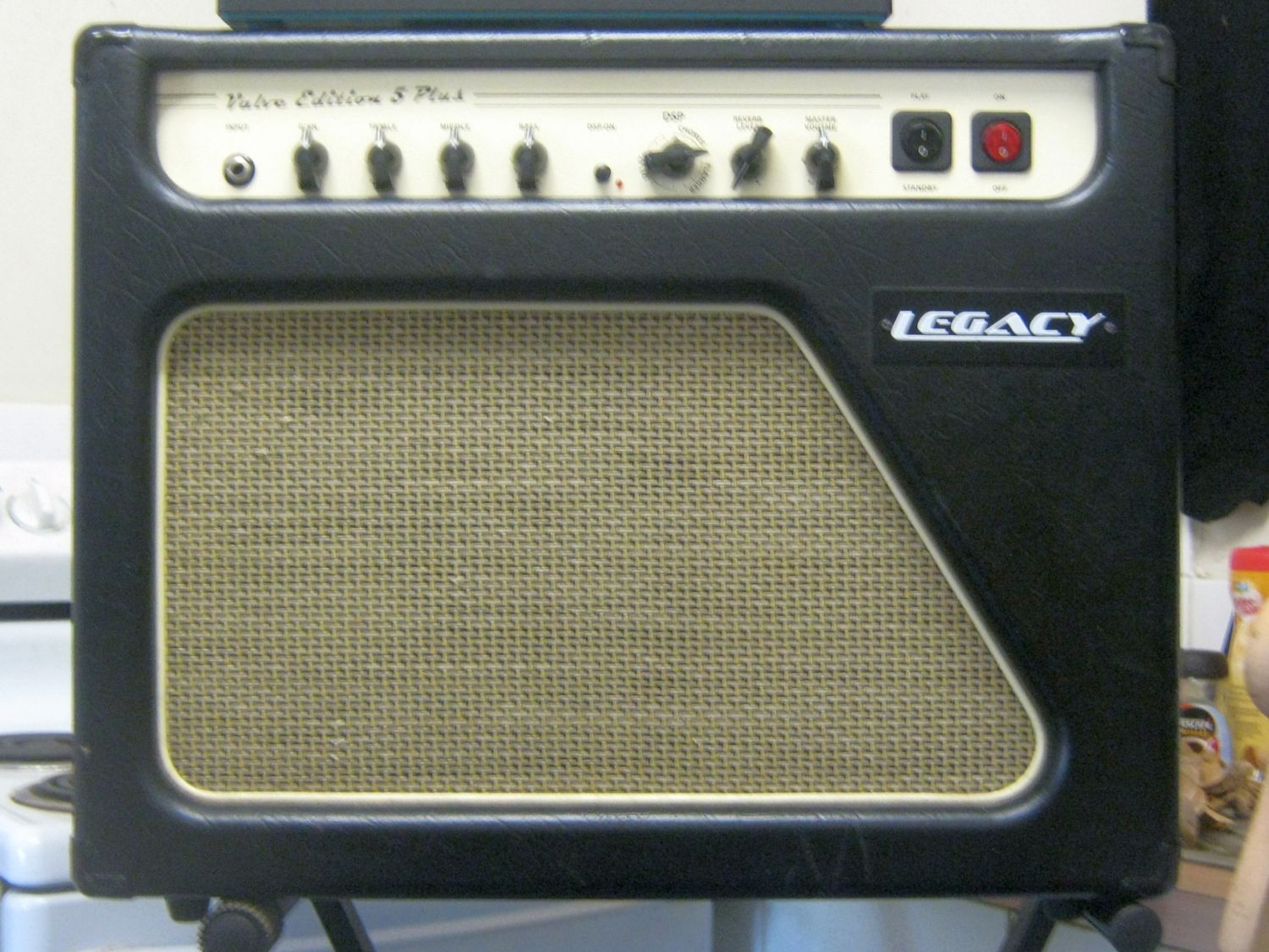

    I'll post a pic of the amp shortly soon as I can take a good pic with my digital camera.
    Here we go:

    My Legacy amp uses two 12AX7 preamp valves and one EL84 power valve to generate about 5 watts of audio power, when I got the amp back home from uni, I decided to swap out the stock speaker for the Jensen C10Q speaker (luckily they were both 10 inch types) that was in my Peavey Backstage plus amp, I'm going to be buying another brand-new Jensen C10Q later on this year for the Peavey amp anyway, swapping out the speaker made a big difference to the tone of the Legacy amp, I'll see if I can make a demo recording of it later on once I get my condenser mic back from uni.

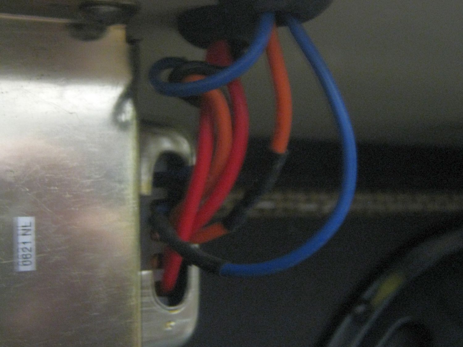

    Firstly here's a closeup pic of the repairs I made to the amp's power transformer, there were two orange wires and two blue wires that had white plastic inline fuse holders, these fuse holders were broken so that the fuses fell out, you can see where I have placed some black heatshrink insulation on them, indicating where the fuse holders were originally, this restored normal operation of the amp, and it has never given me any trouble ever since, it's been a very reliable amp so far:

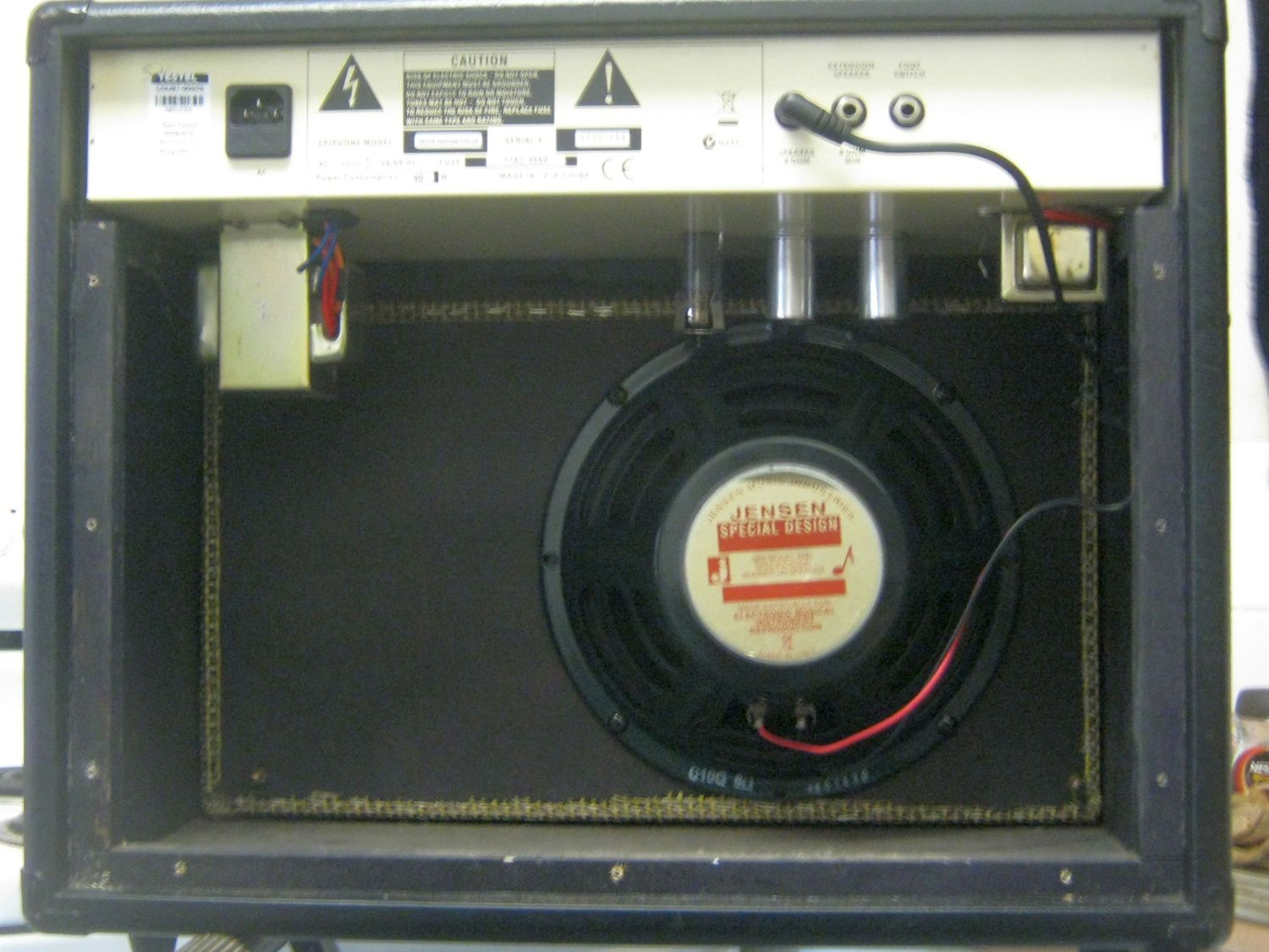

    Next is a pic of the insides of the amp's cabinet, you can see a small gold-coloured object to the right of the two silver cylinders, that's the output transformer, I'm thinking of swapping it out for a bigger one since these small output transformers tend to have a limited frequency response, and also tend to be not as efficient, still, it seems to work okay with the 8 Ohm / 35 Watt Jensen C10Q speaker I put in it, which definitely made a big difference to the tone of the amp:

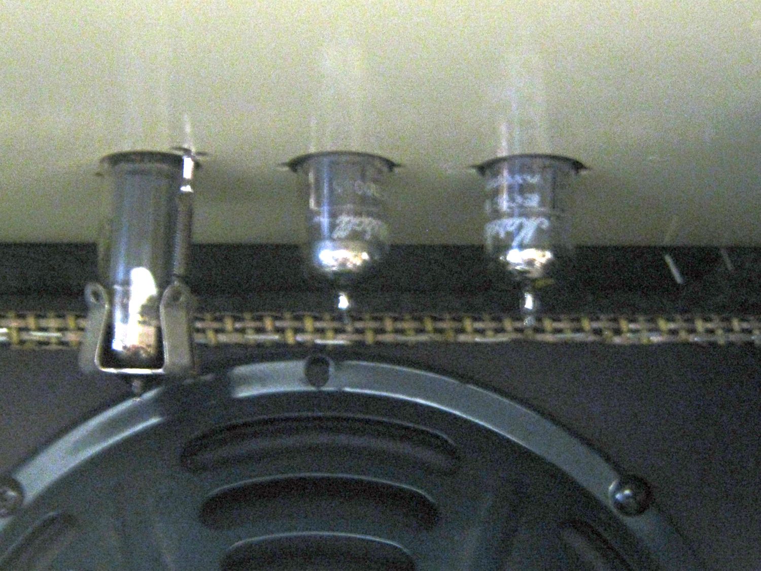

    And lastly, here's a closeup pic of the three valves that are installed in the amp, the two smaller ones are a couple of Marshall ECC83 valves, while the larger one is a Russian made Sovtek EL84/6BQ5 Power Pentode:
