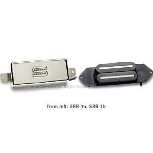

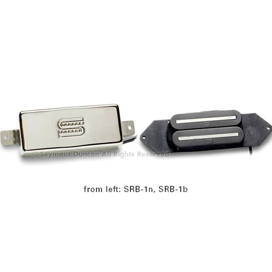

    Alternatively there are plenty of cheap Ric 4003 substitute PUP's such as these on eBay ... http://www.ebay.com/bhp/rickenbacker-bass-pickup
    or others that look like these...
    Thanks Waz. Yea I figured it was weird that SD recommended a guitar pickup for that reason too. I figure that the cheap ebay pickups would be the same as what the kit comes with or certainly no better. I will wait and order the kit and find out what size they are, they look like they fit in a standard humbucker mounting ring, not sure if any other bass pups do. And I want chrome covers like the originals
    Looks like the Ric SD's might be the only way to go if you are chasing chrome covers
