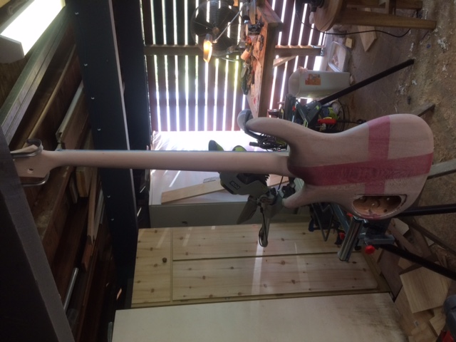

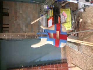

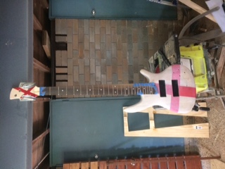

    This is my fifth build but my first attempt at building a bass.
    I have noticed a few comments about staining. Some saying the stain wont take or takes too well. One thing I've learnt in my past builds is sand, sand then sand some more. If the stain isn't taking, it's probably because of glue residue and nothing to do with the timber, so sand, sand, sand.
    I usually start with 180 grit and work up to 1200. I don't see the need to start any lower unless the finish is complete shite. You'll find a nice smooth finish before staining will reduce "bleeding" and produce a much more even colour.
    That said, here's my latest attempt. I made a few stuff ups along the way but nothing past experience didn't help me solve. The first minor stuff up was breaking one or two of the neck screws off during the mock up. (Sorry Adam, but your bolt on neck is now a set neck )

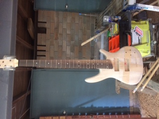

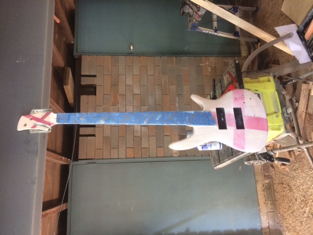

    5 String Bass
    Thanks Mate. It's great to hear your feedback Waz

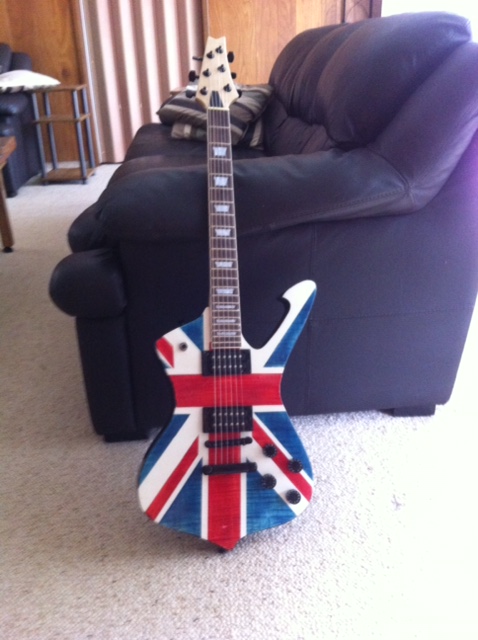

    My first experience with basswood was a shocker. The body was complete rubbish (in terms of finish) and the neck wasn't much better. I ended up doing some solid colours to cover up the mess. If I can find a pic I'll post it. (It's an Iceman shape and now has a set of Seymour Duncan Alnico II Pros instead of the pickups that came with it.)
    On this project I've only gone as high as 400 grit so far as it sanded up really nicely. Some of the red bled a little but nothing too dramatic. I've gone over the whole guitar with a white limewash. It looks a little "ghostly"?? and makes the red look faded.
    I'm going to finish in a few coats of clear and then buff it off to get a more satin finish.
    One thing I'm not sure of is the pickup wiring on this one. Most setups I've done have an active and an earth from the pick up. This one has 3 wires. The only 3 wire pickups I've done are actives (EMG's and the like) so any help, words of advice will be most graciously accepted.
    Anyway, I'm off to "The Shed" to do some more on this beast and a few other projects I've been assigned

    I only had a quick look at the pups to be honest. I'll have a better look when the time comes to do the hardware.
    The iceman came up really well in the end. With the new pick ups it sounds amazing especially with a bit of overdrive (well maybe a lot) it will sustain for days.
    (My wife says she can see a British/English trend developing and thinks I'm secretly plotting to go back home for good. The last build was the Union flag and now an abstract take on St Georges Cross?????)
