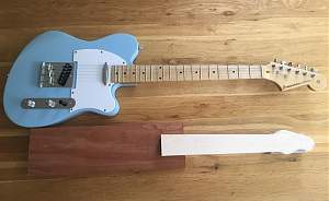

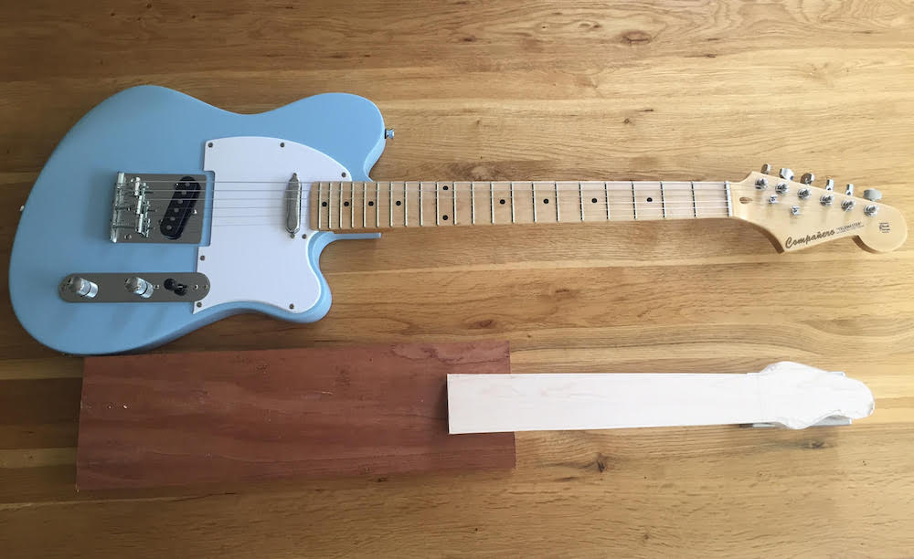

    And now I’ve roughly chopped them up as 45cm lengths. Next step will be slowly but surely shaping the neck (the heel of the neck effectively starts at the 8th fret, and then joins from the 9th to the 13th fret) - I did consider some kind of hinge, but it got too complicated. I’ll be installing frets direct to the rock maple, no cap. I’ll also be doing without a truss rod, my theory being that I’ll only have it strung up under tension for an hour or so at a time – but we’ll see how that works out! The pic gives you a rough idea of how it compares to a regular instrument.

    Oh, and the body will be shaped a bit but I think I’ll make something that will act as a thigh rest for it – maybe out of an aluminium bar that will slot into holes on the side. Other things going through my mind are a 4+2 headstock and perhaps a single humbucker that I can split.
    One more thing I’m thinking is to use a locking nut and a slotted bridge. That way when the guitar is disassembled the ball-ends of the strings can be just pulled out of the bridge, and the locking nut will keep everything in place until the next time it’s used.
