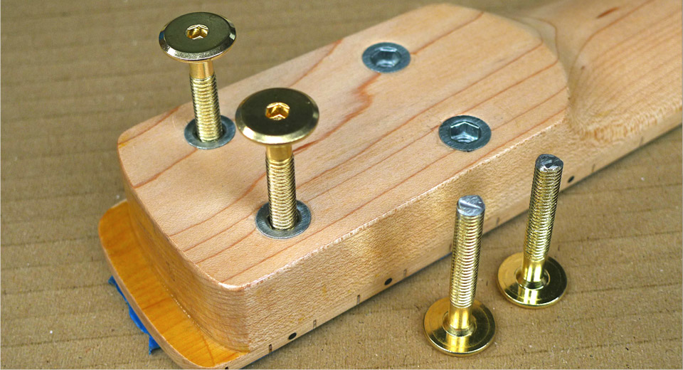

    I also got some of the electronicals. (I purchased this from elsewhere, so I hope Adam doesn't mind me posting a picture?) I did get everything else from Pitbull so far. I am further exploring neck mounting ideas right now and I plan on using threaded inserts and ferrules instead of a neck plate which I am yet to purchase.

    Inserts like this?
    I usually use 2 push pulls so each humbucker can be split individually, not much extra cost so why not?

    Yes Joe, and also Ferrules into the body instead of the neck plate and take a angle cut off the edge of the body and bring one of the holes in a bit. Similar to this maybe but then with the inserts?
    http://www.buildyourownguitar.com.au...?t=2469&page=3
    It's a bit of work with little gain, but I like the challenge and the look of it having the detail instead of a simple kit build this time around. also this time around with this bridge, I need to do string ferrules anyway, so that will be a slight challenge in it'self anyway.
