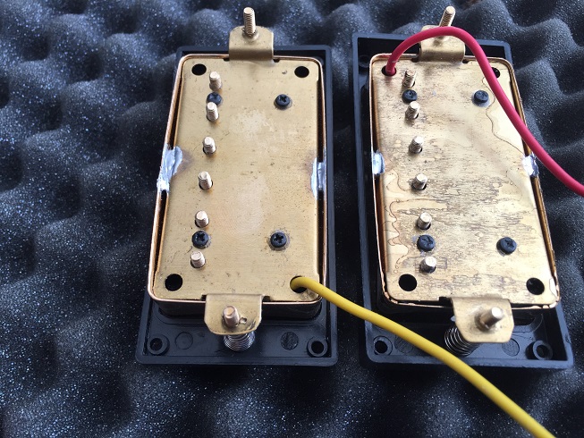

    (Does it matter which way the screws in the pickup are facing, other then the looks?)

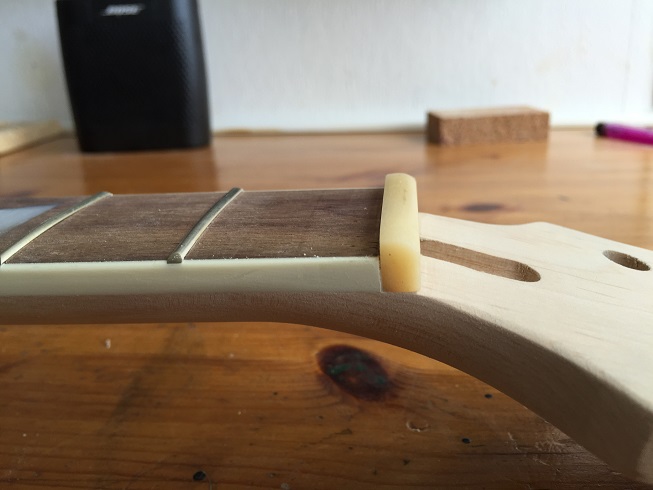

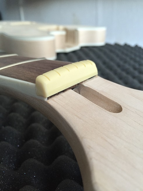

    I Don't like the way the nut is glued on.
    One side is standing on the binding, the other side is not.
    I need to find a way to fix that...
    Hi Eric, your build diary is here!! Nice kit score bro.
    As for your question, Does it matter which way the screws in the pickup are facing, other then the looks, I belive the answer is yes, but i'm happy to be corrected. It has to do with the phasing of the pick ups, ie which way the north and south of the magnet in the pick up are facing. Usually both pick ups will be the opposite way that you have in the photos (ie screws outwards), but I check my pick ups with a compass before fitting them. If the pick ups are mounted out of phase when you select the toggle on both pick ups the tone will be thinner.

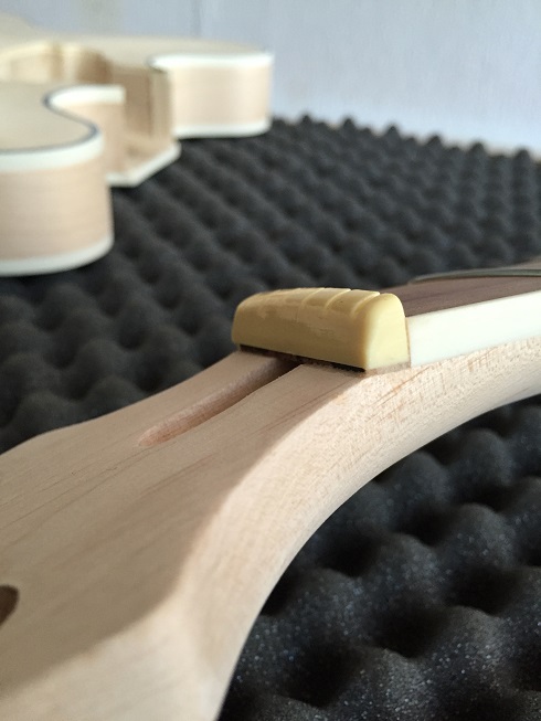

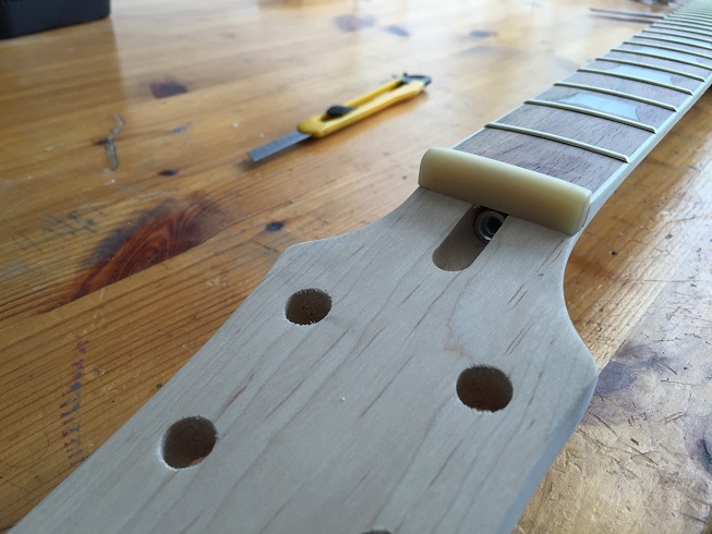

    I cut a little between nut and fretboard with a thin knife and gently tapped the plastic nut till it came off.
    Clean brake, should be no problem to replace it.

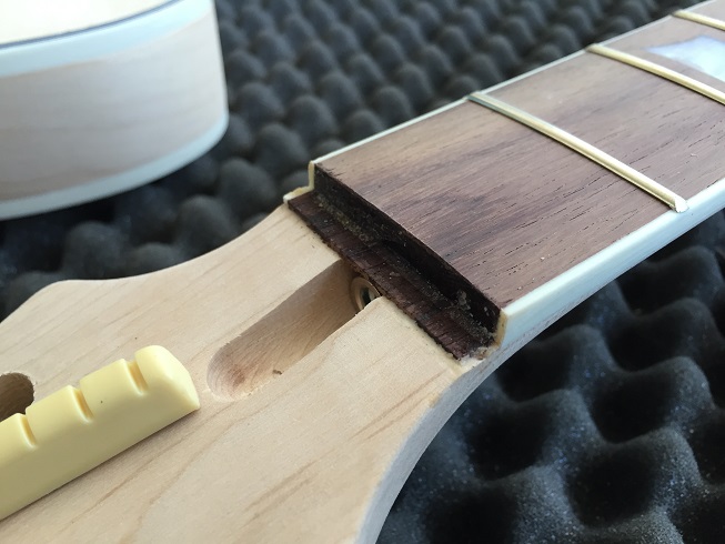

    The nut was standing on a small piece left of the fretboard, but it was not long enough so there was a little gap between nut and headstock. I hated that, so not replacing it was not an option.
    And because the cutout on the fret board was at an angle, the binding on one side was so thin it broke away, also leaving a tiny gap.
    I have ordered a big bone nut blank so I can cut a new one.
    Should be here tomorrow.
    I am going to cut away the thin fret board piece so I can mount the new nut directly on the neck wood.

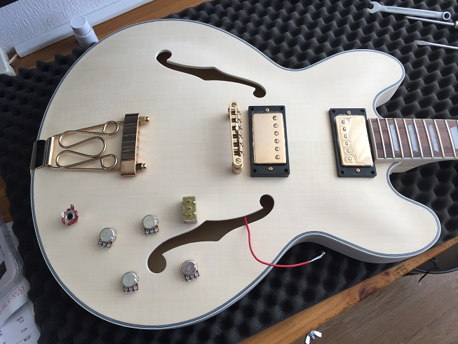

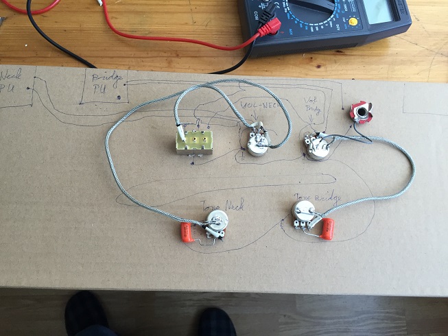

    When I got tired of the sanding I started on the electronics.
    Had some braided shielded wire and also a pair of orange drops capacitors from a previous build.
    The wire was not enough to finish it, but more is on its way.

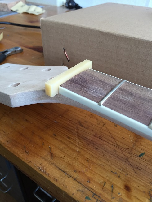

    Cut it, roughly shaped it and glued it on.
    Have to wait till my fret files arrive, then I can cut the slots and see how much it needs to be rounded more to the headstock.

    Certainly not the best looking nut job, but its my nut and I think its a big improvement.

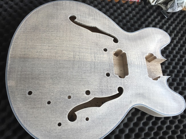

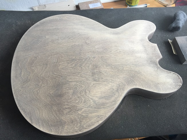

    Time for an update.
    Used a darkened grain filler on the neck and body.
    Sanding again....
    The back really came out nice.

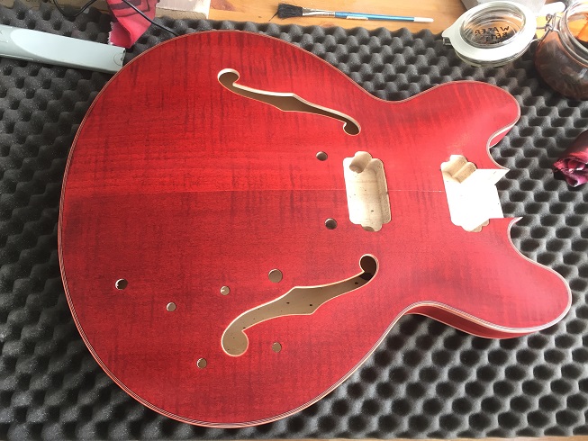

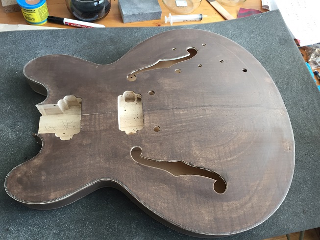

    Applied some stain, the top did not show the amount of flaming I had hoped for, but I am pleased so far.
    Here its still wet.
    One side did came out a little darker then the other, but its not that big a difference like it shows on the picture.
    But there is a thin line where the 2 halves are glued together that will not take stain.
    Tried some more sanding and the wire brush trick but it only got wider.
