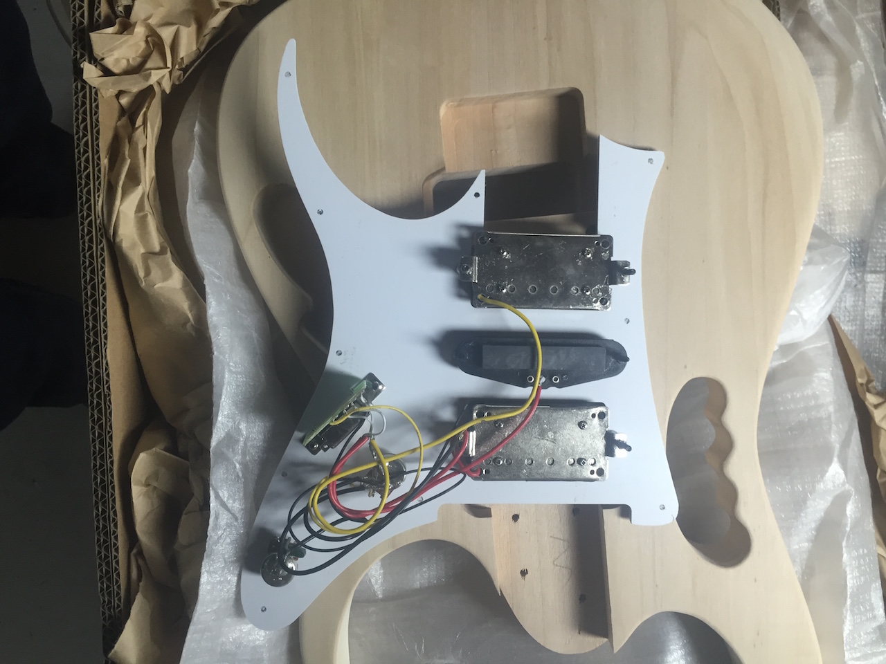

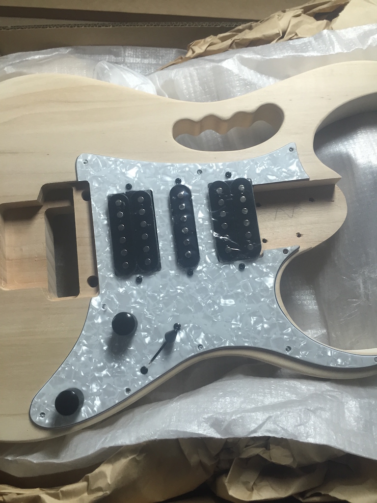

    This is how it arrives Badge,
ID:	13218 Click image for larger version.
    as woks says it is a std 5 way set up.
