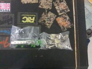

    Guess what just got delivered right to my front door?......my sanity..lol...j/k......yes, the new set of Tuners and Nashville bridge, will post an unboxing pic shortly....stay tuned.
    The new Tuners and Bridge unboxed:Click image for larger version.
Name:	The New Bridge And Tuners Unboxed_Resized.jpg
    There's only one small problem with the new bridge, the threaded bushings are too small in diameter to fit in the original bridge post holes so I have two options, either fill the holes with dowel and re-drill them to the correct size, or, slightly enlarge the post holes on the new bridge to fit the original bridge posts, I have some Titanium coated drill bits so I might just do the latter, on the other hand the new tuners look like they should just drop right in the holes on the headstock.
    Update 2:
    Just found out that there's a much simpler solution to the bridge post hole size dilemma, the new bridge has two smaller threaded inserts and they are just small enough that I can simply gently hammer them into the larger threaded inserts.
    Update 3:
    The new tuners feel alot better than the original ones, exhibiting minimal Tuner Backlash, and will fit the holes on the headstock but I'll have to slightly enlargen the holes so that the new ferrules will fit.
    And all the mounting holes on the new Tuners all line up with the mounting screw holes on the back of the headstock.
    I'm happy with that.

    Just as I was in the process of re-stringing and tuning up the SG in order to do a quick before mods recording one of the original tuners broke and was rendered useless, the tuner felt very stiff before it broke, basically what happened was that as I tried to turn the stiff Tuner knob the cream plastic knob broke off forcing me to install the new tuners sooner than I had planned to, oh well at least the original pickups still work.
    Since the headstock holes were a bit too small for the new Ferrules, I had to use my trusty calibrated Rat-Tail File to enlarge the holes till the new ferrules gently press-fitted into them, then I installed the new tuners, they felt much smoother than the old ones and were practically a Drop-In replacement.
