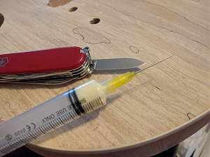

    OK! I'm back! Sorry for the long delay before this update. I've been too busy for forum posting lately.
    I ordered a glue injection syringe from Amazon and had it in two days, as usual. I decided that making a slit in the veneer would likely glue closed less noticeably than drilling a hole to inject the glue, so I started poking at the bubble with my pocket knife.
Name:	IMG_20160705_180552 (Medium).jpg

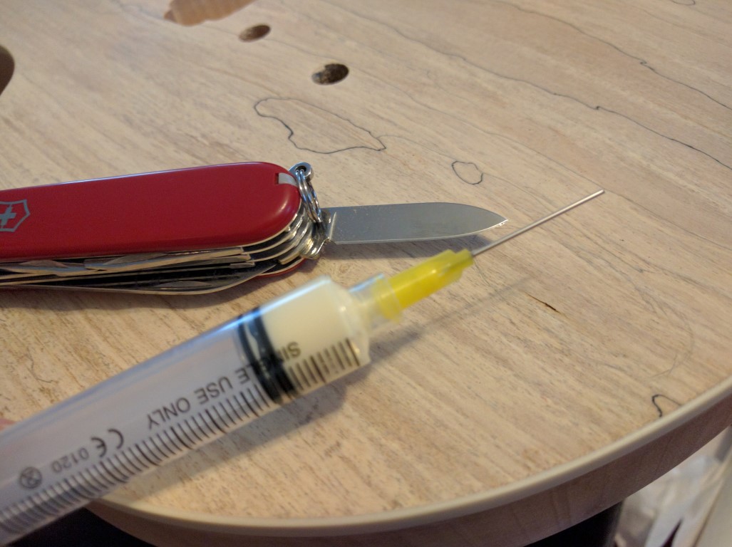

    I got the syringe loaded up and steeled my nerves:
Name:	IMG_20160705_180853 (Medium).jpg

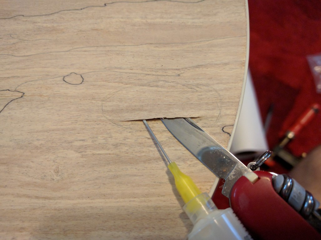

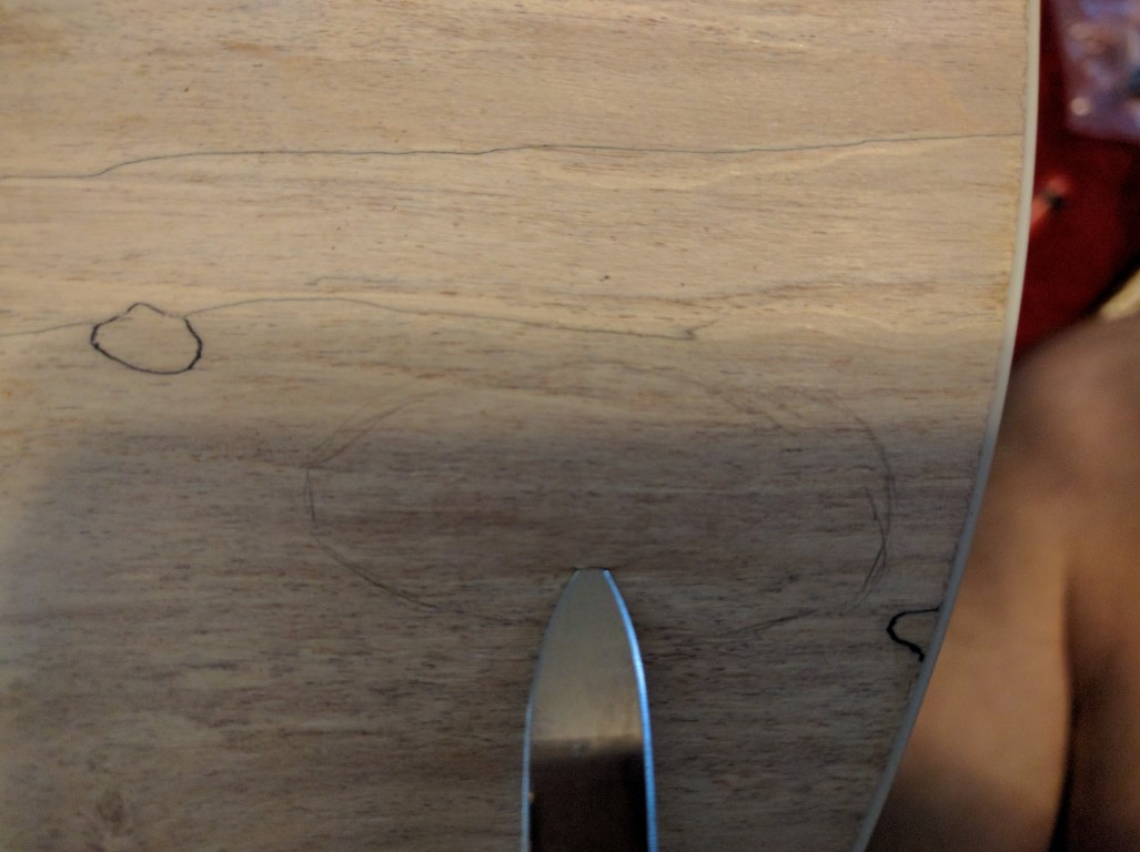

    I found that the little slit didn't give me much room for wiggling around the syringe to make sure I got glue all through the bubble, but a little twist of the knife got the veneer to split along the grain--much too easily, and almost too far. This was the nerve wracking part because I was afraid the veneer would just keep splitting. Luckily, it didn't get out of hand, and I felt like I got a good coating of glue in there.

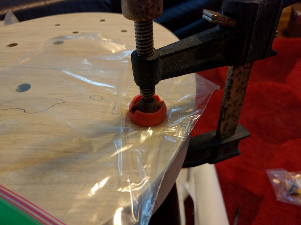

    Then I slapped on a plastic bag (to prevent sticking) and a clamp.
Name:	IMG_20160705_181412 (Medium).jpg
    And here's my mistake (luckily, a minor one). I didn't put any sort of block of wood to spread the force of the clamp. I didn't think I had the clamp very tight anyway, so I didn't think it necessary. But once the glue had dried and I removed the clamp, I definitely had a dimple in the veneer where the clamp had been. I've been busy with other projects, so I let it sit for a week hoping the wood would fluff itself up a bit if left alone, and I feel like it did (though it might just be wishful thinking). I finally sanded the area tonight and was able to sand out most of the dimple. The bubble in the veneer is gone, and I don't think what little is left of the dimple will be too noticeable.
