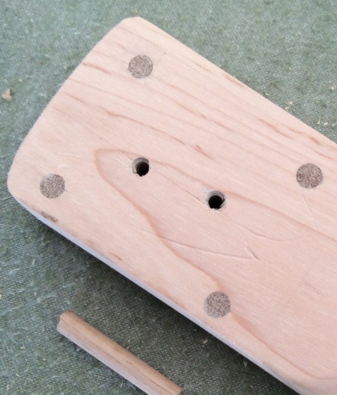

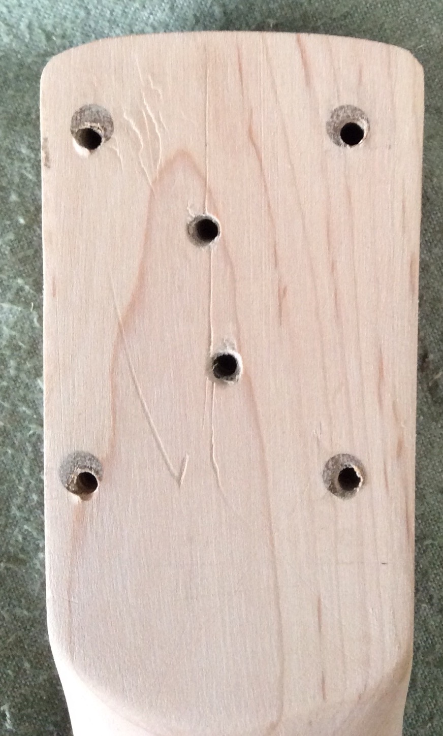

    Hi Marelton, easy remedy get some hardwood dowel rod. Plug the holes in the heel of the neck using Titebond II then follow Woks instructions above. Hopefully the video will help you align the neck. https://youtu.be/2LJczWsBcoM
    Thanks. That's great advice. Even found a video on YouTube specifically about plugging redundant or stripped holes in the neck.
    https://youtu.be/vgtgcIlFGrs
    I'll give it a try
    Recovered. Good tip Kimball, thanks

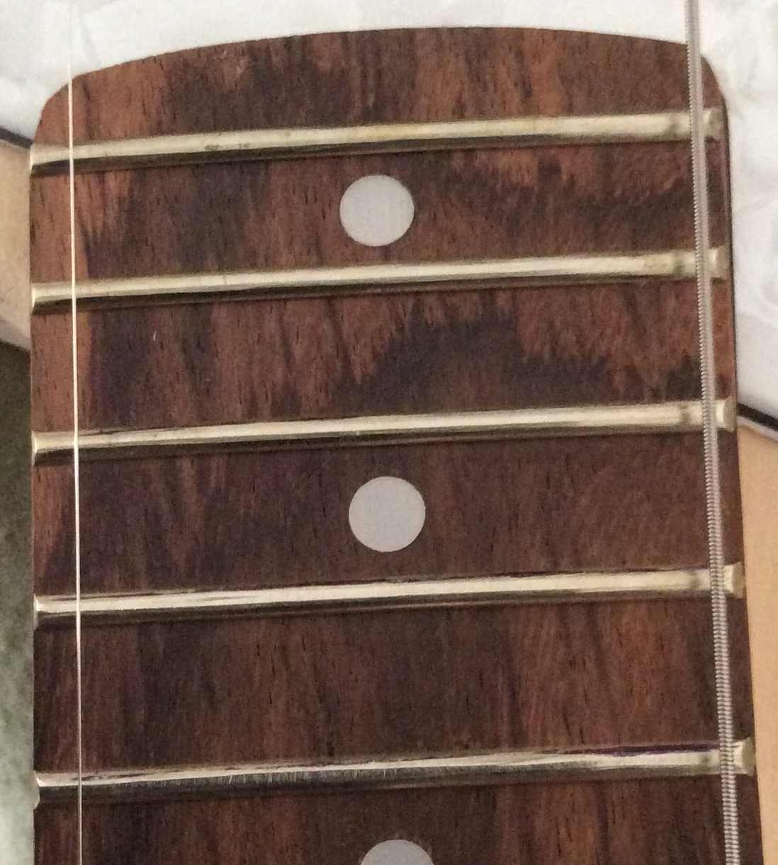

    No that far out, but enough to make a difference
    Maybe still could have gone a tad over to the left but looked pretty parallel.

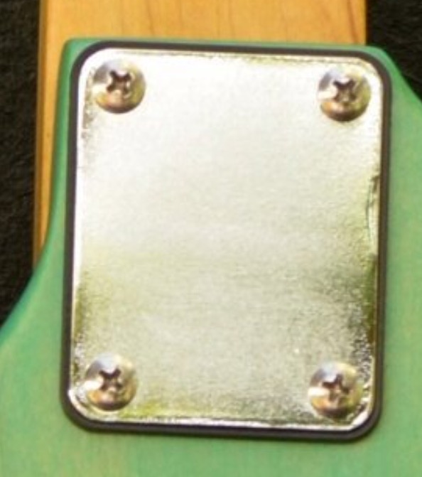

    Definitely a lesson learn.
    Thanks for all the advice
    looks like you saved it Marelton but make sure there is enough fret for the low E (heaviest) string. If you haven't drilled your bridge screws see if you can move it over so the low E string has more fret, provided that photo is taken from above
    I know exactly what you mean wokkaboy, the photo makes the condition look a lot worse than it actually is though. All holes are now drilled, dry build completed and body finished first coat of sanding sealer.
