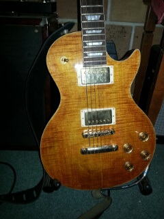

    here are picsClick image for larger version.

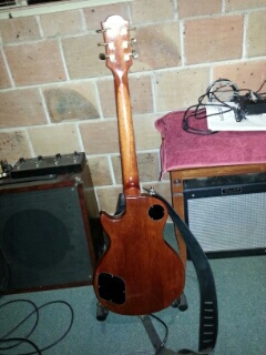

    more picsClick image for larger version.

    northern rivers
    41
    This wasn't a standard build. Tonerider alnico 4 type pups, CTS pots, aftermarket tuners, push/pull neck tone control for "Peter Green" out of phase middle position. I changed the tone caps for .10 instead of .022, so the full range of the tone controls were useful (great woman tone).
    And importantly, I took off the plastic nut. It wasn't cut very well. When I got it off I found it was hollow. That can't be good for sustain. I put a brass nut on, had to buy some nut files, but that was fine.
    One problem was lack of room for intonation adjustment. I had to reverse the 3 bass saddles and move them all as far forward as they would go to get close. After adjusting the truss rod and action, I was able to get slight excess room for adjustment on only 4 of 6 strings, but the others were close. I actually ordered a bigsby and locking roller nut, as the roller nut has forard and backward adustment at the posts. But I gave it to my son before it arrived.
