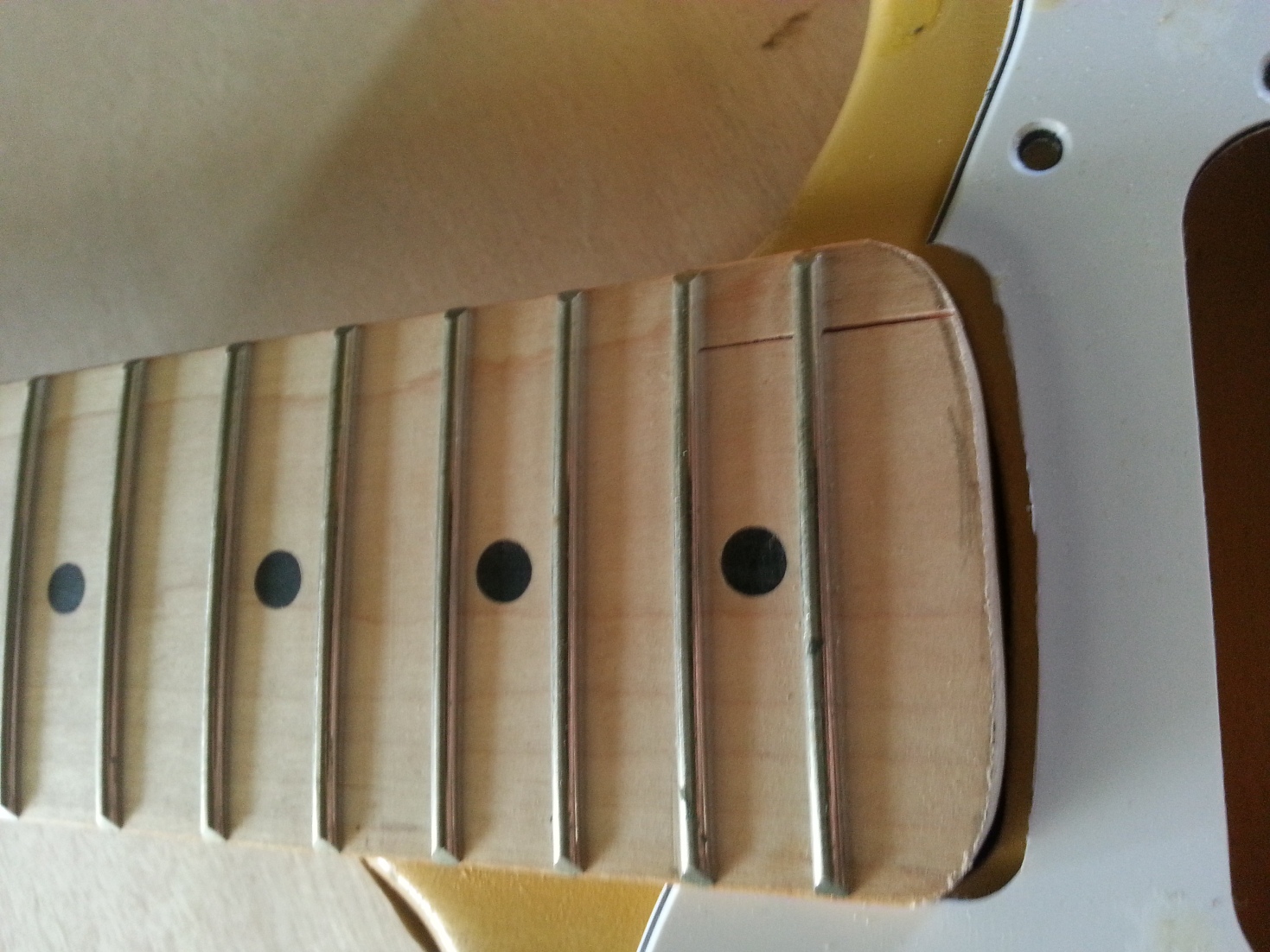

    DB, Hoping you would comment on this photo from my TL-1 build. It looks like a crack in the fretboard because there are matching lines on both sides of the neck. Unfortunately I didn't notice them before I put the first two coats of TO on.
    Do you thing this will be an issue down the road? I'm worried that the crack will expand towards the surface of the fretboard. Thanks for any advice.

    Hi Peter
    As for any possible repair, I am afraid not due to the fact the crack will have been flooded with poo oil.
    I hate the stuff for this very reason, (and countless others) because it makes the timber impervious to glue so there is no way of repairing any splits, delaminations or cracks in timber that has been treated with poo oil.
    How do I know this?
    Experience...
    Anyhoo, rant over...
    Send Adam an email so he can arrange a replacement as this clearly looks like a manufacturing fault.
    Must admit it is the first time out of over 4k kits sold, I have seen a PBG fretboard do this.....but I can see how it happened.
    If you look at the direction of the grain, you can see that it is 'running out' ie: not parallel.
    Normally with Rock Maple, this would not be an issue but as luck would have it, the fret slot just happened to run through a weak spot that has given way and cracked through. This is known as a delamination type crack.
    This probably wouldnt have been obvious when our packing guru sent the kit, the humidity change from West Aussie to Ontario would be extreme to say the least and the truss rod tension plus fret tang compression would have increased enough to make it open up..
    unlucky Peter, I'm sure if you get in touch with Adam he can organise a replacement neck.
