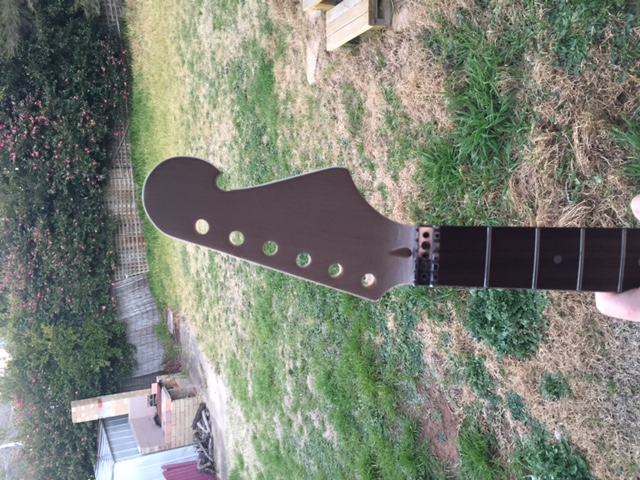

    Sep 2016
    Canberra
    15
    next step headstock design eventually settled on a combo of 2 of the designs I came up with, still fairly traditional in terms of strat design with a enough variation to make it feel like i had come up with something I hadn't seen beforeClick image for larger version.

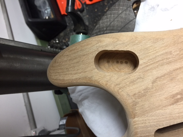

    Sep 2016
    Canberra
    15

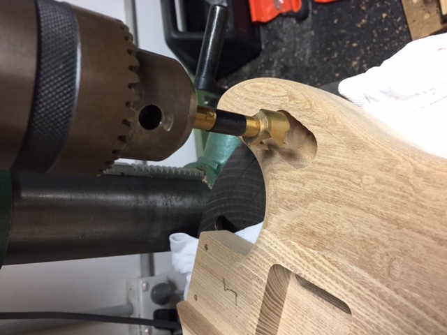

    so the next thing i did was routing a channel and drilling a hole for a 3 way toggle on the lower horn, my plan was to be able to use this guitar for playing Rage Against The Machine songs at an annual 90's music tribute night I've been involved in the last few years. My dilemma here was how to drill out the hole for the switch with out going right the way thru the body, after a bit of internet searching found out about forstner drill bits and it made light work of the job leaving a very clean hole, then borrowed a router from work to dig out the wiring channel and she was ready to move onto sanding and finishing the body

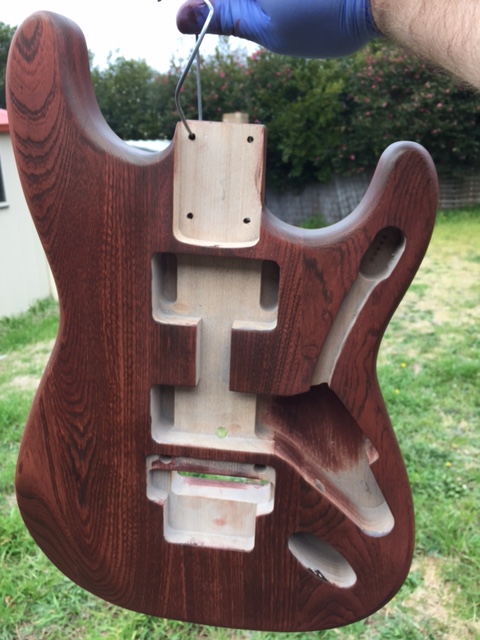

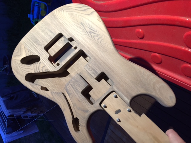

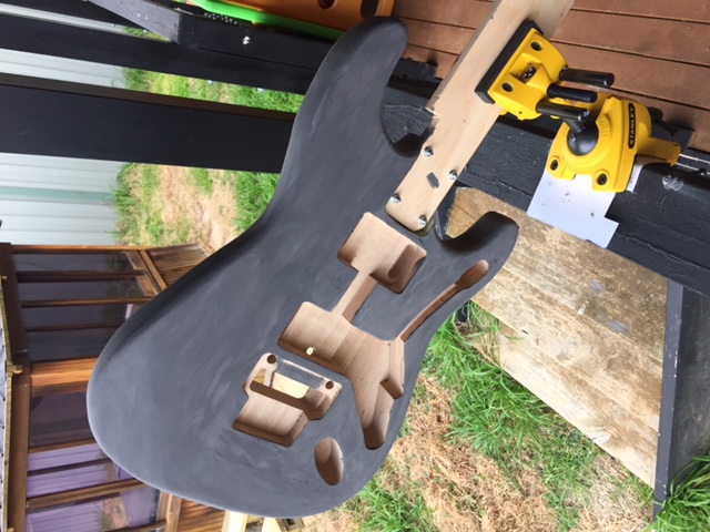

    Sep 2016
    Canberra
    15
    Next step was sanding and raising the grain as its an Ash body so I followed the tried and true method I found online of sand with 240 grit, wipe with wet cloth and repeat until the grain stops lifting, this took about 4 process repeats spread over 4 days until I was happy
    Next I applied grain filler, I went for an ebony colour as i planned to dark stain the guitar with a walnut stain and wanted the grain to really show through ,I let it dry for 24hours then began sanding with 320 grit, I put it on a bit thick so it took a bit of sanding but once I'd finished I was pretty happy, it looked and felt pretty well filled and I decided to risk it and move onto the next step of staining the wood

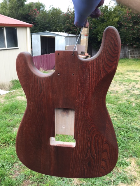

    Sep 2016
    Canberra
    15
    So I used Brown Walnut Colourwood interior stain from bunnings , I have actually already used this before on a re-housed amp head and I liked the colour as it had a bit of a red tinge to it and I already had a tin of it so thought lets give it a go and it came up looking really good i think
