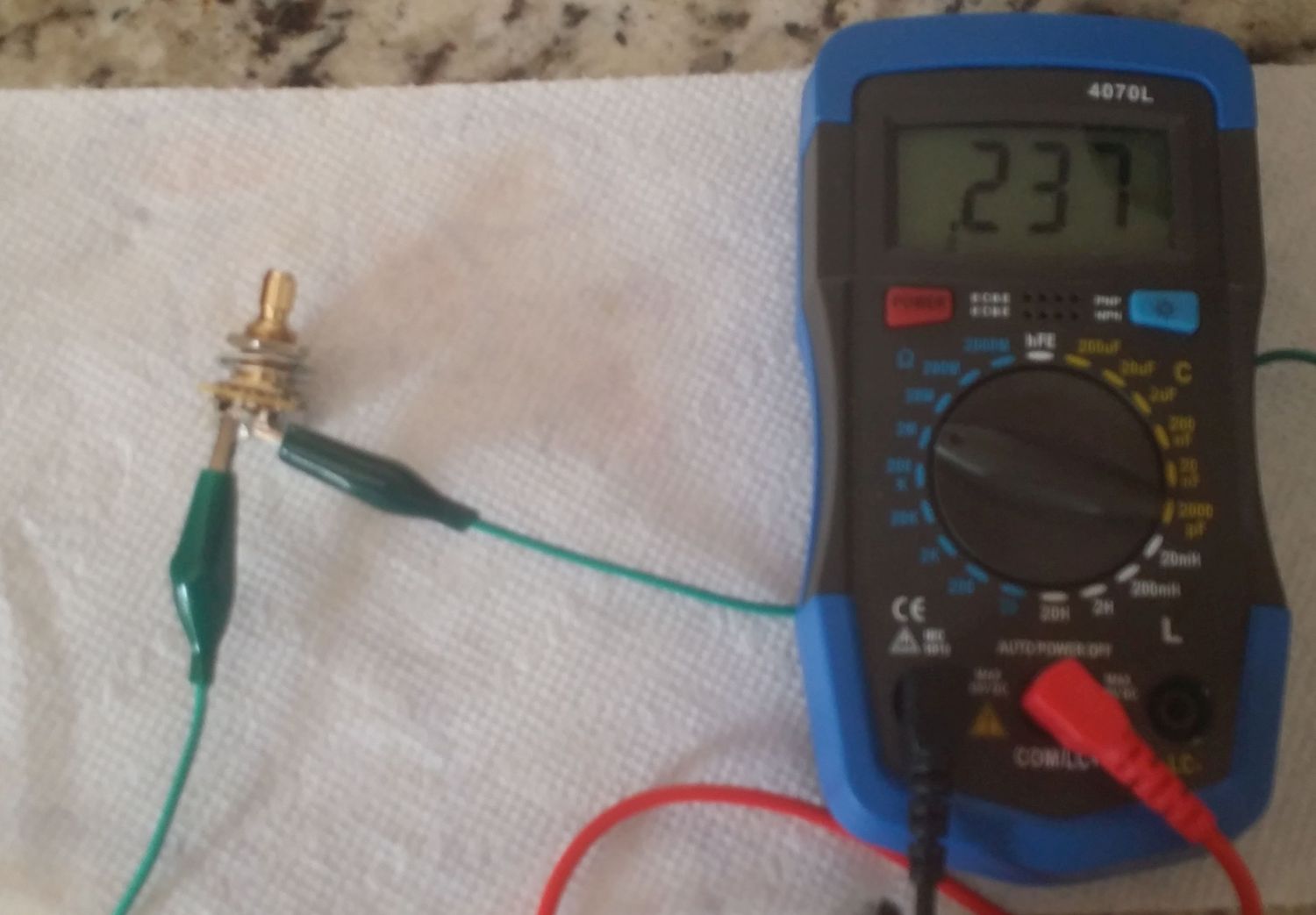

    The first of the pot I ordered came from ebay today, a CTS 250K Audio pot.
    It checked out as an audio (log) taper, and spec'd at 237K which is within 5% of 250K. I tested it with an audio source and could not hear any scratchiness. I know people have reported scratchiness with CTS pots here, this one seemed fine. I put the meter on the pot and tested for scratchiness after I put it back together. Did not seem the worse for wear. Not too scientific a test, but what the heck.

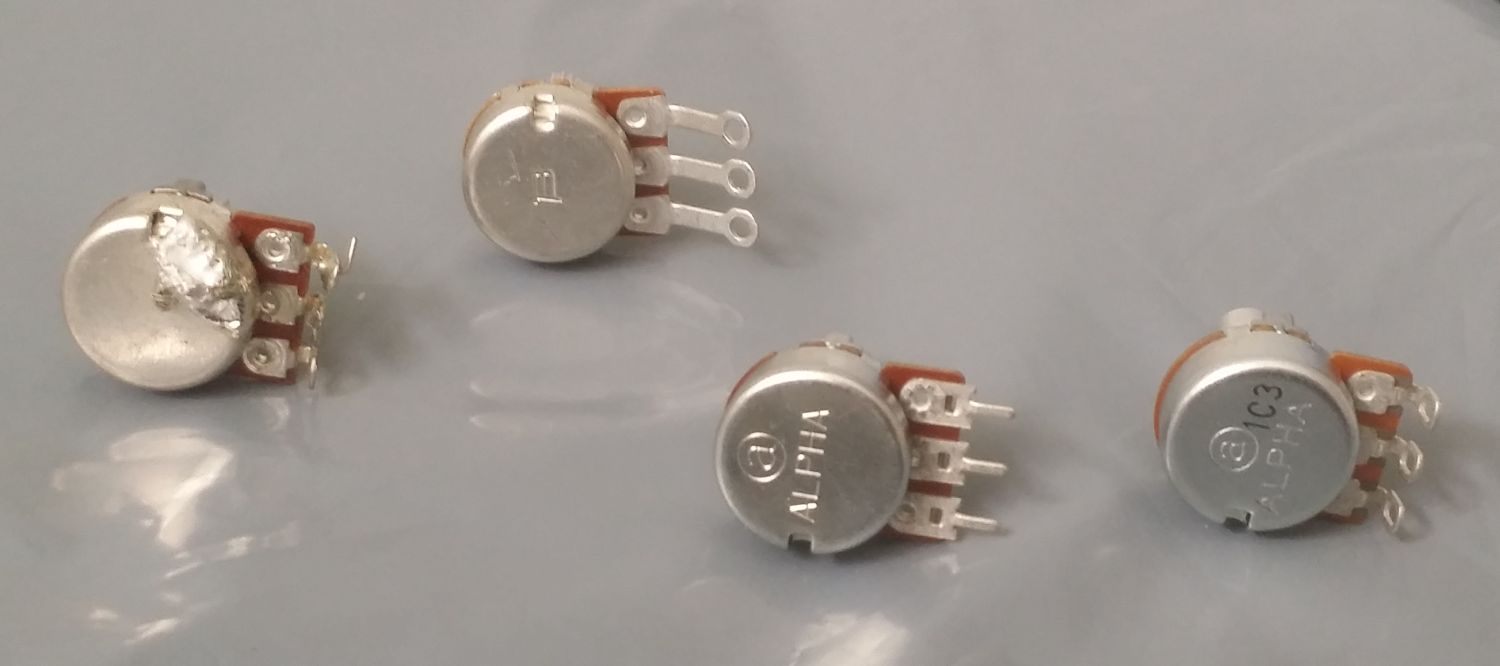

    I got a Bourns 500K Audio mini pot today. I had an Alpha mini (100K linear) in my pot bag. (That sounds druggy, should I have said potentiometer bag?). When I found it I also found a no-name mini that I pulled out of my Frankenjazz to put in push-pull pots. It turned out to be 500K Audio.

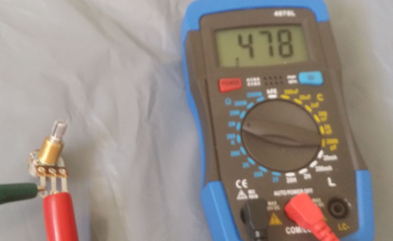

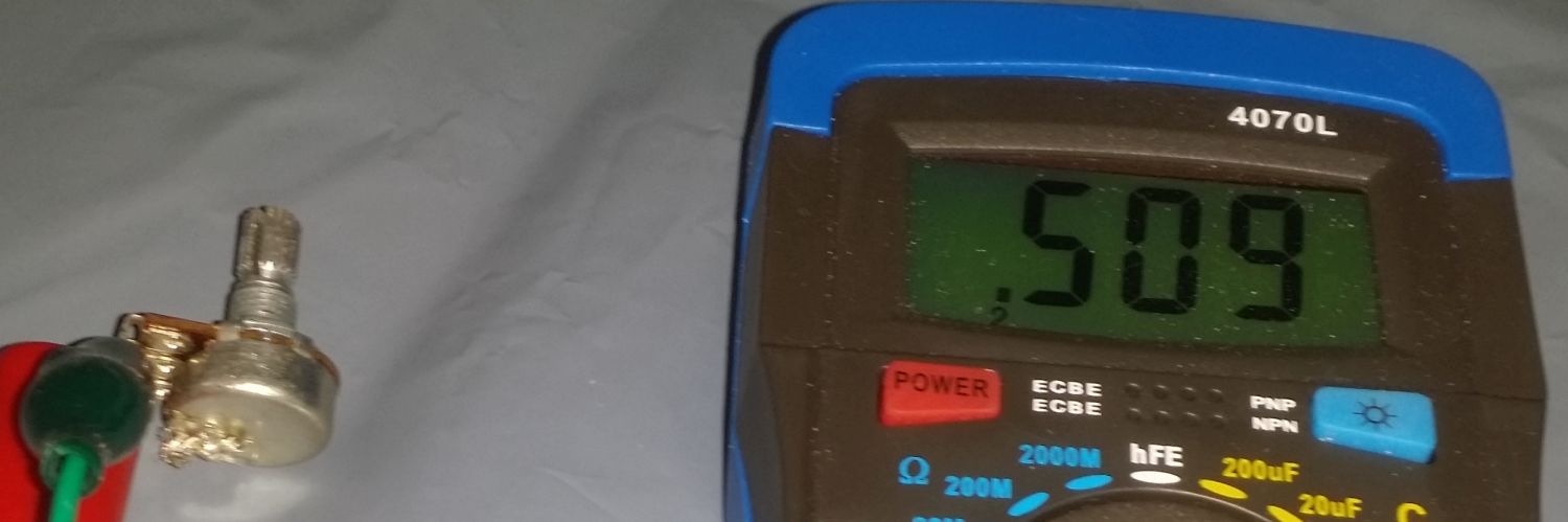

    Bourns went first. It spec'd at 478K, well within 10%. It had an audio taper just like it was supposed to. No scratchiness when hooked up to an audio source.

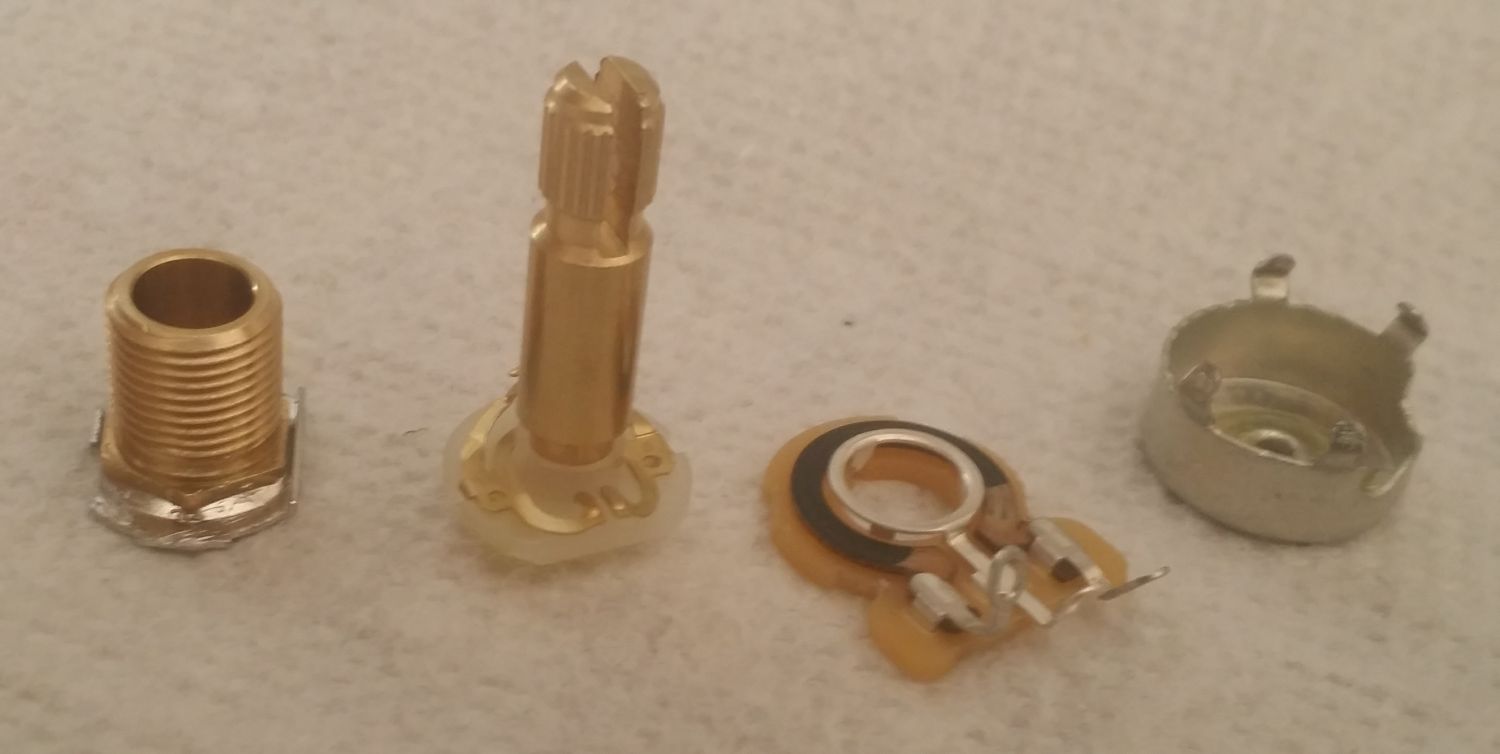

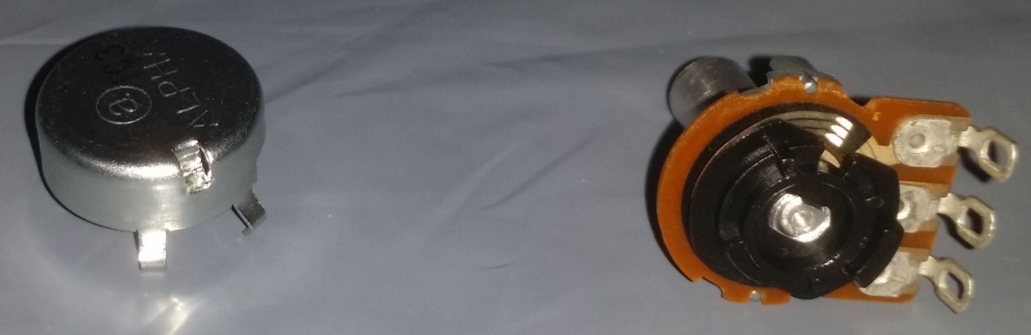

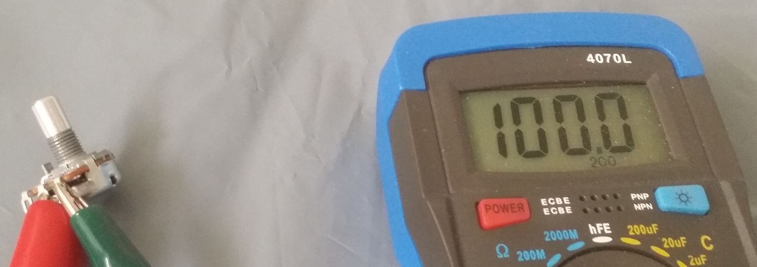

    The Alpha spec'd closest to it's rating of any pot I tested (100K, linear).

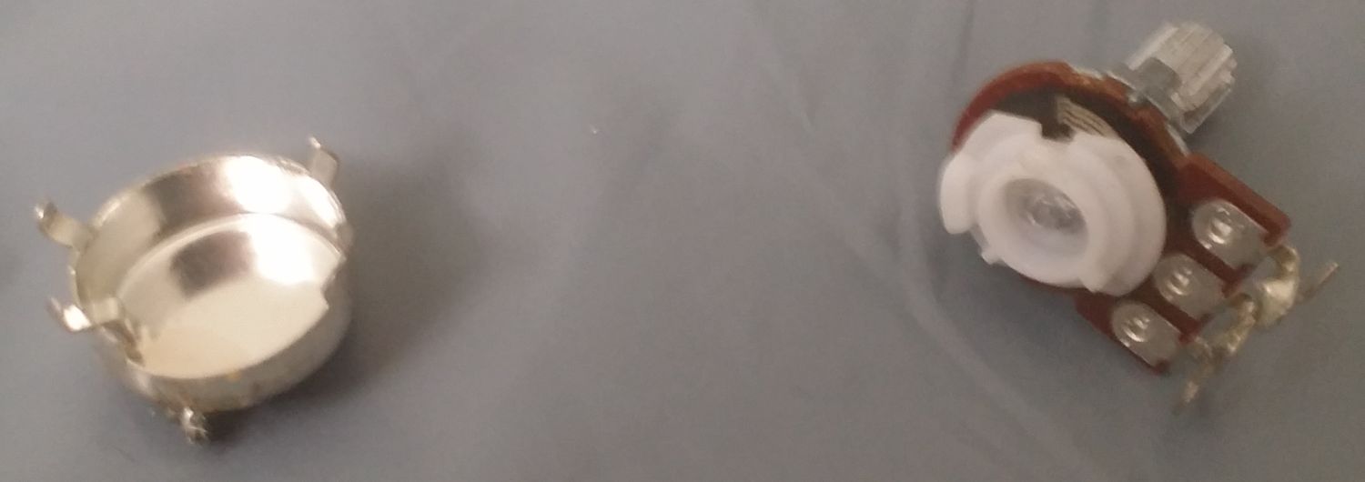

    It looked very similar to the Bourns in both construction and quality of manufacture. Like all the pots I looked at except the CTS the wiper is permanently attached to the shaft in such a way that the wafer can't be removed without destroying the pot. Passed the audio test with no scratchiness.
    There are some subtle differences in the construction as compared to the Bourns but they seem very minor. The case is slightly different as is the wiper mount, but the wiper look to be pretty much the same.
    There are a few differences in the cap. It's stamped metal with a brass fitting on the Bourns (like the CTS). It's cast metal on the Alpha (and on the no-name). That seems to be related to the hole they are designed to fit through. Bigger on the CTS and Bourns. Smaller on the Alpha and no-name. I can't see any way it makes sonic difference.

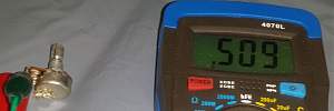

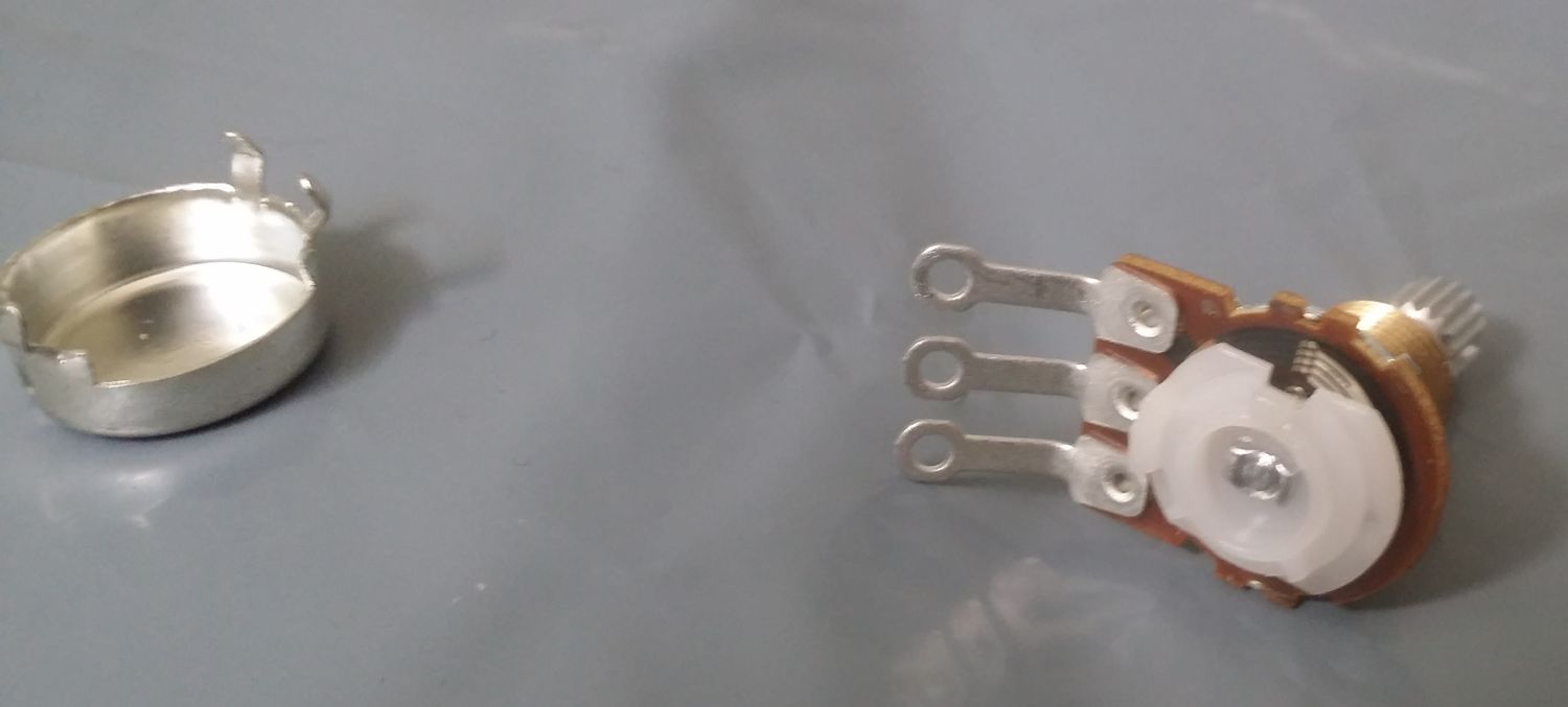

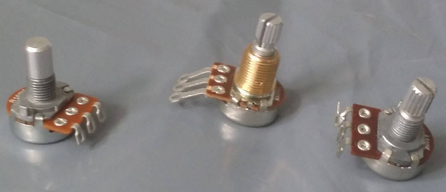

    When I pulled the no-name out of the Chinese bass that became the starting point for my Frankenjazz, I though it looked a lot like an Alpha, and assumed it was a knock off, or maybe a “generic” made by Alpha for the cheapskate market.
    What surprised me is that the case, wiper, plastic wiper wheel and the wafer had no discernible differences at all from the Bourns. The solder lugs were a bit different, and the cap was slightly different, but all the working parts looked the same.
    From any angle where you cant see the cap or the stamp on the bottom, I don't think you'd be able to tell the difference. Here's a shot from the bottom.
    As you can see, the Alphas have a dimple on the left side of the housing, Bourns and no-name on the right. (Ugly glop of solder was already on the no name when I pulled it out of the my cheap Chinese bass ;-) In fact, the pots are so similar that I could put the Bourns guts and top in the no-name housing and visa-versa. They fit like a glove. I had two more of the no names and tested all three for scatchiness. One may have had a little scratchiness. The other two seemed fine. If I were to use the no-names, I'd hit them with lubricated contact cleaner and listen to them again. Since I don't have an immediate use for them, I didn't try that, but it's worked for me in the past to clean up scratchiness as long as the actual wafer is undamaged.
    It seems that the no-names are either a virtually identical clone of the Bourns, or perhaps Bourns makes a generic for the cheapskate market. That does not mean that the quality control is as good with the no-names as with the Bourns. Part of what you pay for may be to have someone check the pot to see if it's any good when it arrives from the Chinese factory. On the other hand, the Bourns was similar enough to have interchangeable parts with the no-name, and that was a surprise to me!
