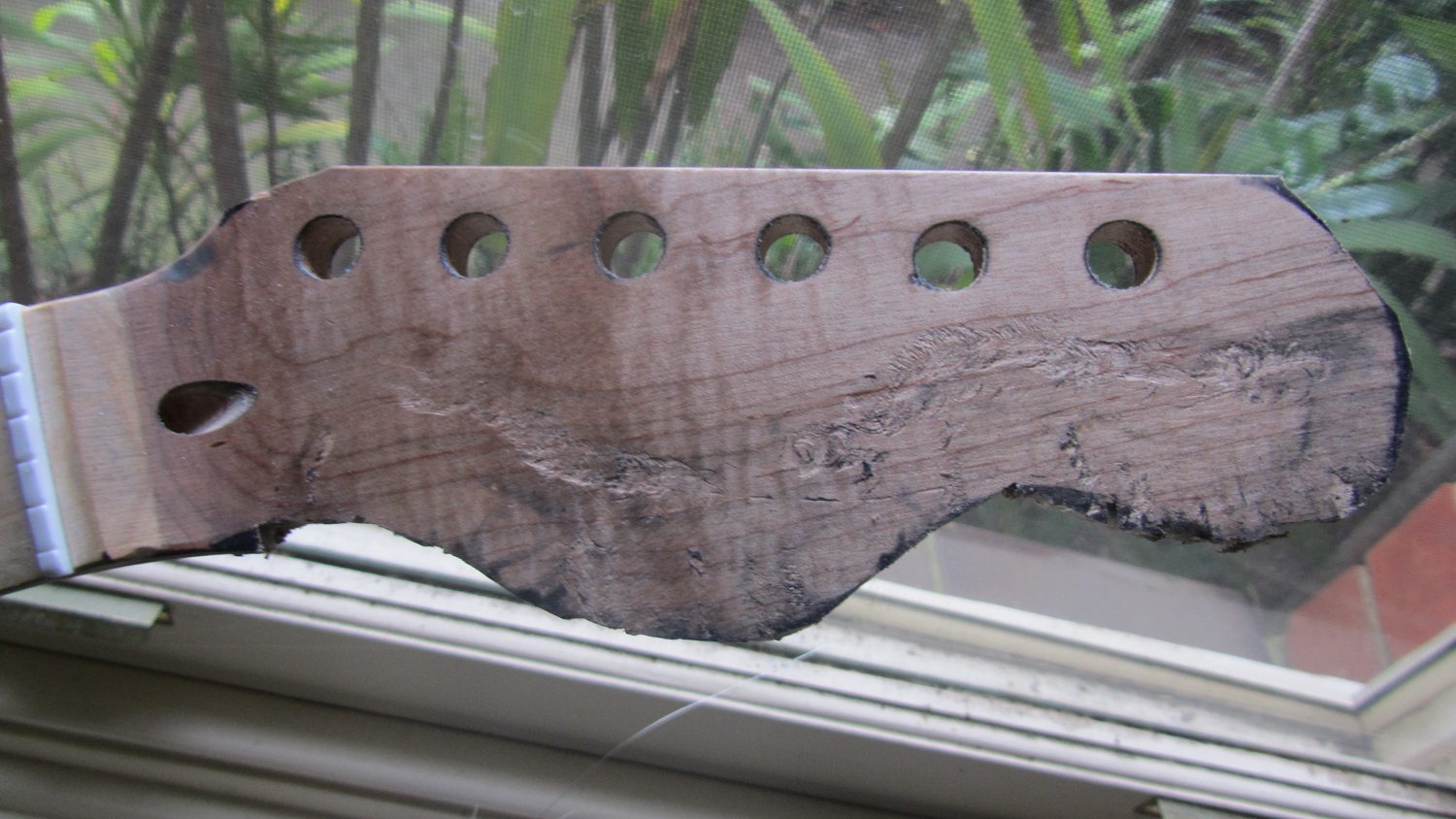

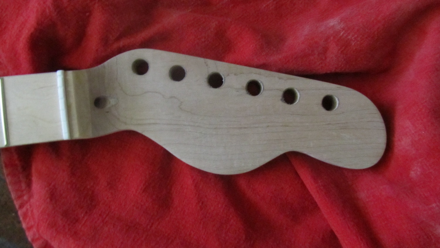

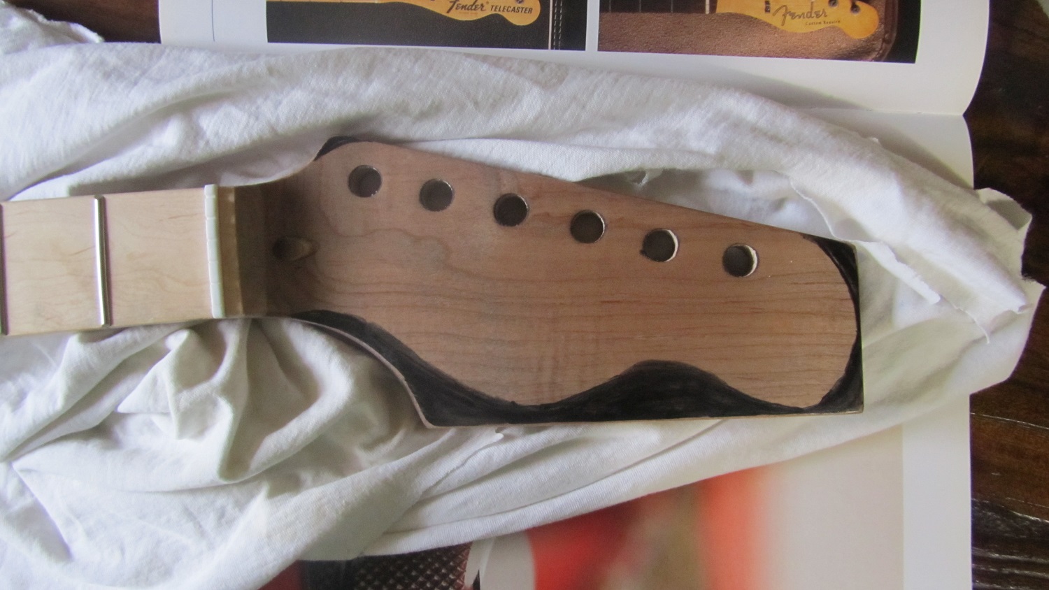

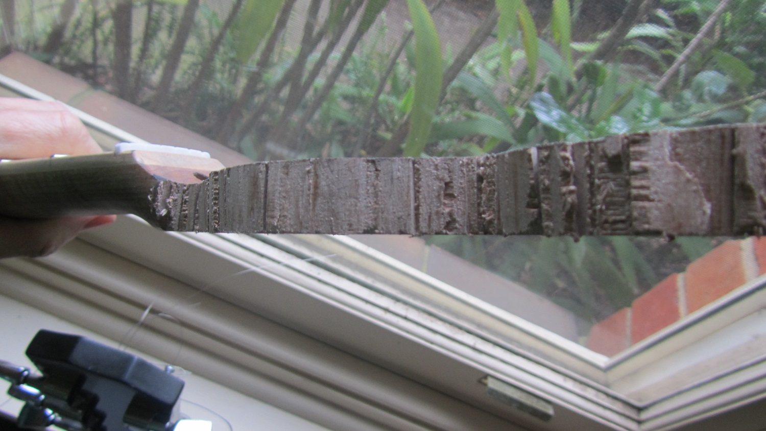

    Was posting this in my build diary, but also wanted to put it out there for the First time builder with little tools and little skills, in the Interests of those people see my attached photos. I did the template free hand cut it out with a blunt crapppy jigsaw.See Photos, the before, you go WTF!!!! This bloke should be arrested for Crimes against Timber...But look what patient sanding can do 40 grit too 120 too 240 too 800. Point is dont be afraid to make mistakes and show them.Click image for larger version.

    Nice shape there HoneyBadger, What caused the ragging on the front face of the Headstock? Was it just the action of the Jigsaw?

    Well The Jigsaw jumped around, I cut it without clamps just a knee too the throat technique. As I said want this to be warts and all showing. Sure could use more care but I am kinda deliberately being an ameutur first timer, my build on this is for the bloke, kid, father son type too learn from not so much the great builders on this forum. I know there's templates and measurements on the net but this is NOT a Tele replica, trying to break the mound so to speak.

    Looking good HoneyBadger. I've had similar experience with jigsaw. Ive settled in shaping all my headstocks with coping saw, rasps and files before a good sand
    I use a jig saw and a fine tooth thin blade made for scroll work, the big issue with those is that they flex and your cut can flare out on the other side, thats where the good old files and sand paper come in

    you've done well, one of the trickier jobs
