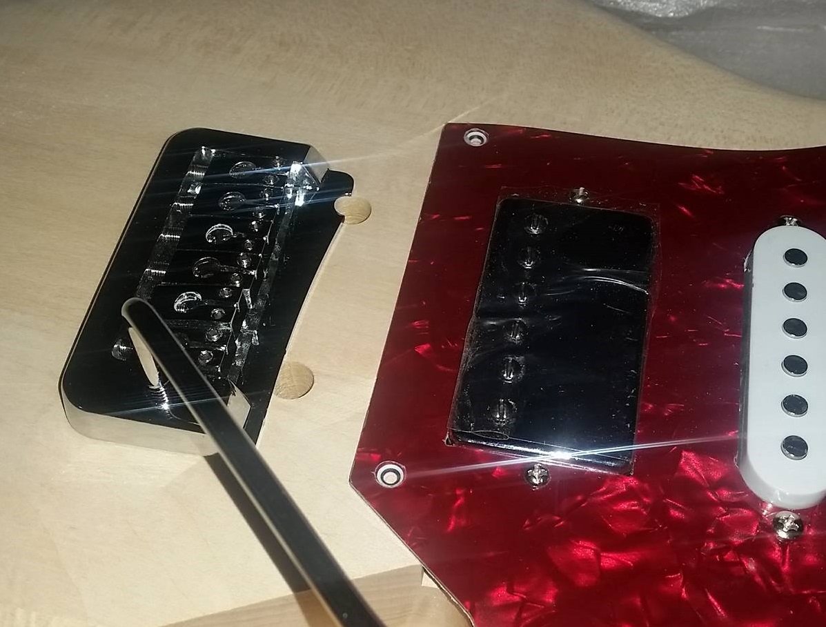

    I honestly have no idea. however the bridge doesn't seem quite right.
    3,048
    Struggling with just such an issue on a bass. Looks like another case of the drinking beginning before the end of the shift at the factory..

    Hi Gibson.Fender,
    First things first, slow down a bit. Don't rush to have everything done all at once. Building one of these kits can take months to do properly. And we all want the best results in the end for you.
    Best place to start is with this thread. There is a lot of info here, but read from start to finish before you begin. Ask any questions you have and we will do our best to sort them out.
    Your bridge looks fine, once you have the posts in it will make a bit more sense.
