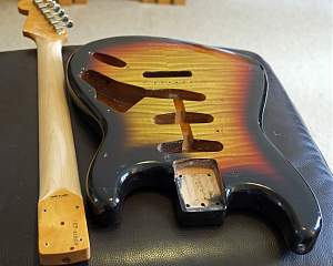

    Whilst not a FotoFlame model, it's got a FotoFlame front and back - which means the body is basswood rather than alder. I picked it up used in 2001 or 2002, when it already had most of its battle scars. But it was the nicest playing of all the Strats I tried in the shop and already had the Graphtec saddles fitted. But some of the cracks have lengthened over time - and cracking finishes has always been an issue with the FotoFlame guitars.
    I fitted a 'Traditional' Kinman pickup set (AVn62/AVn56/AVn56) to it a couple of years after that - which vastly improved the sound. Well the old pickups were the cheap and nasty ceramic pickup glued on the back types, so almost anything would have sounded better.

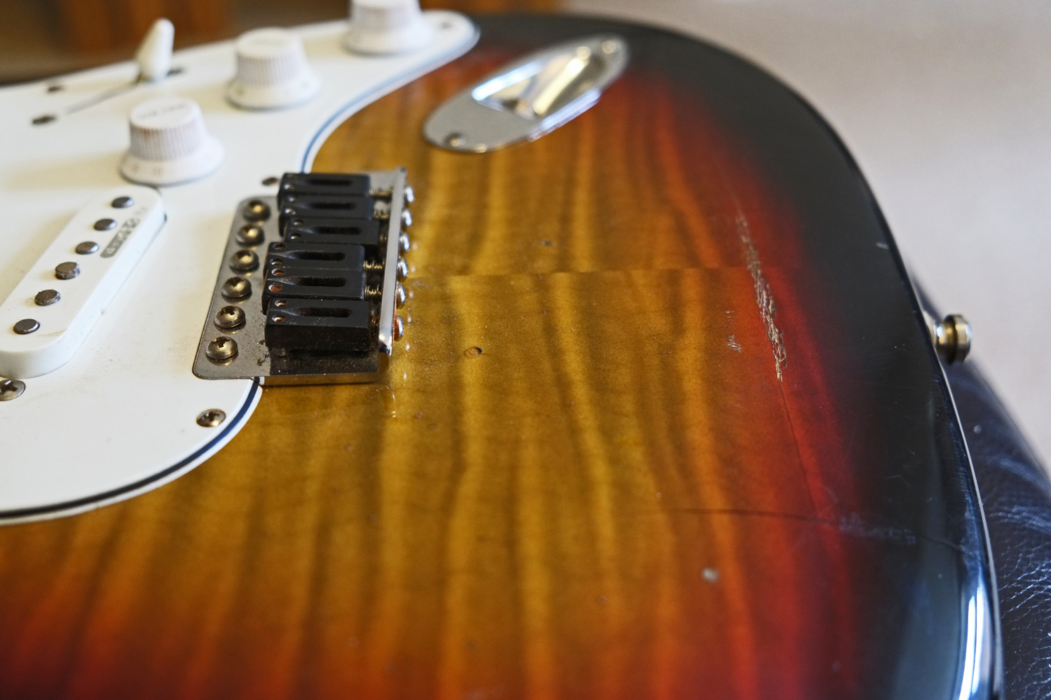

    Here I've tried to show the gouge+ extended crack damage more clearly, but it's not that easy to photograph.

    And here it is with all but the machine heads removed (which I did afterwards). As you can see, it has a nice traditional pickup rout. You may also notice the lack of finish on most of the neck. This is because I've been reprofiling it to feel more like my Dave Gilmour Strat with a soft V neck. I still need to do a little work on the neck to remove a couple of ridge lines, but it's pretty much there.

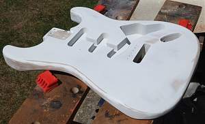

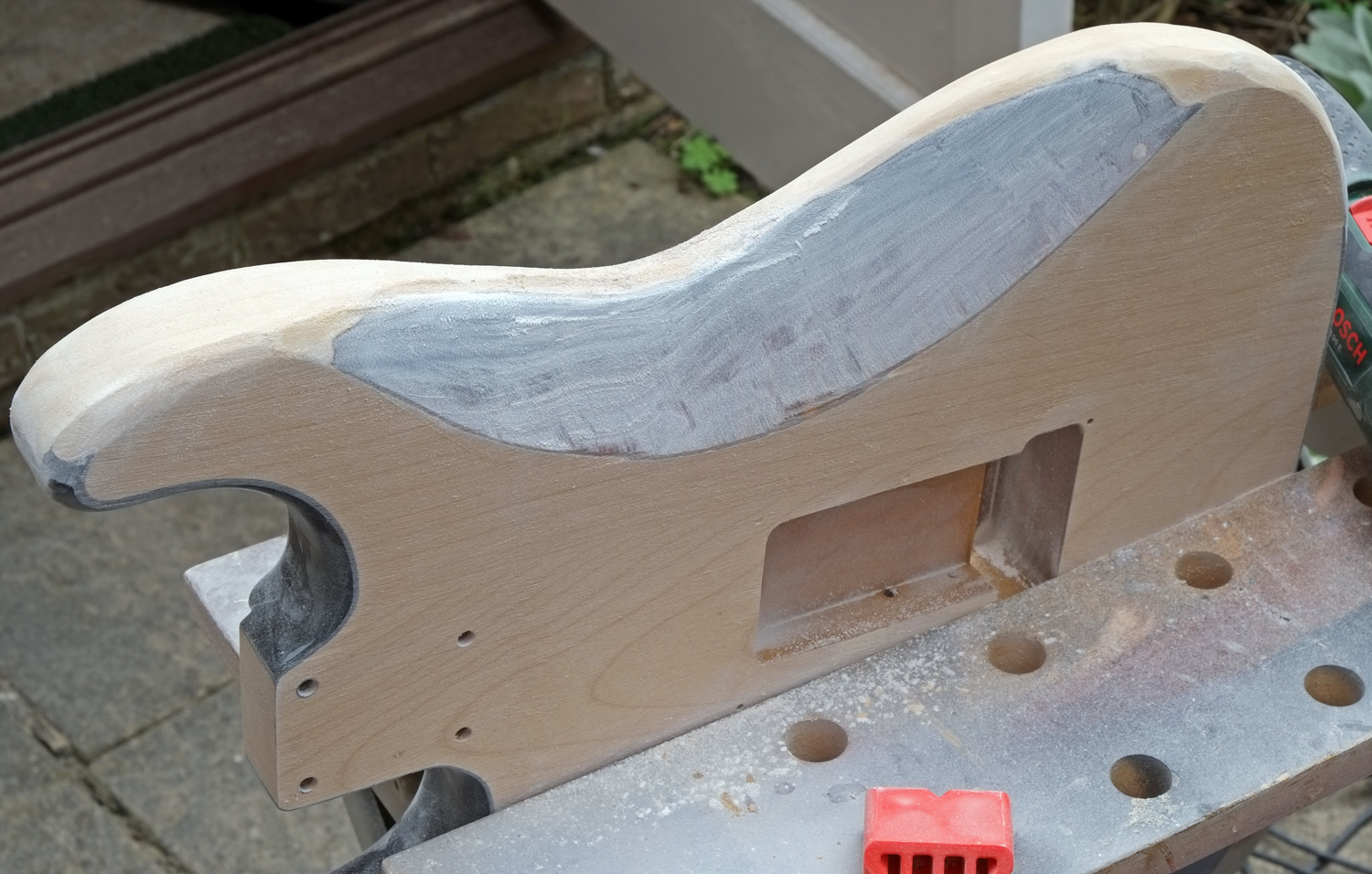

    Well, the body got it's basic strip today.
    I got to this point using my belt and detail sanders, then it all started getting rather hard. The finish in the belly cut just didn't want to come off.
Name:	halfway small.jpg

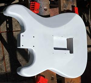

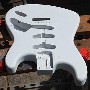

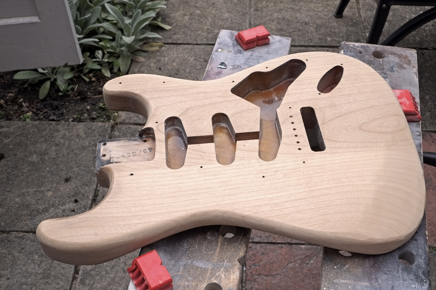

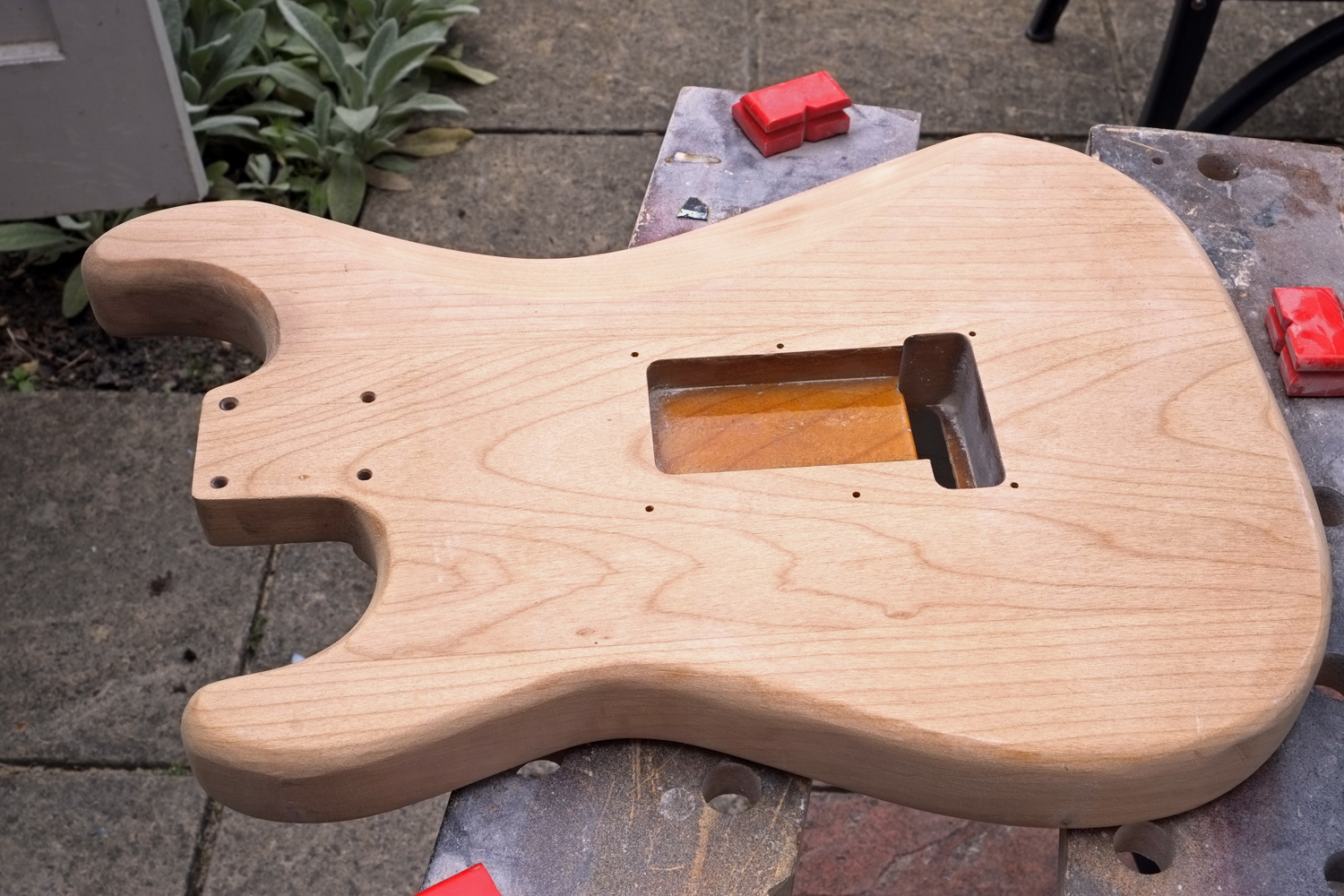

    So I thought that I'd just try the hot air gun and scraper and it worked a treat! That belly cut still caused a few issues as there was a creamy glue residue left that took a lot of effort to finally shift, but elsewhere the finish just peeled off.
    So now the body is basically all stripped and now requites full sanding to remove small dents, marks and ridges caused by the belt and detail sanders.
    The wood is quite soft, so probably basswood as the web suggests, but I think it's quite nicely figured, but not enough to make me change my mind about the colour, and go for a sunburst instead of a solid colour. Besides, the daphne blue paint's ordered and is on it's way.
