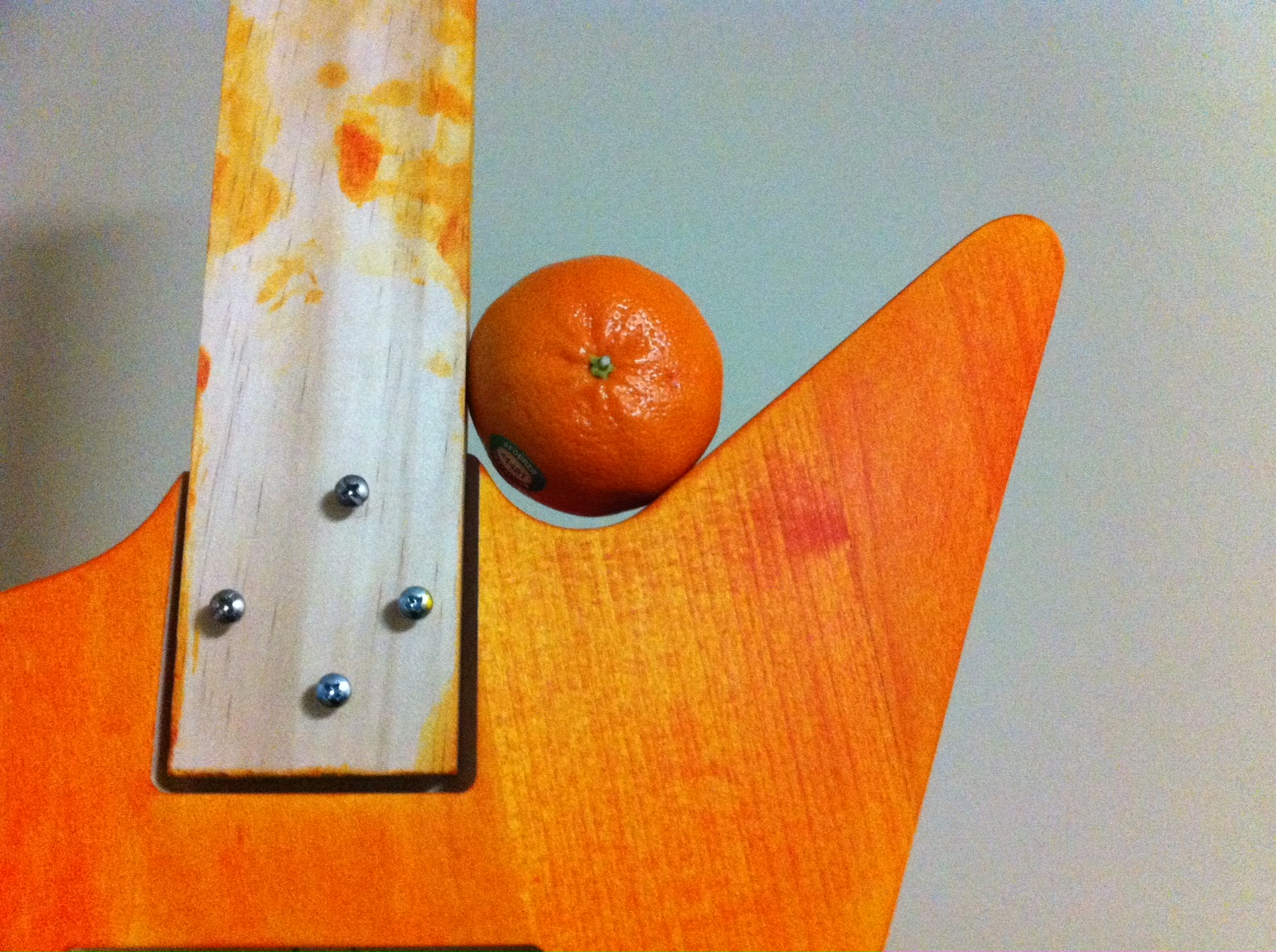

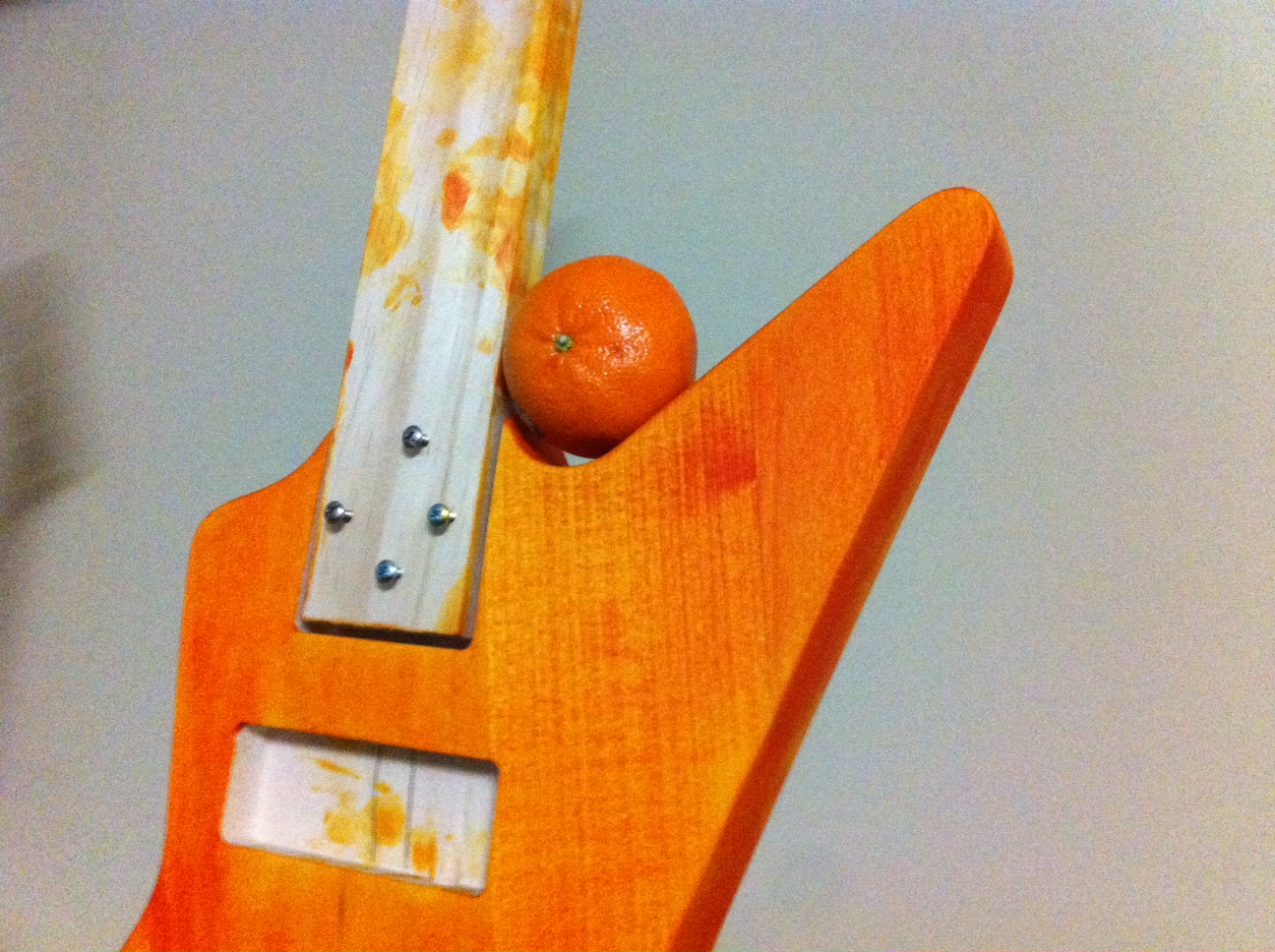

    Light Orange Dingo Tone
    Was mixing up a few brews this afternoon and came up with a light orange colour as shown below. Not exactly what I expected and was achieved by mixing 1 part Outback Sunset to 3 parts Coolangatta Gold if anyone is interested.
Name:	photo 1 (4).jpg
ID:	5458Click image for larger version.
Name:	photo 2 (4).jpg
    Moderator dingobass's Avatar
    4,491
    I love it when folk experiment
    Might look at releasing this as a new colour...
    Now all we need is an Aussie name for it.
    Hit me with suggestions folk!
