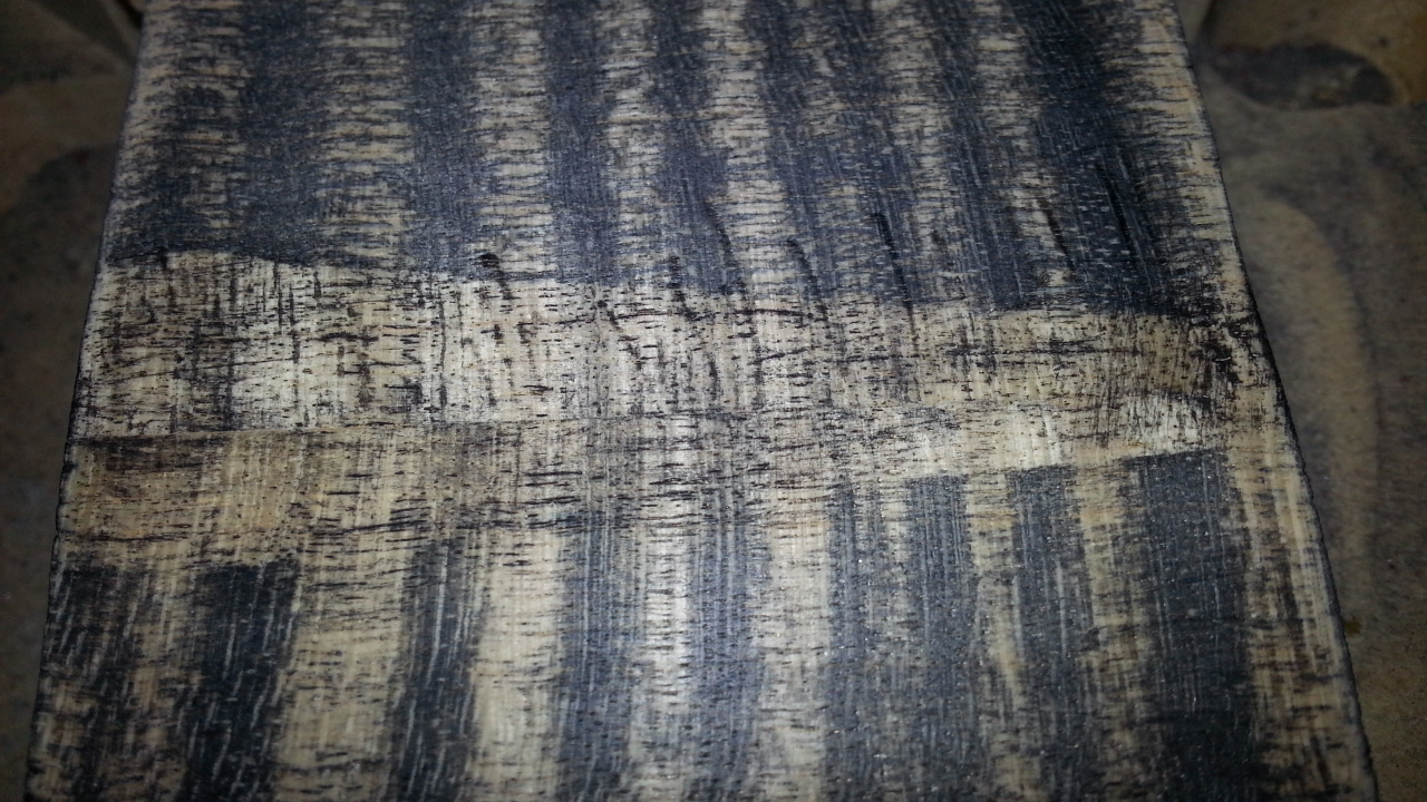

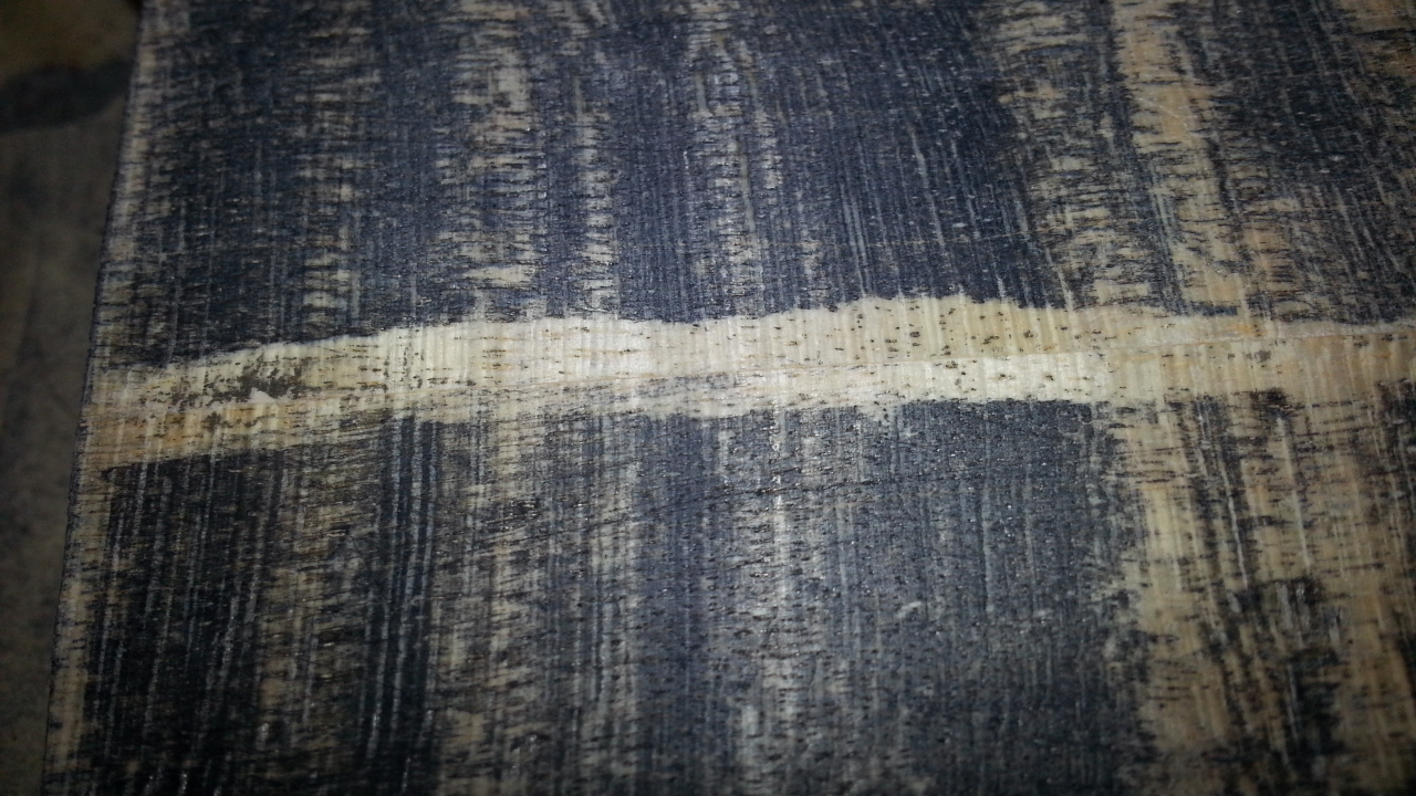

    Hi there, thanks for looking at my post.ive had a little trouble dying the flame top with ink dye.....probably not the best method but it has a very good range of colors. All went well except for the centre line. The dye didnt take. I was wondering if you could have a look at my picture of my lp-1l and let me know if you think its excess glue on the joint and if so what would be the best way to remove it? I though sanding but was worried bout sanding through the veneer....or at world touch it up with matching paint color....thanks again for your time

    Moderator dingobass's Avatar
    4,491
    Wow, thats a bit of glue you got happening there...
    One of the best tricks I have seen comes courtesy of the Gavmiester.
    Gav uses a small brass wire brush to gently scuff the area so as to give it some tooth.
    You can get these brushes from the big green shed for a few dollars.
    Thanks for your quick reply
    I though it was glue...it came like that....so do I brush go with the grain or with the maple flame....ive got those brushes......so im not actually sanding it off just creating grooves for the dye to sit in....im also trying to be cautious about going through or ripping up the veneer
    4,491
    Go with the grain.
    I will call Gav and ask him to tell you exactly how he deals with this problem
    Awsome thanks for your help.....ill keep checking for your reply really appreciate your help

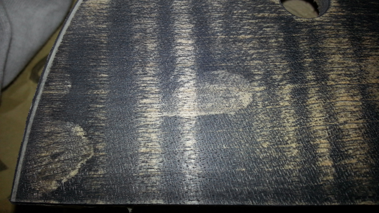

    Just added a few closeup pics

    Moderator Gavin1393's Avatar
    Mindarie, Western Australia
    3,152
    Ouch.......that is a LOT of glue.....hmmm.....
    3,152
    Take a look at this thread, it should hold some answers for you.
    http://www.buildyourownguitar.com.au...ead.php?t=1838
    WhiteRabbitz thats a nasty amount of glue. I'd carefully try and wirebrush it and try and remove some of it.
    Gavmeister whats that liquid I bought you recommended about 12 or more months ago that allowed stain to take over the glue ?
    I used it on a spalted cap with glue and it sort of worked. I got it in the workshop can check tonight
    Mentor vh2580's Avatar
    Cleveland Qld
    1,184
    Ive also found that depending on the amount of glue in a small area to use steel wool, usually o or oo and does get a bit off without having to get rough and is easy to control in a small area.( have also used old fashioned kitchen scourer wool as well if doestn come away)
