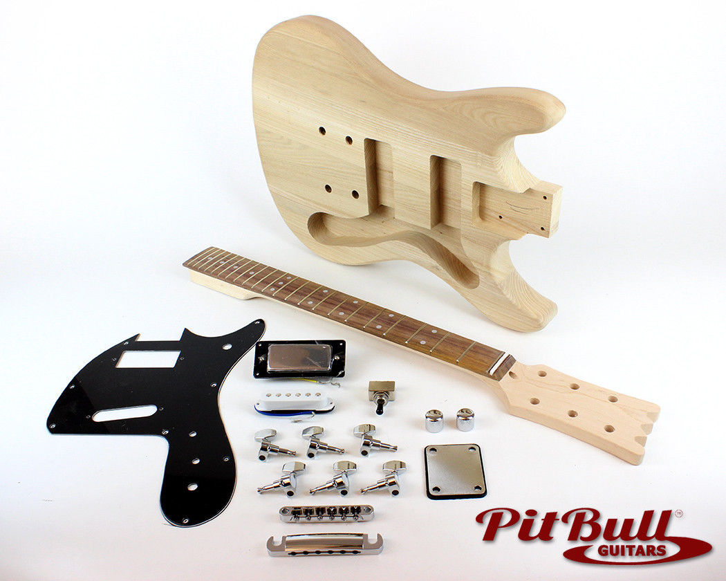

ID:	7610So my Pitbull Guitars MKA-2 kit arrived the other day. I'm building a Johnny Ramone replica. I'm going to be making some modifications to this kit. First off I was able to find a Mosrite headstock decal on Ebay that I will be using instead of the Pitbull logo. The biggest change is that I will be using a DiMarzio FS-1 pick up instead of the kit single coil. Johnny had the mini humbucker and tone pot disconnected. Johnny only used the FS-1 direct to the volume knob. I'll be doing this as well. He also had mismatched knobs on his guitar which I will be doing as well. The only thing I'm undecided about is to whether I should paint it to look new or if I should distress the finish to look road worn. What do all of you think? Click image for larger version.

    Great project dude. I put the FS-1 in mine and it sounds awesome. Will be watching your thread with inerest!
  5. Liked by: LancePhilip1
  6. #4
    welcome to the forum Lance, I prefer a new guitar look, fine if the guitar is beaten up after years of playing and gigging.
    I like your build plans. As this is an ash body best you grain fill it. You might as well connect the neck pickup, I don't see any point having the neck pup in place and not connected.
    Good luck with the build and look forward to seeing progress

    GavinTurner I took a look at your build on FB. Great job. Just curious as to what paints you used on the MK-2 build? Also did you shield the pick up cavity? Lastly is that the mini humbucker that came with the kit?

    Hey Lance, Yep I just used the mini HB that came with the kit. Like you I read that it shouldnt even be connected, so I just used the stock one as a *why not*. For paint I used Septone White Gloss Acrylic from SupercheapAuto. I definitely shielded the control cavity and the back of the scratchplate. I also used Tru-Oil on the back of the neck - love the way it feels when playing.
