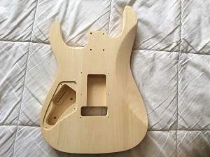

    First impressions:
    -The body and neck have been sanded relatively smooth before being packaged up and sent to Oz. I will do some of my own sanding despite some of it already being done for me. Better safe than sorry.
ID:	24498Click image for larger version.

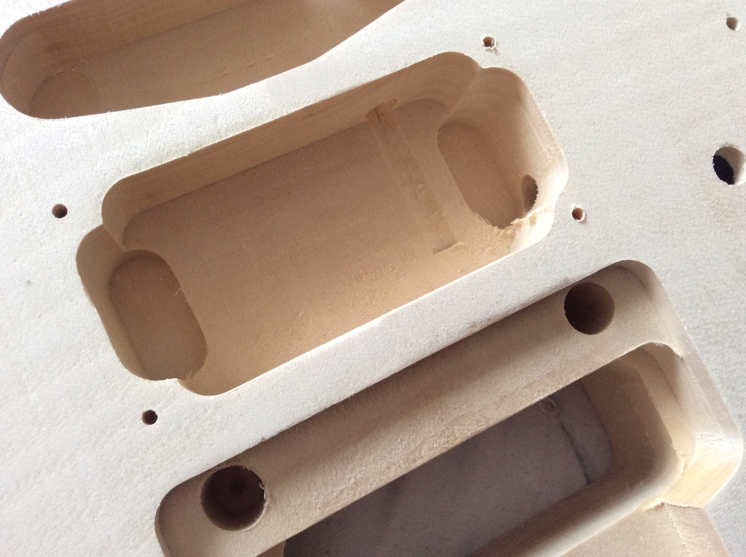

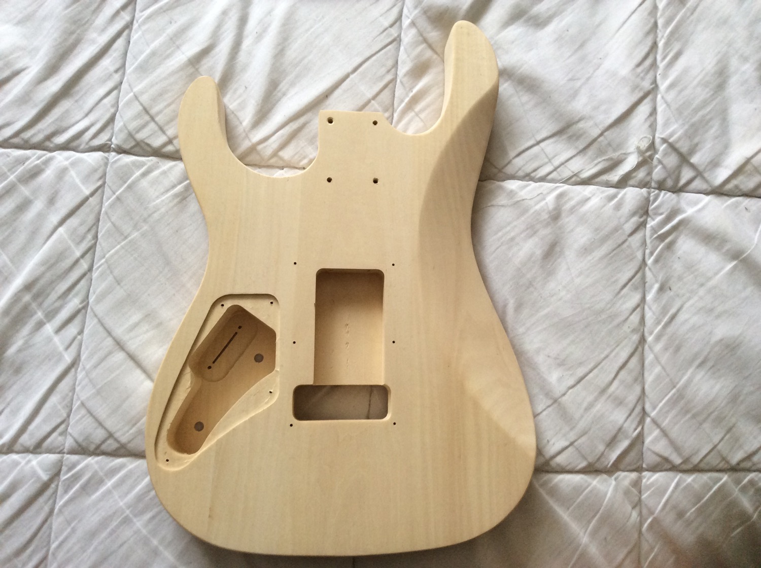

    -The routing and pre-drilled holes are really clean, no chip-out or anything like that. Light machine marks on the body but nothing too problematic.

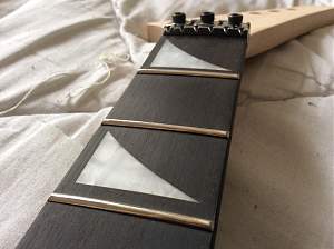

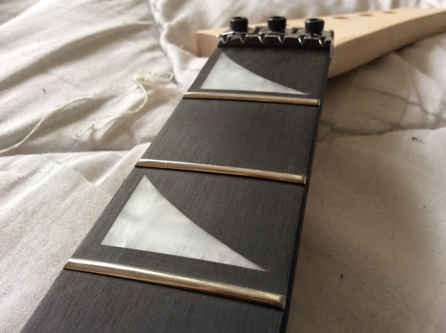

    -The inlays have little to no filler used and no dried glue all over the fretboard (usually from sloppy inlay or fret installation). The ebony fretboard is all black, no light-ish brown grain pattern anywhere.
    -The frets are nearly level. Only 3 frets are needing to be fixed. Fret ends are slightly sharp but is tolerable, definitely better overall fretwork from this new supplier.

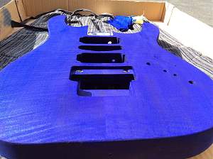

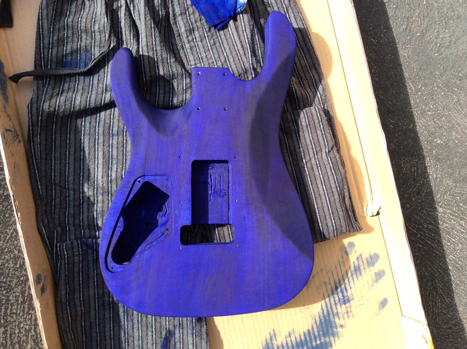

    -Dyed the body with Keda royal blue wood dye, made a few mistakes and even made the veneer lift away from the basswood but I fixed that. I put too much stain on for my liking so I'll need to sand some colour away, I was going to sand anyway since the wood has gone fuzzy from the water based stain.
    EDIT: Forgot to mention the small countour I made near the horn on the treble side, feels really comfy, was an absolute pain to get just right.
