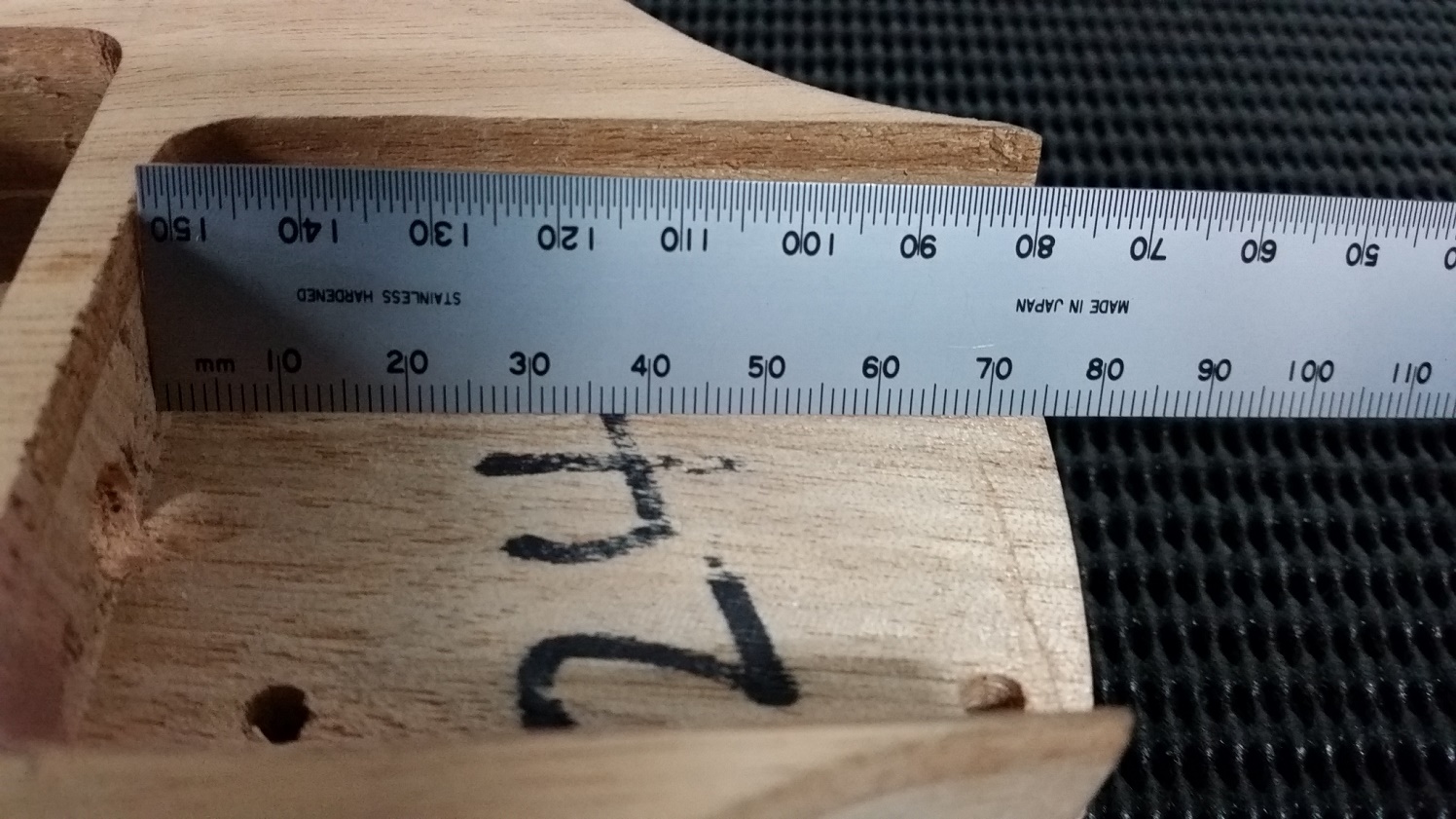

    Length of pocket 75mm
Name:	fb np 1.jpg

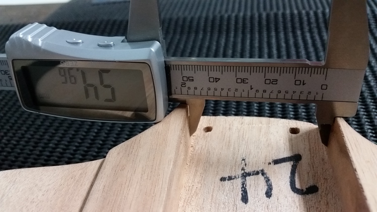

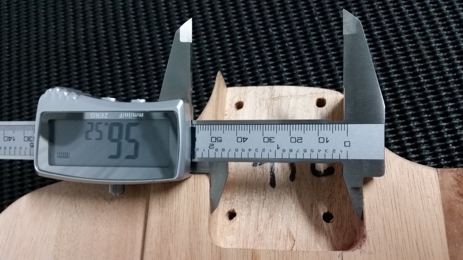

    Width at lower bolt holes 56.52mm
    Width at end of body 54.96mm
    Need to add 0.6mm as I have glued in veneer to one side to tighten up the fit, so 57.12 and 55.56mm respectively.

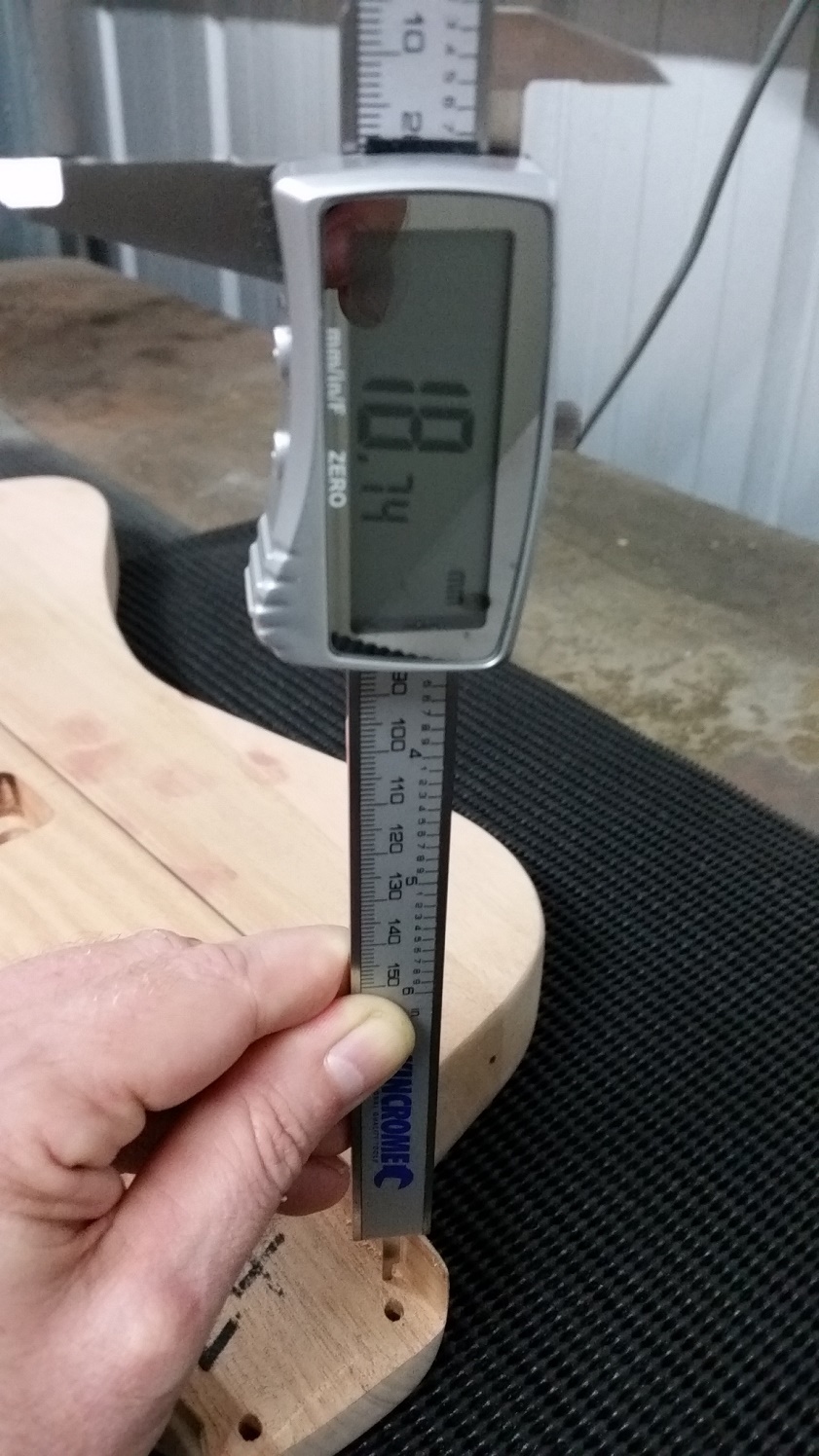

    Depth at pickup end of pocket 17.35mm
    Depth at end of body 18.74mm

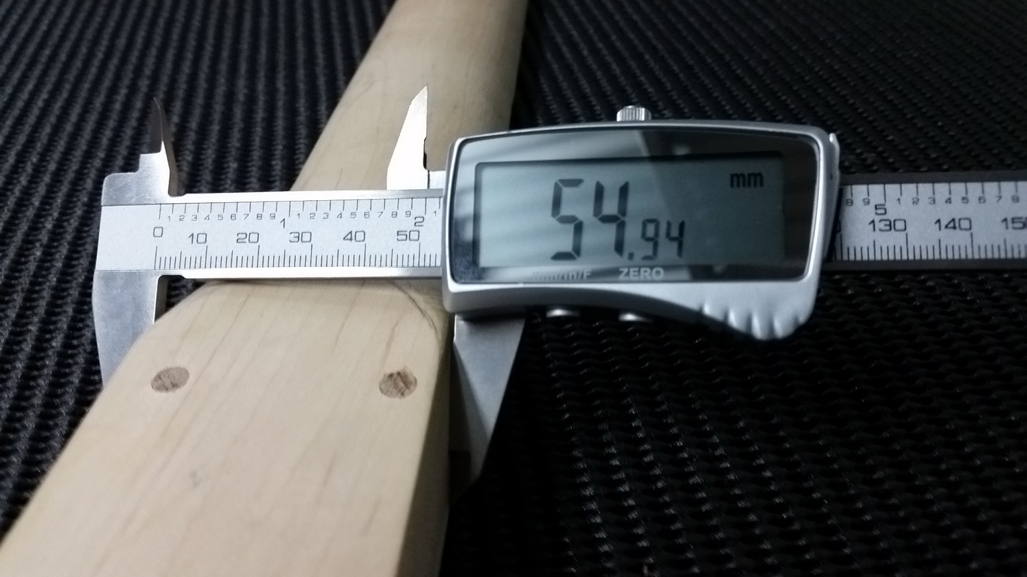

    And the neck heel itself.
    Width at end of heel 56.62mm
    Width across upper bolt holes 54.94mm
Name:	fb nh 1.jpg

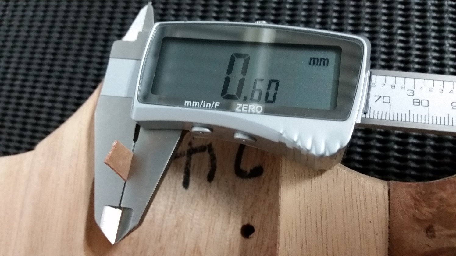

    And the veneer itself 0.6mm as used in the pocket.
Name:	fb veneer.jpg
