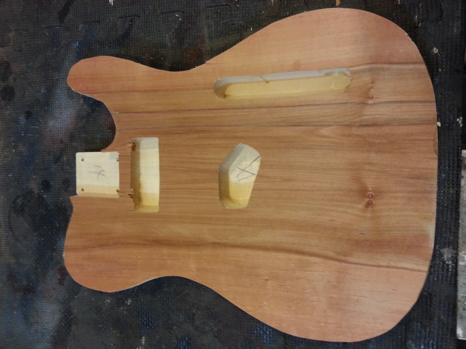

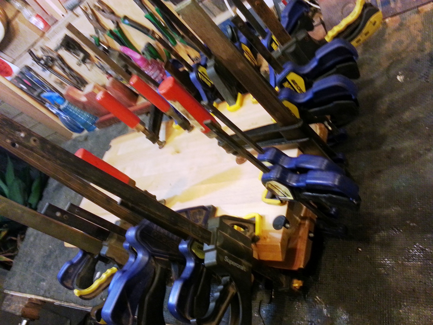

    Started this new build Wednesday and its progressed well. Had a veneer I got from the wood show last year, not even sure what sort of timber it is but like the look of it.
    Glued the veneer with kwik grip and used every clamp I could find.
    Removed the clamps Thursday and trimmed off the excess and cavity holes

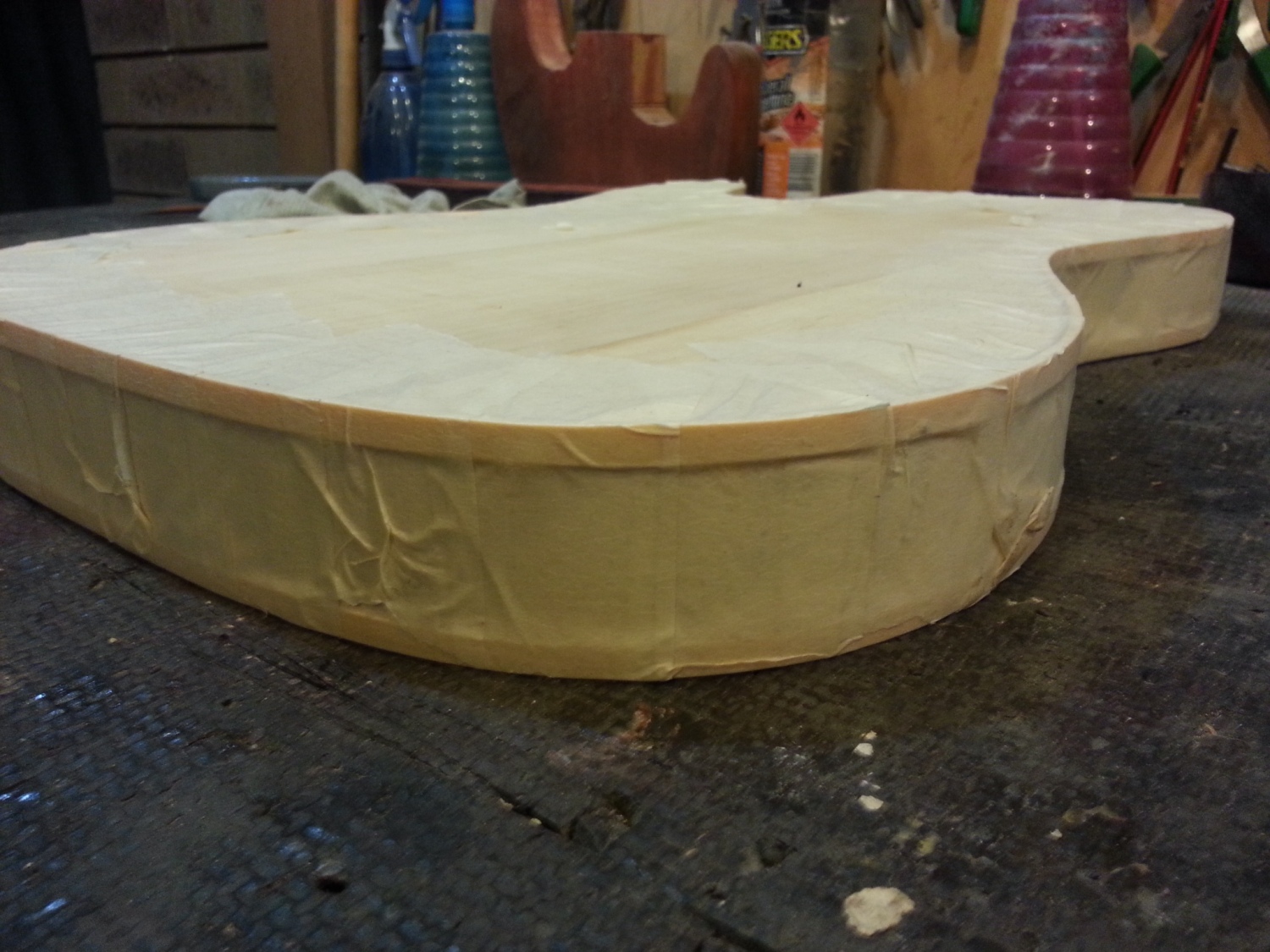

    So Friday took the body to DB's man cave and his mini table router setup for binding cut the double binding channels. On the way back to my man cave I needed some Tarzan grip glue so hence the photos of us outside the Big Green Shed !
    Saturday shaped and glued the binding and taped it up.

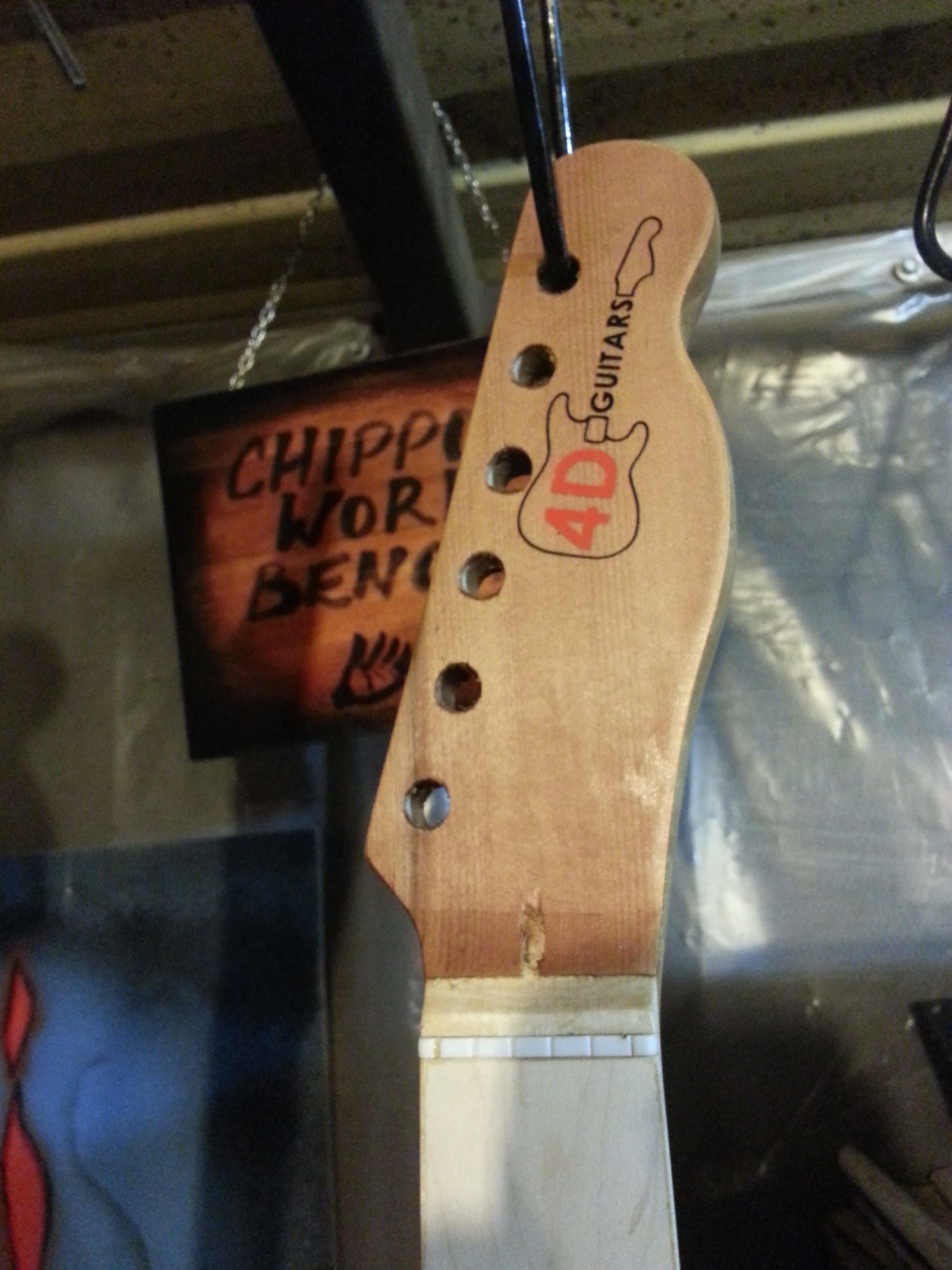

    Also glued the same veneer to the headstock and shaped that and got a logo on

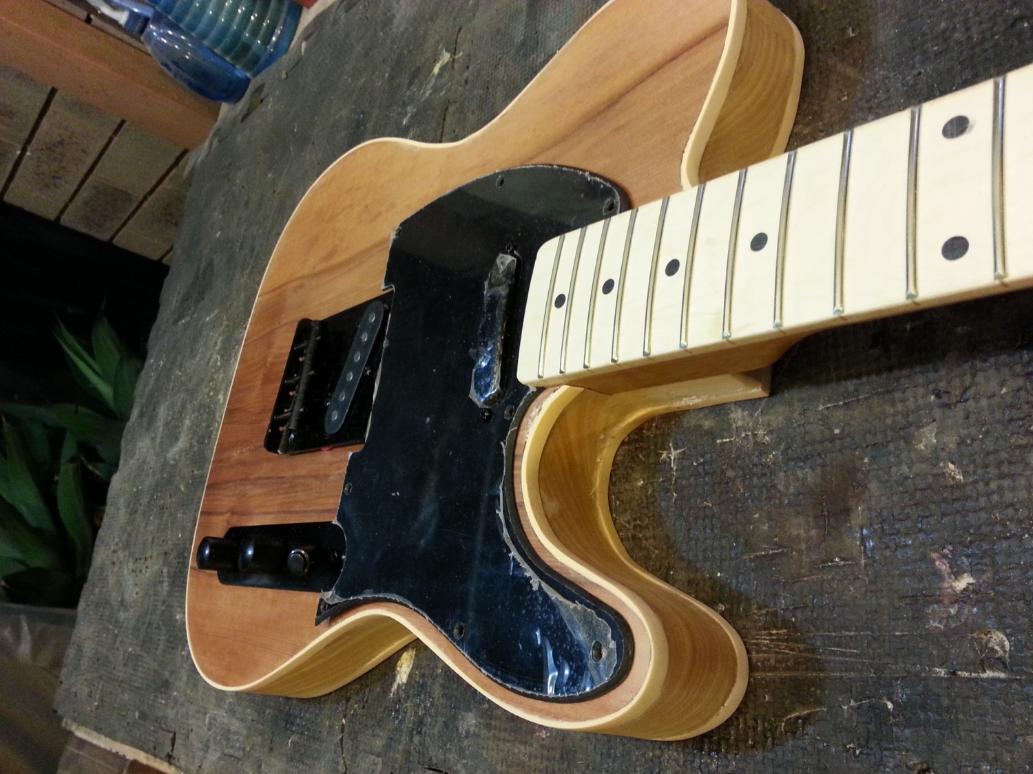

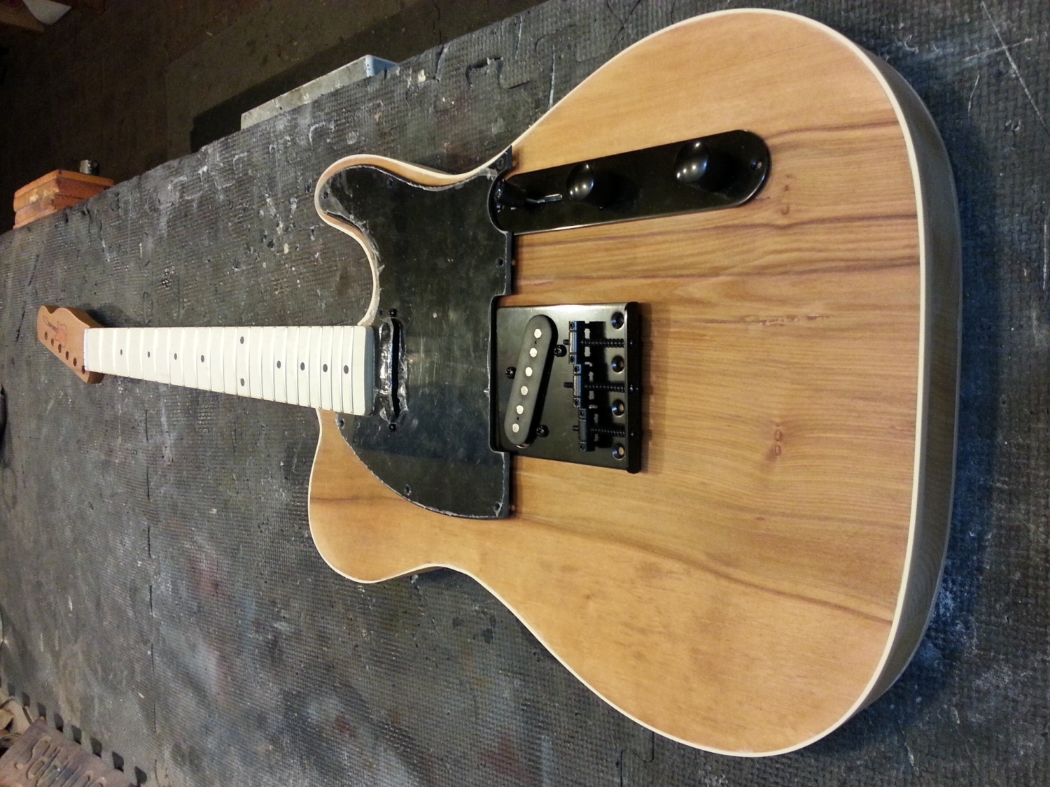

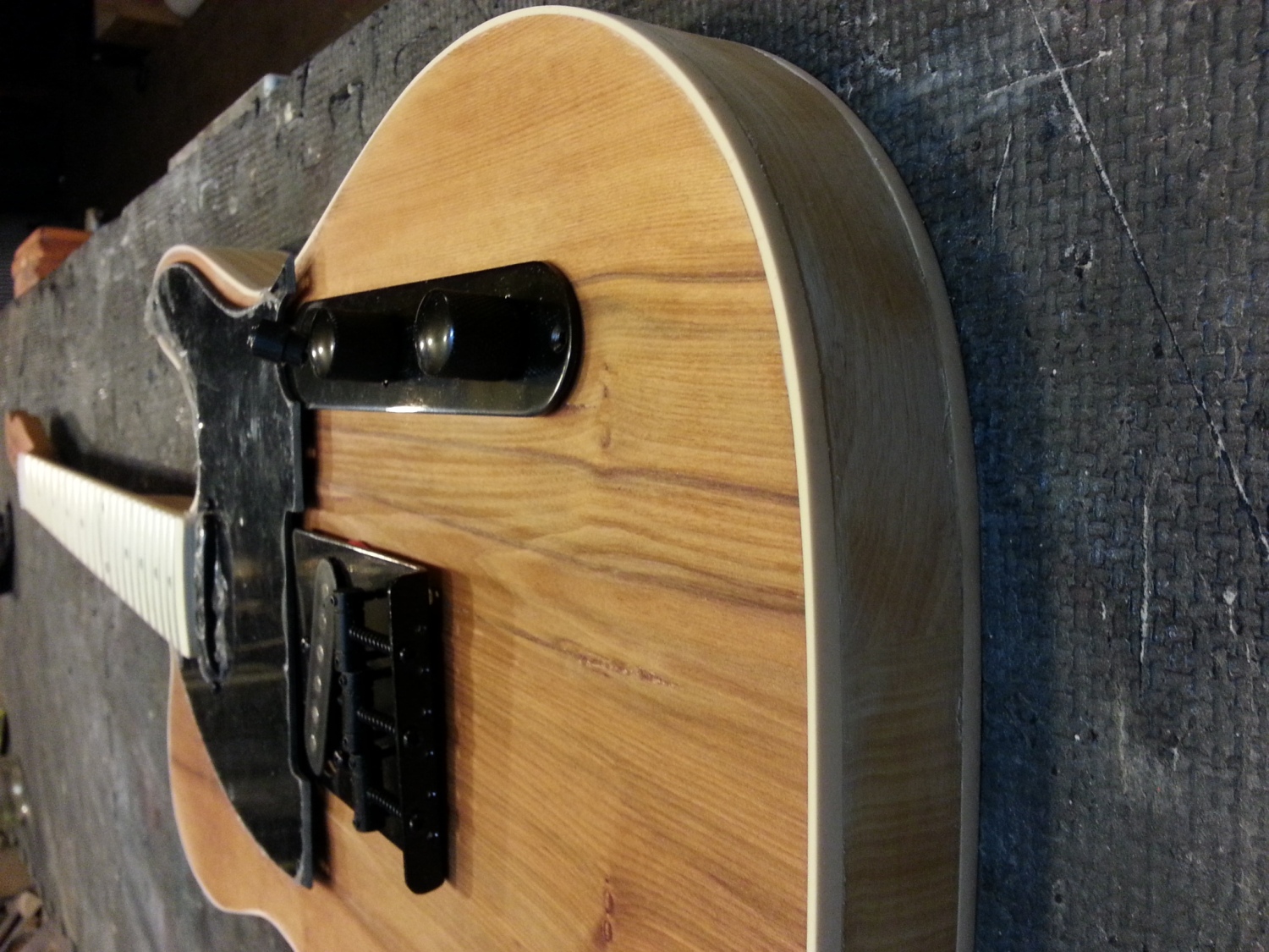

    removed the binding tape lastnight after 24 hours and did a mock build. Still need to sand the binding flush.
    Plan is to clear the cap and sides and back will be an old baltic stain

    Man, this looks stunning already!
    Looking awesome Wokka! Love the veneer and that binding almost makes it look like you're working with a solid piece of timber rather than a veneer.
