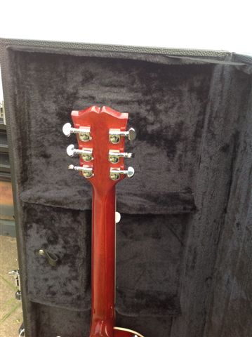

    Jun 2016
    Melbourne , Vic
    9
    Hi all , thank god it's Friday .
    Any way ,just a quick update on the LP-1M .
    I forgot to mention that I have done some mods from standard so to update .
    The first can be seen from the pic of the back . I removed a fair amount from
    the back of the neck near the pocket and radiused it to look more like a real Gibson.
    There was too much in the way trying to get right up the neck !
    The other was to use some really old Japanese paper and oil caps instead of the
    polyester (greencaps) ones that were supplied with the kit . Everyone seems to think
    paper and oil sounds better and they were left overs from when I built my 12 watt amp
    so why not .
    I will change the pots for decent ones with a switch for coil splitting in the future
    It's now had the nut reset , the Ernie Ball strings fitted , a quick twang and rough setup
    with very promising results . Haven't plugged it in yet but thats next so will update further .
    Cheers
    Andy ( Ampman )
