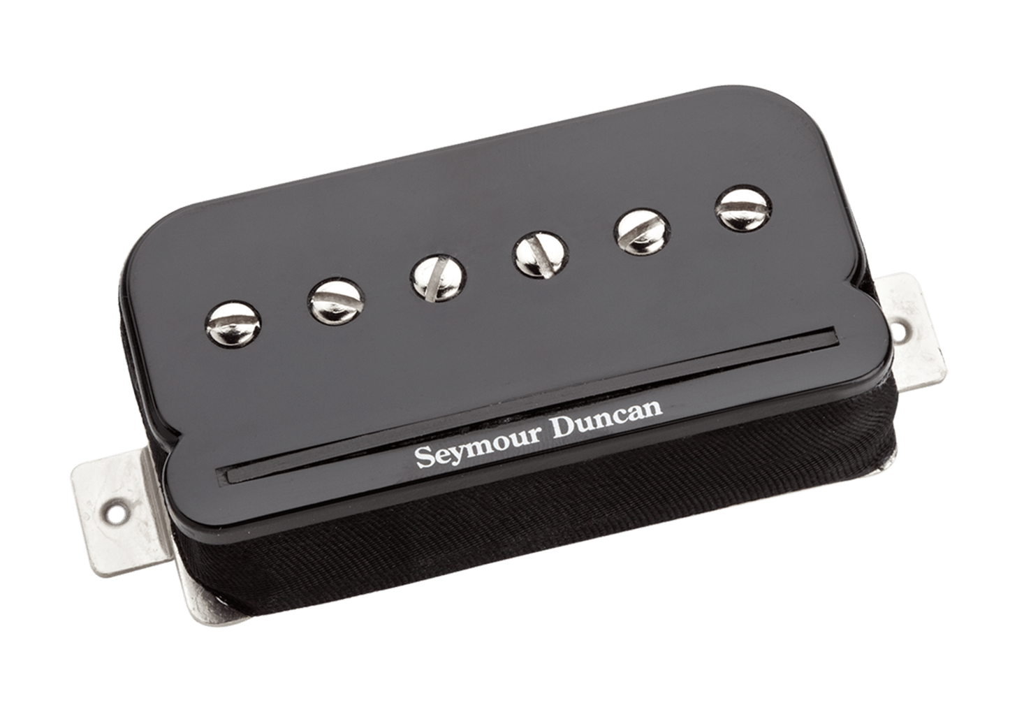

    Which leads me on to probably the most versatile - if not cheap - option. I have got a Seymour Duncan P-Rails neck pickup fitted to an Ibanez RG. This is a P90 coupled with a rail single coil in one pickup.

    So with the right switching, you can get full humbucker, P90 and a single coil sound from it. SD do a matching pickup ring with a couple of small switches to allow you to select the various options without otherwise affecting the wiring of your guitar. This makes it easy to remove and replace the original pickup if you ever want to sell the guitar on but keep the P-rails - but again, the switched ring isn't cheap. However it does give you a very versatile guitar.
    Two push/pulls will give a P-Rail all 4 options too: series humbucker, parallel humbucker, P90, or Rail.
    It will, but it's a bit more wiring and not that much cheaper to do. But if you then put the original pickup back, you could re-use the push-pull switches for coil taps or series/parallel wiring on the original pickups. All depends on your level of soldering and wiring confidence.
