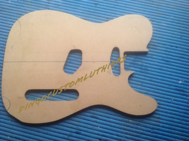

    All you need tool wise is a router and pattern cutting bits (1/4" and 1/2"), jigsaw, a few rasps and files and away ya go!
    First, make a template. This template will have the outside shape and pup/ control cavity shapes cut into it.
    MDF work well for templates. When you have it cut out and refined the shapes, seal all the cut out edges with thin super glue or shellac. Dont use waterbased sealers as this will cause the MDF to swell.
    Always rout neck pocket and all cavities before cutting the body from the blank.
    This gives you some wriggle room to adjust the placement if needed.
    It is good practice to have a trial run on some cheap timber
    Moderator dingobass's Avatar
    4,491
    My Tele style template..

    cut it out with a jigsaw first and give yourself a few mm all around. Then put the template on top and route away. Leaving tooo much timber makes it hard going for your router
