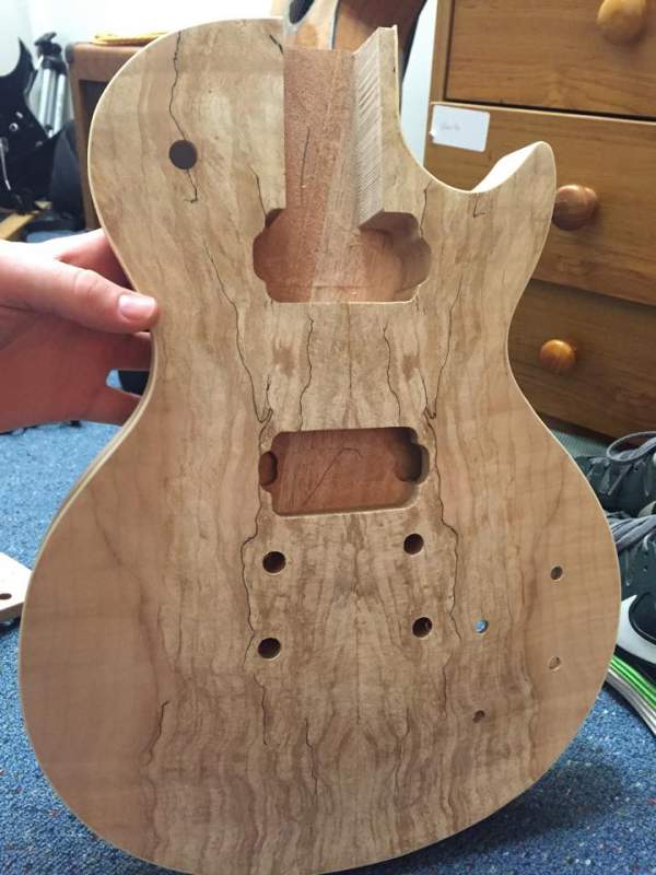

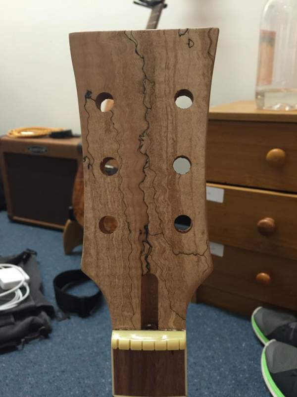

    Ordered the kit a few weeks back and am stoked with the spalted cap! So keen to get into it. The plan is to go over it with Coolangatta Gold. Was hoping I could get some advice on maybe putting an undercoat of Ebony Timbermate and sanding back, as I'd read a few other guys have done on here. I'd be a bit weary about it as I can now see how thin the cap is and would hate to ruin that beautiful spalt.

    Hi Luke welcome to the forum, what a beautiful kit you scored. Love the plans you have. I'd apply the ebony timbermate these spalt caps aren't very flat in their natural state. Don't do any pre-sanding on the cap, apply the timbermate and you should be ok.
    Coolangatta gold and black hardware will look very nice.
    Take your time and you will end up with a great guitar !

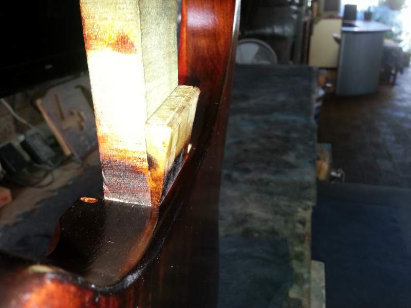

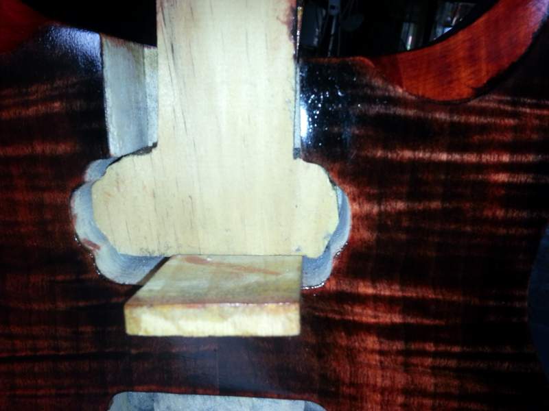

    Might pay to make a hanger for the body get some cheap pine as wide as the neck pickup and roughly cut the shape. Use two wedge shaped pieces of wood to keep it in place.
    In terms of curing DB recommends about 3 days in summer so might need about 5 days curing in cooler weather.
    If you can leave it indoors to cure it should cure faster. The Dingotone has a lovely natural smell to it and doesn't contain any dangerous chemicals.
    Attached are some close ups of a set neck (glued) neck hanger and wedges to hold it in place

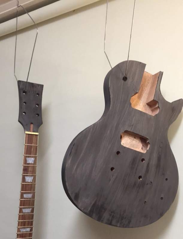

    Thanks so much for that advice wokka! It worked an absolute charm! Spent the weekend working on the timbermate undercoat, sanding back and applying the stain. Turned out better than I ever thought! I think I may have sanded slightly too much, I would have liked a bit more darkness in the grain, however I love how it's brought out the flame maple on the sides as well as the spalt in the middle, amazing! I'll be leaving it a solid week before I start the intensifying coat, hopefully sometime on Sunday. The only warm place in the house that I've been able to hang it is in my room and I've found the smell to be really nice actually! Beautiful citrus smell. Makes me glad knowing there's not a whole load of chemicals etc in the dingotone. (The images don't seem to be uploading, I'll try another post)

    thats come up really nicely Luke, well done. You didn't bother cutting a headstock shape ? The G types are the easiest to shape with only the top of the headstock to shape. It will really personalise the build.
    Also the binding and neck binding you will need to steel wool the stain off.
