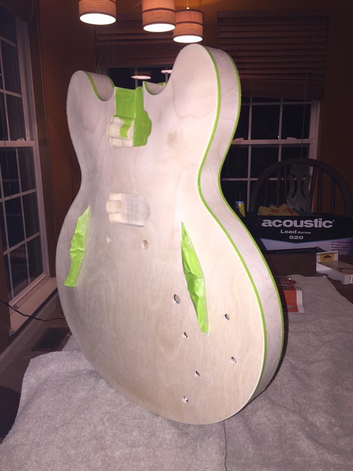

    The kit arrived the other day, a total of five days to get here to Ohio from Australia. I was shocked when it showed up, I thought for sure it would take 4-6 weeks.
    Here is Stage 1, sanded down to 2000 grit, masked off and ready for the first coat of primer.
