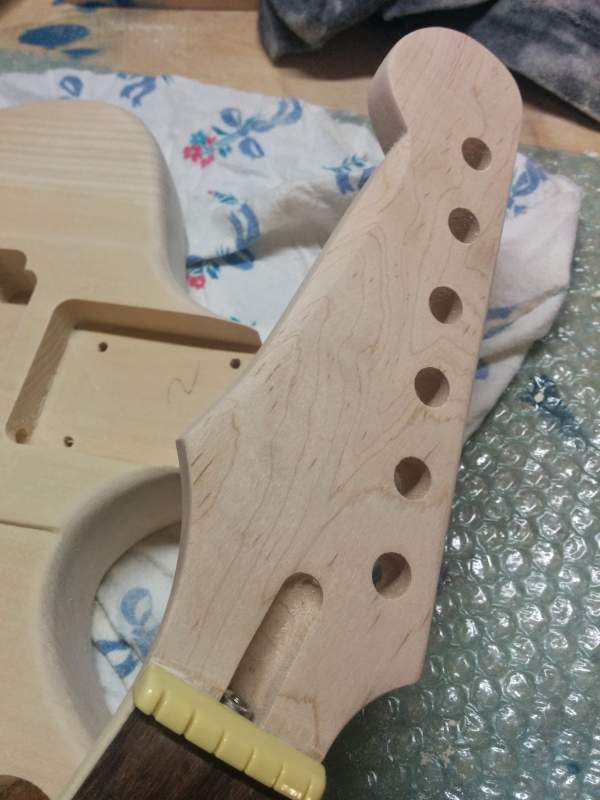

    So I've managed to shape my headstock, maybe not as tidy as I would like and pretty standard but I wanted to keep it in the Firebird style:
    So now I'm just doing sanding, sanding and more sanding
    Great job - the headstock looks awesome. Personally I would take the nut off and level up the nut ledge before painting the headstock (personal preference). For a solid colour, I think all your products look great. The primer is perfect, and the septone will work well with the acrylic clear. I have used the super cheap colour before and it was great (my son's BC-1) but I didn't use white knight acrylic on that. You might just want to do a quick compatibility test between the dupli-colour and the White knight, but I reckon they will be fine. Sounds like a great colour scheme you have planned and am waiting with interest to see it come together!
    The headstock looks great.
    Thanks for your help mate, as always your advice is appreciated. Not sure about taking the nut off, sounds like a bit of a mission!? I'll definitely check the White Knight with the dupli-color...that blue is very nice, exactly what I was after so hopefully they will work together.
